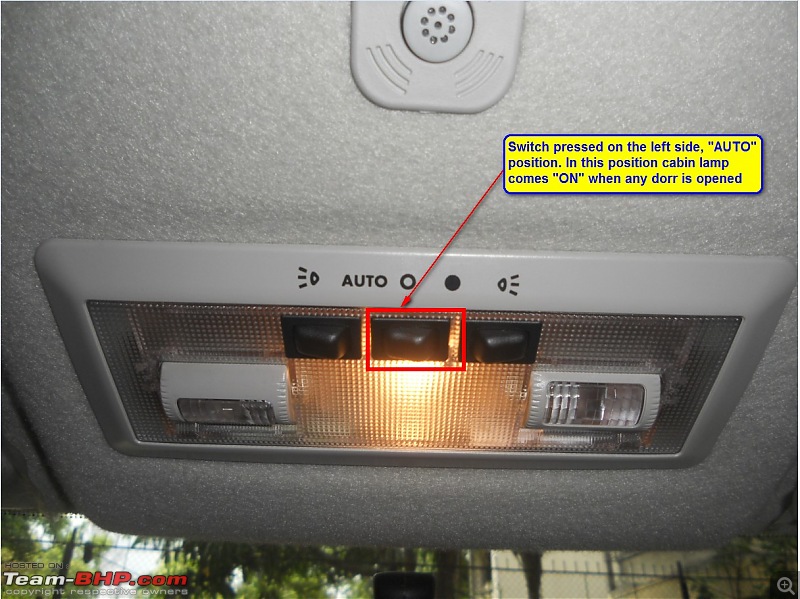

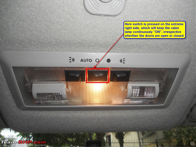

Guys noob question:
1. When I open the door, the cabin light does not turn on. The demo guy who came home said that is how it is. I have my doubts.
Is this behaviour observed only while opening the drivers door or any of the door?!
Generally the cabin light is either two stage operation with ON/OFF or it is a the stage without ON/DOOR/OFF.
If you have kept the switch on the DOOR portion, it should light up when any of the doors are opened. If it doesn't there is an issue with the connections in the light or may be switches on each door need to be checked.
Guys noob question:
I couldn't stop laughing on reading this comment. Either the demo guy is really naive or was trying to fool you.
Anurag is spot on regarding the three positions of the lamp. I thought better explain you this with pictures, so picked up my point and shoot and prepared the below explanation.
Three positions of central cabin lamp
1. AUTO
2. OFF
3. ON
Mahindra TUV300 : Official Review-cabin-lamp-3-positions.jpg
"OFF" position. Here the cabin lamp won't lit up, irrespective whether the doors are open or closed. It will always remain switched off. Most probably your cabin lamp would be in this position.
Mahindra TUV300 : Official Review-cabin-lamp-off-positions.jpg
Switch pressed on the left side, "AUTO" position. In this position cabin lamp comes "ON" when any door is opened. When all the doors are closed it dims and shuts off Mahindra TUV300 : Official Review-cabin-lamp-auto-positions.jpg
This is the "ON" position. Here switch is pressed on the extreme right side, which will keep the cabin lamp continuously "ON", irrespective whether the doors are open or closed
Mahindra TUV300 : Official Review-cabin-lamp-positions.jpg

Thanks so much Deepak. That was helpful! I checked based on this and there seems to be some issue with the connections. So much for PDI and my fault also that I didn't pay attention to this. Anyway not a big thing. Will get it fixed.

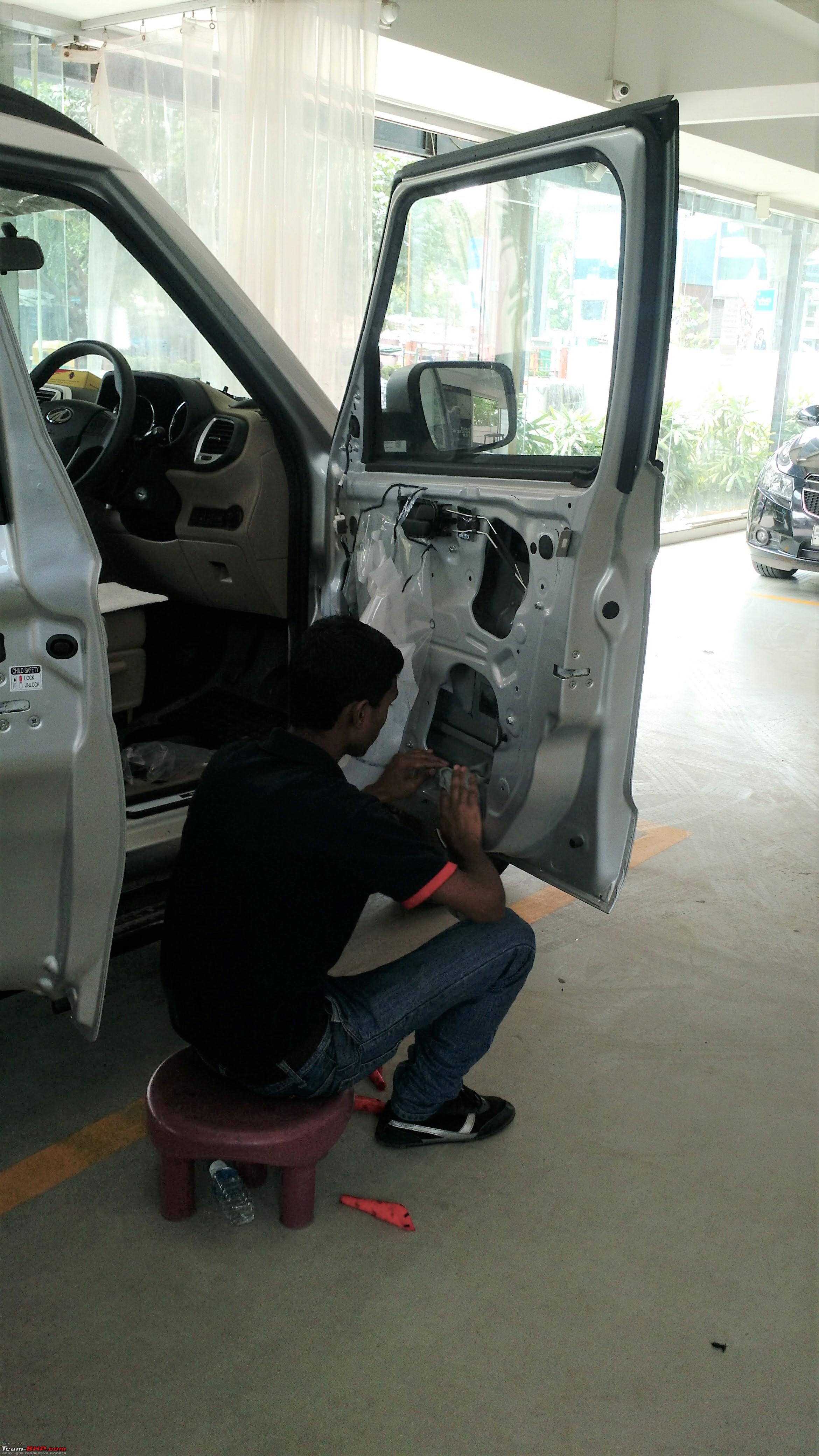

Took some out and took QuickSilver for some 3M pampering and sound proofing. Got the 3M sound deadening material installed on the four doors. There was a rattle from right side front and rear window also, which got fixed in the process. Also, it gathered a lot of dust and mud in the rains. Got it cleaned and polished.
When the door pad was opened up, saw how flimsy the plastic covering was, thin enough that it would tear with some fingernail pressure. Pathetic quality. Some pics.
The effect of sound deadening was good, the same audio system sounds better and cuts out a lot of external noise. The cabin now is a much better place to be.

I just got them to add 3M sound proofing material on four doors, left the boot door. This cost about 5k. Apart from that got them to clean, wax (UV protection) the exterior and vacuum clean the interiors. The cleaning cost about 1600. They have an annual maintenance package for TUV which is about 22k, but I think one can bargain and bring it down. My brother took annual maintenance package last year for 20k for his Lodgy and I think it does help. His car remains scratch free, not even minors one. What they give in this package is 2 times machine polishing, 2 normal wash and wax, interior cleaning and shampooing the upholstery and few goodies. Don't remember the exact details. I think if you are willing to workout yourself, this package may not be required. But a lot of people do opt for it as it does take some amount of time.
