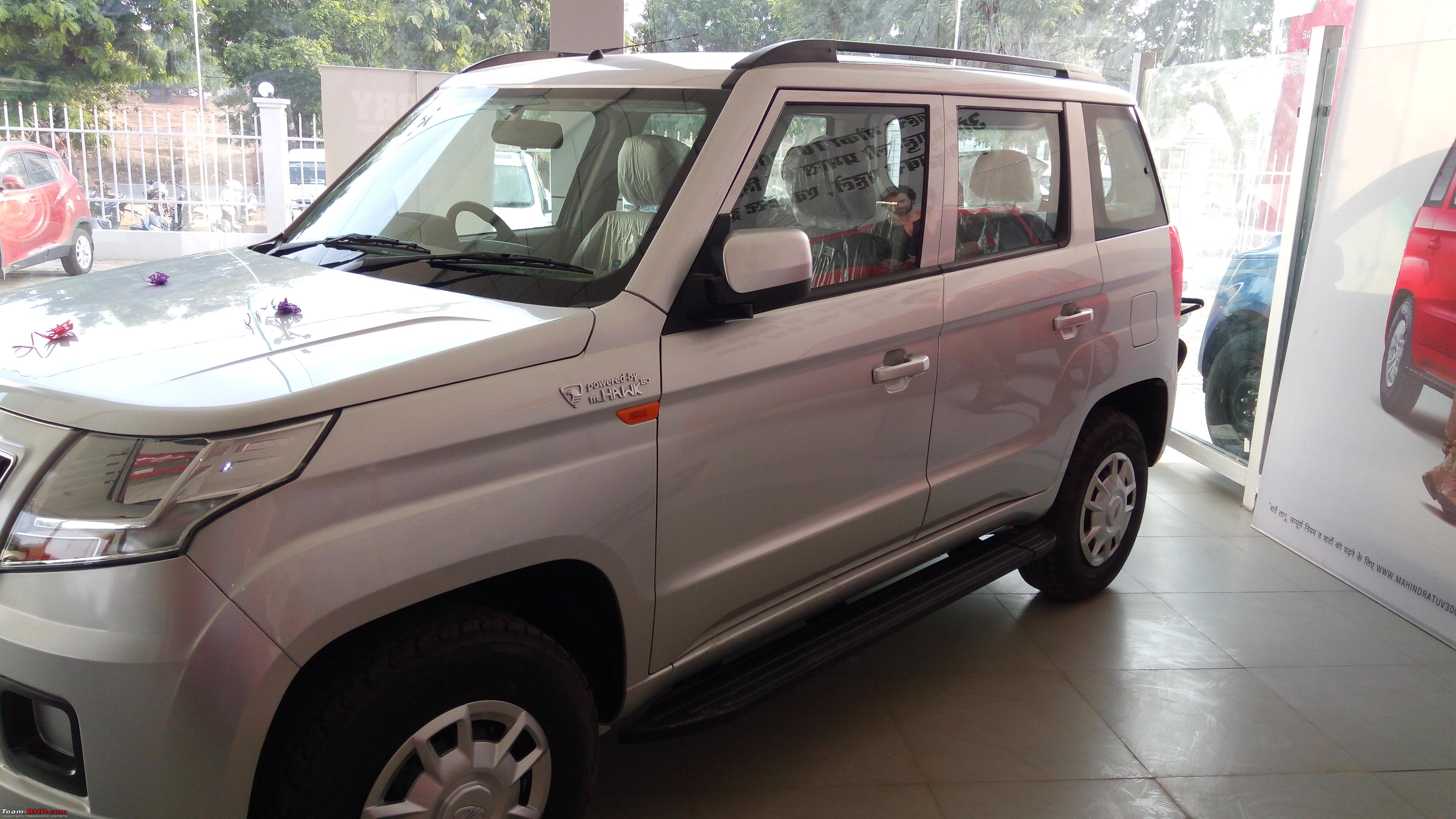

The Tank Bug finally got me too.
I bought the 'TUV 300 T6+ - Silver' on 15/06/2017 after a great deal of thoughts.
I am posting here few pics of my 'TUV 300 T6+ - Silver'. Will post my observations and experiences in a few days.
