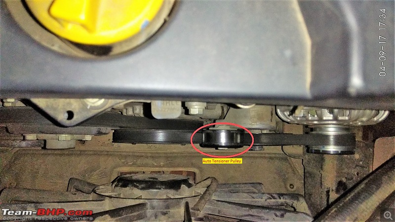

My tank had an issue today. The belt connecting alternator and power steering pulleys was removed. I noticed just while taking out the tank from parking. It may be because of a cat entered engine bay to take shelter during heavy rain. Initially did not realize it, but got a hint from a fellow tank owner. I have seen a cat near my parking in the morning and later minutely observed the NVH cover and found cat’s footprints. About one year back I had found a pigeon body on the NVH cover kept by a cat.
First called Mahindra Road Side Assistance, but they could not show up in 3 hours. Then called Customer Care Manager, Bengaluru and he asked India Garage to send technicians to home. They fixed the belt in just 2 minutes. Belt was found good after inspection, so the same belt was used. Good thing is that I will be able to do it myself if required, but bad thing is that I lost half day in the process.
To fix it, first put the belt on 3 pulleys which are grooved (V cut side). Then lift the auto tensioner pulley with a number 15 wrench (pull it upwards slightly), slide the smoother side of the belt below it. You are done!
If this belt is removed, alternator can't generate power or charge battery and power steering will not work. I drove about 1 km with a very hard steering. The technicians told me that if it happens in a remote place, switch off AC, fan and music system, that is preserve battery and drive to a service centre or spare parts dealer. But I understand at night it will be difficult as lights will consume the battery quickly. I don't think the belt will displace while driving, as auto tensioner will keep it in place. Unless there is an external disturbance, it should not come out from the pulleys.
Part they got for replacement but not used:
Mahindra TUV300 : Official Review-img_20170904_172110.jpg
Auto tensioner pulley:
Mahindra TUV300 : Official Review-apb.jpg
