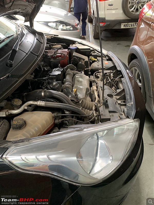

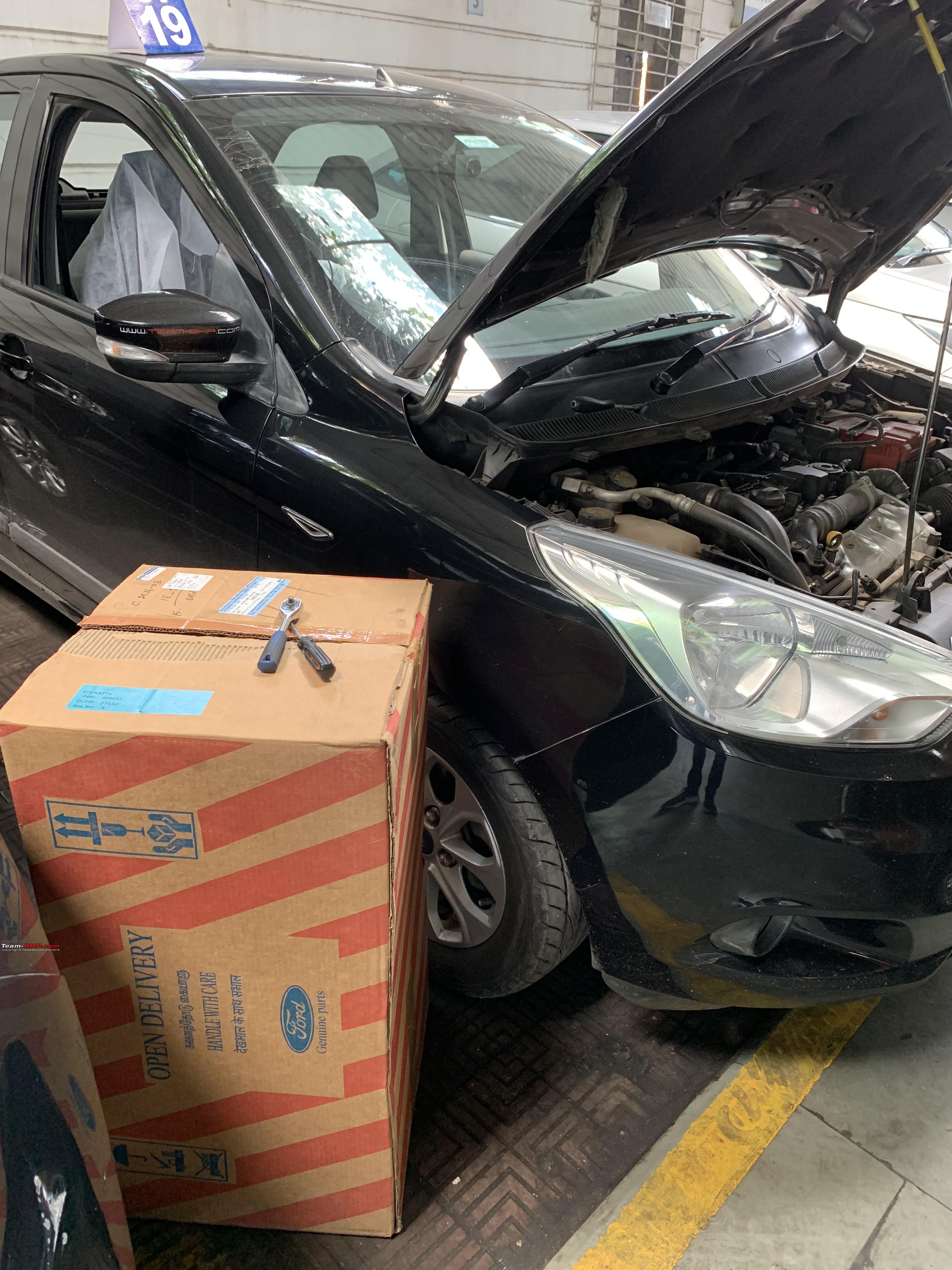

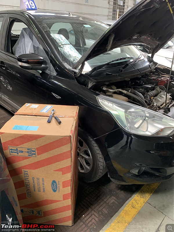

Update! Have successfully changed the headlamp assembly. Installed the figo S variant one’s. Super easy job, no hassle at all. With a lot of help from bhpian ABHI_1512. Here are the pics.
