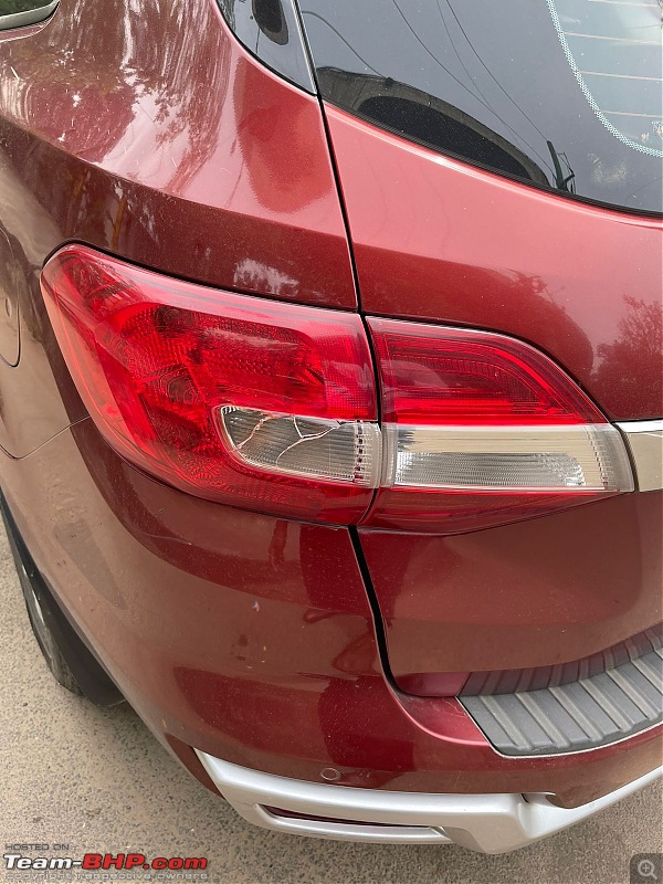

Dear Bhpians,
I accidentally cracked the tail lamp cover on my Endeavour last weekend. To my utter surprise, the service centre is quoting a 10k to replace it. Apparently, tail lamps come only as an assembly, and the outer cover alone cannot be changed. And the part needs to be ordered in advance too.
I am unable to find any after-market supplies either. Any suggestions in finding the tail lamp over - without changing the whole assembly would help.
Cheers.
