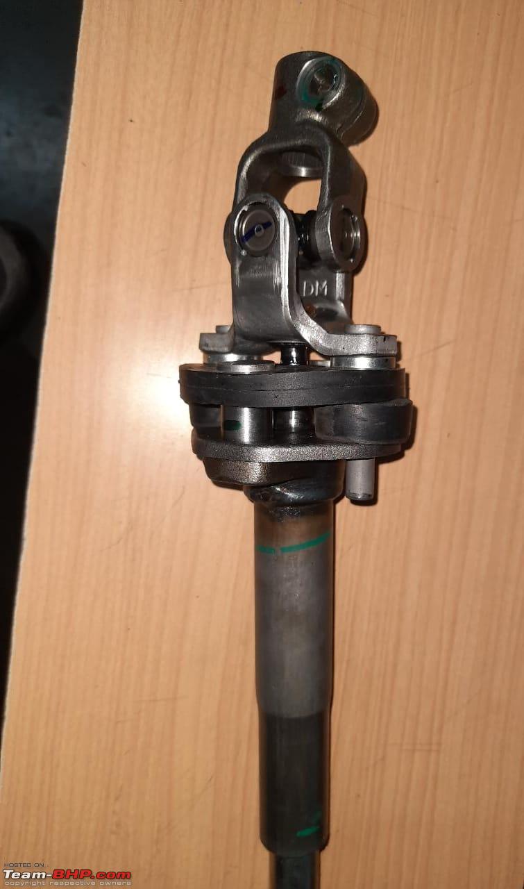

Originally Posted by humyum View Post
Hi, just so that I am clear, its only the steering column and not the assembly they would replace right? Adding the Boodmo link just for reference.
https://boodmo.com/catalog/part-45250_0k100-39663757/
This one right? So nothing of the wheel alignment etc should change right?
Toyota Innova Crysta : Official Review-whatsapp-image-20221110-10.52.54-am.jpeg
This is what was replaced. The small rubber thingy round one you see was added to arrest the play, but didnt work. Hope this helps. Root Cause was excessive play. The WA will be done as per process, so check it out with the folks at your Workshop TASS.
