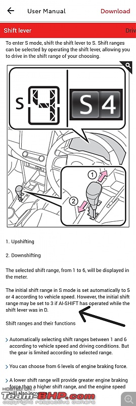

Re: Toyota Innova Crysta : Official Review
Originally Posted by haisaikat View Post
I
Can you please revalidate this claim of your?
Originally Posted by Dr.Car View Post
Nice observation! But is there any technical evidence for this?
Also, what would the difference between S4 and S6? As far as I know the S mode is there for manual shifting of gears if required. If we keep running the car in S6 all the time (At all speeds) wouldn't it have a negative impact on the gearbox? Thanks
It has been mentioned in many places but you can see the attached screenshot of the owners manual it says it clearly.
Also S mode is just to let the gearbox know which is the highest gear it can shift to and its not forcing it to be in 6th gear at all times is what i am assuming you think it means, its basically meant to be used to get engine braking while going downhill while limiting what is the highest gear it can shift to and in s6 mode it still shifts from 1-6 just like normal D mode just without the AI.
Toyota Innova Crysta : Official Review-.jpg
Got it! I also downloaded another international owner's manual of Crysta (Which has references to India as well), it also mentions the same thing along with some elaboration. Have attached the pictures below
Just a few last things which I want to ask you please
1. Will the S6 affect the overtaking a little? For Ex- If I am cruising at 80 Kmph and want to suddenly accelerate to 100 Kmph, won't the gearbox be slower to downshift than the D mode? Asking this because you said in S mode it would mostly downshift in cases where car is close to lugging.
2. Have you got any information regarding this AI thing in the Fortuner or other Torque converter vehicles like Seltos, Creta etc. I did research a bit but couldn't find any concrete evidence for the AI shift thing to be there on any of these.
Really can't seem to understand why Toyota could even think to add such a half baked feature in one of their vehicles which they developed after extensive research of the Indian driving conditions
3. In one of your posts you mentioned about the ATs' temperature? How did you get to know about it while driving? As far as my understanding goes, the indicator on the instrument cluster only shows the engine temperature.
Lets be clear, there is no Artificial Intelligence going on with this gearbox. This method of adapting to driving style has been around from the time we had the Mitsubishi Lancer 1.8 Invex AT. The Innova isn't so advanced for it to see the road ahead and decide the ideal position of the AT gearbox. The gearbox responds in line with most torque converters out there. What alters its behavior is the end user input, deciding what Mode to use on the Gearbox as well as Driving Mode, combined with the data it receives from the engine regarding load. Taking the car Off Eco mode alone improves the way the gearbox responds. You are no longer coasting out of control.
If what you are saying is true then why does the official owner's manual (Pictures in previous posts) mentions AI shift? Also, it specifically mentions that this AI shift thing is disabled when the car is put into S mode. That surely means that there is some tweaking involved when we shift from D to S.
Also, I have personally observed better mileage after using S mode on Highway and in City traffic which can be explained by the difference in upshifting and downshifting. Your thoughts please....
You are right about what is in the manual and its clearly stated on their Website too. They are going too far with using the term 'AI'. Note from that link, you find a demonstration using a 2014 RAV4.
'S', as already mentioned is a Sequential shift. You can leave the car in 'S' and drive or choose to do the gear shifts yourself. Its also indicating what gear you are in whereas in 'D' you don't know that.
This video explains whats happening under 'S' mode. Note that they don't say AI anywhere when its under 'D'.
If 'AI' were really at play here, you should get better fuel economy in 'D'.
