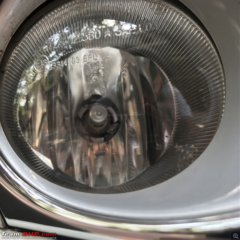

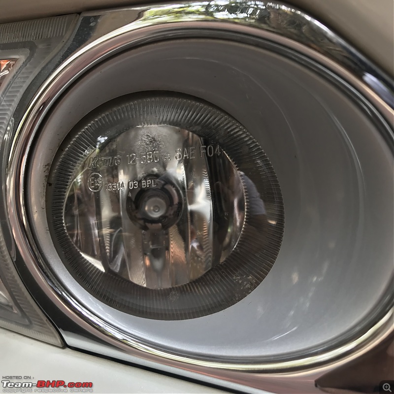

I faced similar issue on my Crysta 2.8 Z aswell. When car was back from 5k kms checkup, few days later noticed steering was vibrating and brakes shudder was present. To fix this issue I got the wheel alignment and balancing done from a reputed tyre shop. This reduced the issue to great extend but slowly vibrations and break shudder popped again. Fixed an appointment with Sharayu Toyota, Pune and got the rotors and break pads replaced under warranty. Have covered 8k kms since then and the issue is completely solved and I am happy with the car. As per service advisor, this issue was reported by many owners and same was the case with many initial type 2 Innovas in 2009.
On the other side, while I was just observing the foglamps, noticed my foglamp reflectors are melting. I removed the bulbs, and to my shock they are H16 units with merely 19W to offer. How can MPV which spends most time on highways have such pathetic foglamps? Toyota in order to cut costs has provided plastic reflectors which can’t even handle heat produced by those small 19W bulbs. I will raise this issue and get them replaced under warranty when car goes to 15k scheduled checkup anytime soon.

I am also happy with the vehicle except for its brakes. The 3rd set of rotors, pads and calipers are far far better than what I got with the vehicle in 2016. But still these are not 100% ok. If the Crysta did not have this much power then it would have been perfectly fine. And here mine is pushing 50% torque and still on these brakes
The number of people reporting brake issue with the Crysta is just too many, within teambhp itself there are many and tbhp represents only a fraction of the total number of owners.
Get it replaced and use Philips H11 LED in fog lights, the illumination is far better than those H16 bulbs and there will be less heat inside the lamps.
