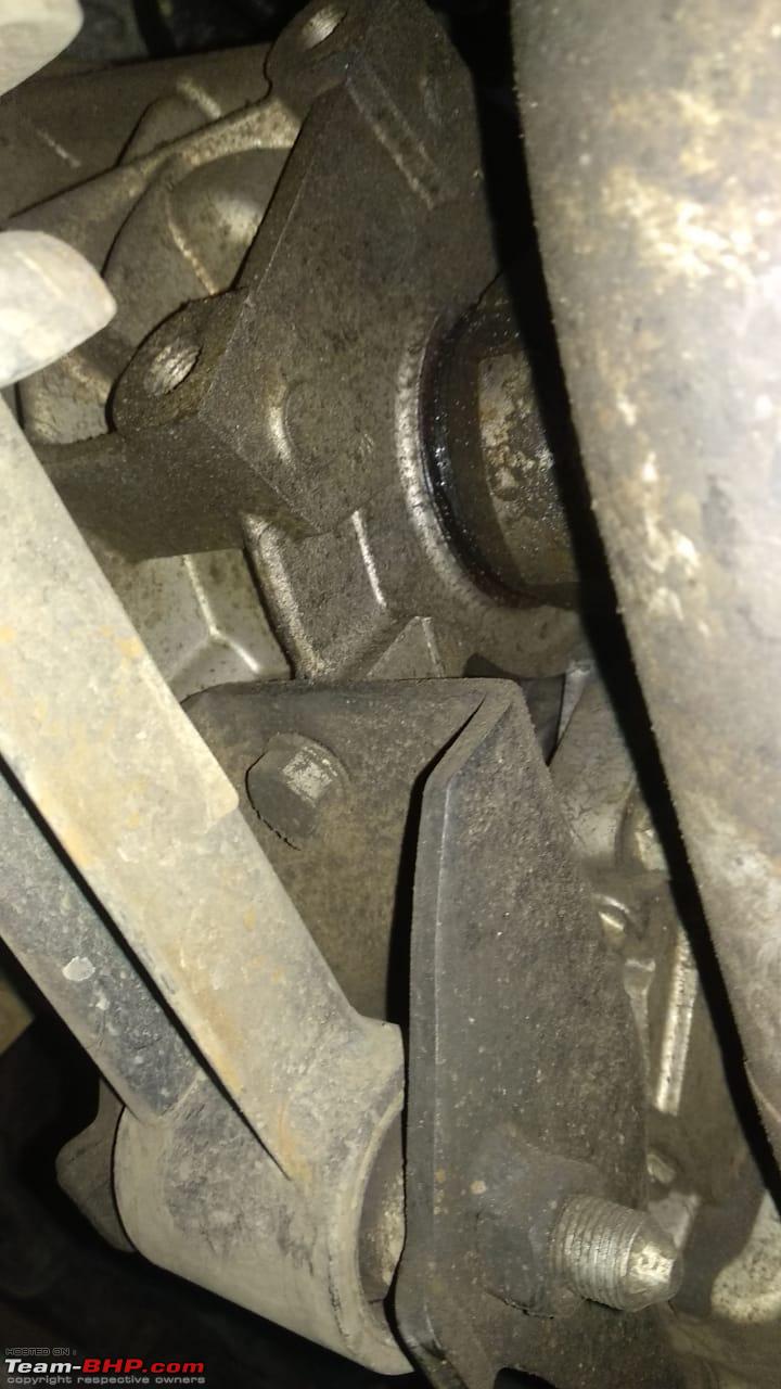

As per the Hyundai website, labour is 2300+ with 18% tax it comes to 2700+ which is matching with the quote he has given but Hyundai website doesn't mention anything other than that.
Originally Posted by hardilip View Post
I got another update that Drive Shaft Oil Seal has to be replaced as the oil is leaking. He has sent me a pick of the oil spill.
Part cost is 1250/- and Transmission oil top-up has to be done is what he has told. He hasn't mentioned the charges. Not sure if he will add labour on top of all these.
The reason why the Hyundai website doesn’t mention any other separate labour charges, is because your vehicle DOESN’T REQUIRE ANYTHING ELSE!
The first item on the list of labour - for replacing the fuel filter, this charge should also be covered under the periodic labour charge if the fuel filter has to be replaced during this 40,000kms service. Otherwise what’s the point of having a flat labour charge if the items are anyway going to be billed separately?
Fair enough if you need to replace a leaking drive shaft. Ask them to diagnose the rattling noise while they have the suspension dismantled.
Rest assured you will be charged labour separately in this case, which is fair because it’s an unforeseen repair. The rest of it however, is unacceptable.
How does he know the transmission fluid is low? Did he check the quantity? Is there an external leak? Are you suffering from gear shifting problems? The transmission fluid is a sealed system. If you’re losing fluid, it means there’s an external leak in some seal.
Ask him for proof. They are finding creative ways to add to the list of consumables. Engine oil, coolant, brake fluid - makes sense, but transmission fluid?!

Thanks once again. I tried reaching him couple of times he hasn't picked up my call. Might be he is following TBHP and this thread
I am going to ask for each of the points that you have told me.
He sent me an image with external leaks. Hardly I could identify something. But I never had issues in the Gear Shift.
That image does indicate issue with your drive shaft oil seal.
Indeed service centers are cheating, no doubt but this image sent to you, if genuine & from your car, then needs immediate attention.
One more indication, remember they had to top up the gear oil (transmission fluid)? It's a small leak but as you drive, slowly the oil level will continue to dip.
Minor leak won't cause any driving issue & gear hardness but if that leak expand & you end up losing oil rapidly while on highway, that can be catastrophic !!
So get it's address quickly.
Remember, your drive shaft was fine as per last service report. They only identified a seal leakage so be firm with that repair only. Replacment of the entire shaft will be very costly & totally not required.
