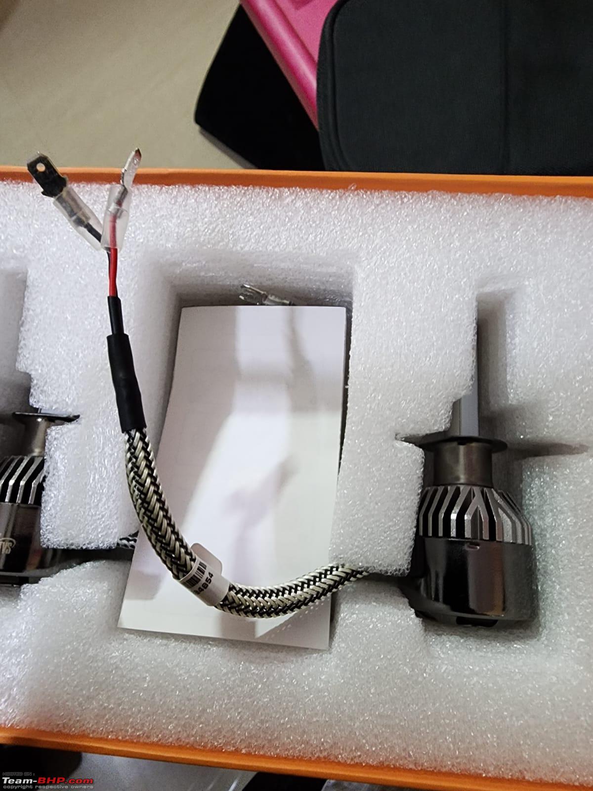

Hi ashishk29! many thanks for your posts about the headlight upgrade. I bought a xuv300 in September and did feel that the headlights were a bit underwhelming. Went through all your related posts in this thread and found myself agreeing with your rationale for the choices of lights (halogen vs led in low beam etc.,).
So, I finally went ahead and ordered the Philips x-treme vision G-force H7 for the low beam and TVS LED H1 for the high beam. Was able to easily install the low beam lights, but the TVS H1s are being an issue :
I'm able to affix the lights in the casing properly but not sure about the electrical connection. The stock H1 lamp has a different kind of base and the extra wire that comes with TVS LED has 2 wires whose connectors seem to be different sized
Mahindra XUV300 : Official Review-whatsapp-image-20221102-1.20.29-pm.jpeg
VS
Name:  Screenshot from 20221102 130718.png
Do you know how I can connect the wires properly? I also searched online, but wasn't able to find any definitive info on how to do it.

You're quite welcome! Happy to be of help.
About the H1 bulb, I can share 2 images that I come across:
This first picture is from the owner's manual of the 300. It shows there should be 2 connectors inside the headlight bay, which you would have to connect as such:
This is a snippet from a video about H1 bulb installation, but on a generic vehicle. You can see 2 wires attached.
So ideally you would connect the red wire to the wire in the centre which was attached directly to the bulb. And the black wire to the corresponding black wire.
