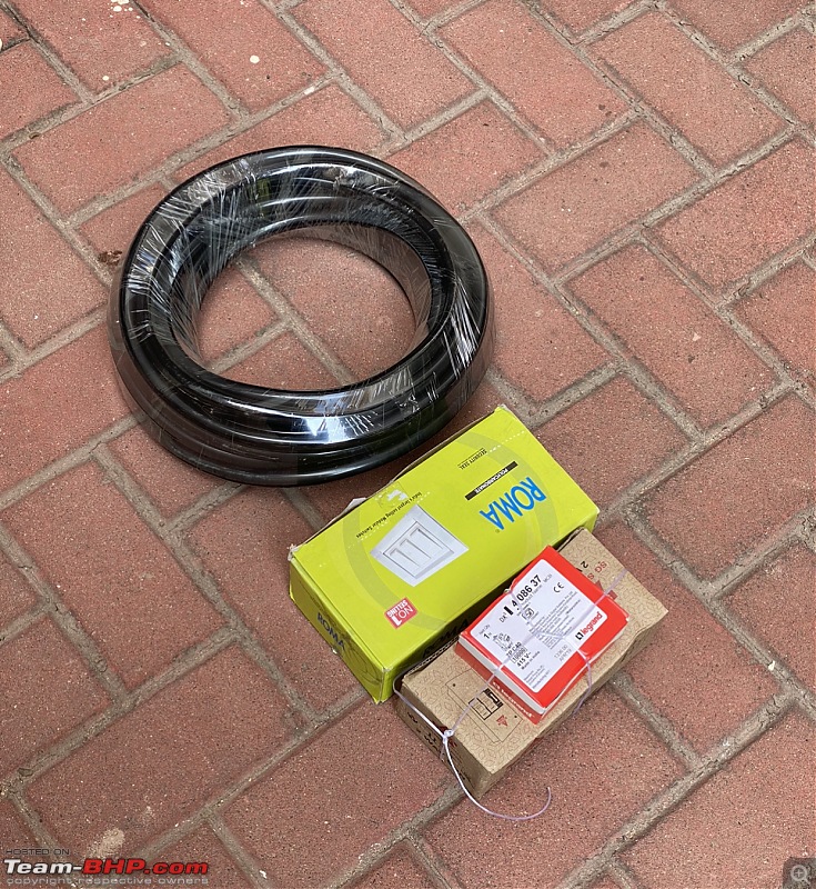

Before I get to ownership there is the challenge of doing the ground work to get the AC quick charger installed. Hyundai comes for installation only once the basic infra for their quick charger is in place. I decided to DIY it. They wanted 10 sq mm wiring which was harder to track down then I thought. I’ve terminated the line in a 40 amp breaker, with some extra 10 sq mm wiring post that for the Hyundai electrician to do his thing. Used a multimeter to ensure there was nothing on the earth line, they were quite particular that it be the case. I lacked the masonry skills to conceal the fat wiring, so I’ve just used clamps to make it look as neat as possible. I wonder how kona owners who live in apartments are dealing with needing to do this sort of work in “public” areas ?
Always fun when DIY! Gives a surreal pleasure.
One thought - at the top edge of the circuit breaker, It seems the 2 wires are just hanging bearing their own weight. This will cause the shield & copper inside to stress over time & crack. I suggest adding a horizontal clamp above the breaker to steady the cables over it on 1 side after the final installation is done by Hyundai. That way the weight will be borne by the 2 screws & not the cables.
