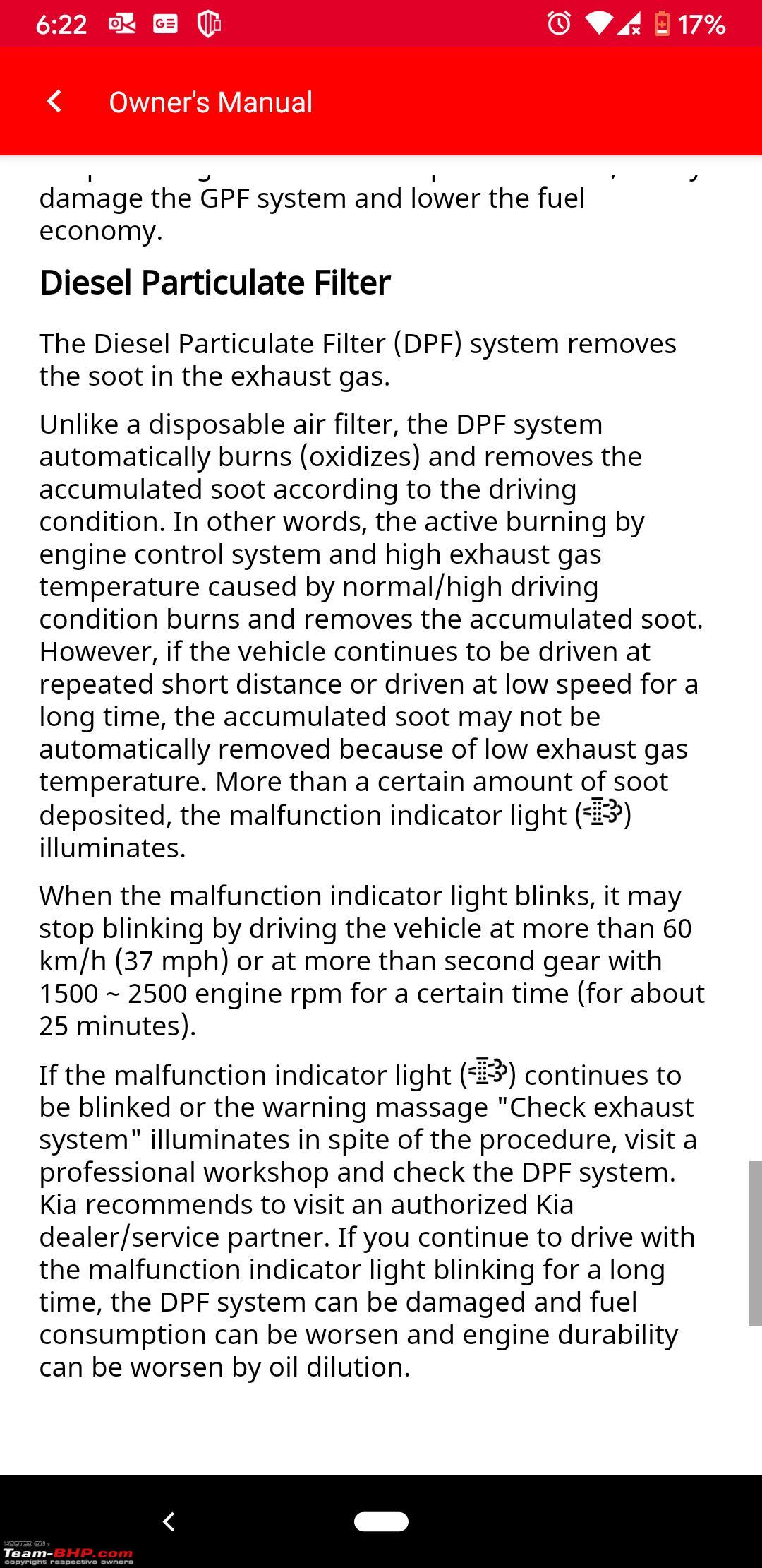

I wonder if this is safe to drive and if the DPF is clogged won't high revv's help it regenerate?
If it's clogged too much then the DPF might fail to regenerate and has to be taken to the service center. Check out the instruction from the user manual. It recommends not to drive for long if the DPF is clogged.
