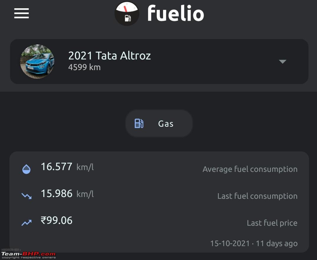

I'm getting 12-13 in short city drives an 16-17 in longish drives once engine warms up. Two lane highways with mostly 4th gear driving I get 19-20. Four lane roads it is 23-24 |
Firmly echo your thoughts on FE. If anybody is buying this car thinking they will get 25.11 kmpl from the get go they better hold it and look else where.
Just hit 5000 kms on the odo in over 3 months. It's 14 to 15 kmpl in KL traffic almost all the time. Haven't got much chances to stretch her legs except for a Coimbatore round trip where I did see 23 kmpl. On typical 4 lane NH roads of KL I manage 17 to 18 kmpl. Average speeds in KL is very low due to obvious reasons. The TFT display shows around 30 kmph average at this point.
Overall tankful to tankful FE stands at over 16.5 kmpl. This is what one should expect if you live and mostly drive in a state like KL. The ones who frequently use highways are really lucky because that is exactly what this car loves. Simply phenomenal in that aspect and returns superb FE figures too.
Overall tankful to tankful FE stands at over 16.5 kmpl. This is what one should expect if you live and mostly drive in a state like KL. The ones who frequently use highways are really lucky because that is exactly what this car loves. Simply phenomenal in that aspect and returns superb FE figures too. |
Thanks for confirming. I thought my car was having some issues.rl:
We in Goa have similar conditions to KL, probably even narrower and now worsened roads. These talks of 25+kmpl by others were sending me I to depression.

We in Goa have similar conditions to KL, probably even narrower and now worsened roads. These talks of 25+kmpl by others were sending me I to depression. |
Fuel efficiency is very specific and vastly vary with individuals and their locations.
For an example, there are Safari Storme owners who haven't seen anything over 12 kmpl in their ownership, while I have seen
18 kmpl tankfull to tankfull actual fuel efficiency. ARAI claim of Storme Varicor 400 is just 13.5 kmpl. While my overall average fuel efficiency, over 22000 km of observing through fuelio app stands close to that claim.
Same case with my Kwid 1.0, the ARAI claim is 22 kmpl while I have obtained
26.25 kmpl actual fuel efficiency in one tankfull. The overall fuel efficiency stands at 19 kmpl
To be noted is that in my case, my usage is 60 : 20 : 20 - National highways : State highways : City. And being a resident of a tier 2 city, b2b traffic is rare. More over I am extremely mindful when I want more fuel efficiency.
