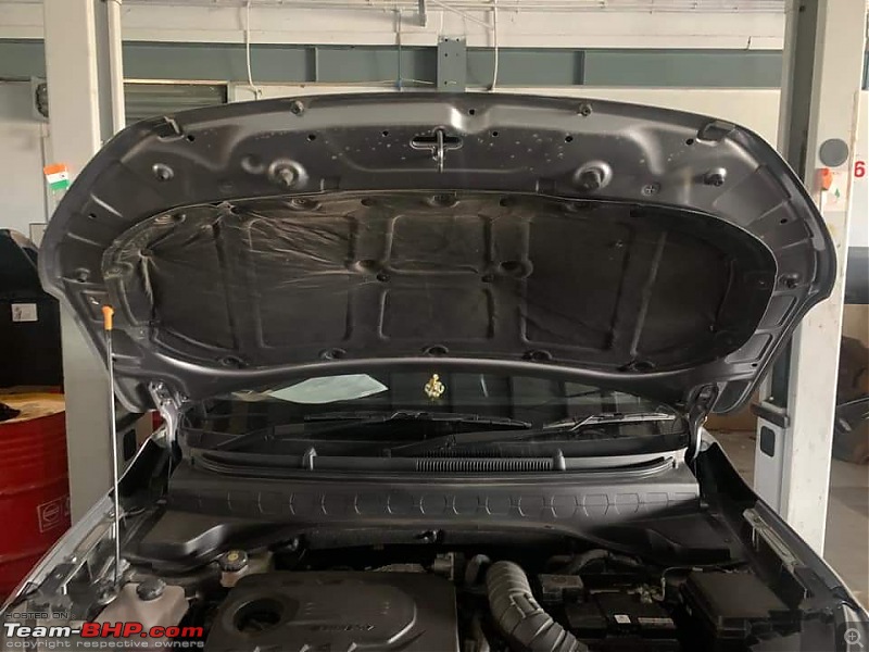

Around three weeks ago, Hyundai Motor Group posted a video on YouTube showcasing the manufacturing plant of Kia in Andhra Pradesh. I came across that video today and I have discovered something very interesting in it.
One of the scenes in the video shows a person inspecting a Kia Sonet. While doing so, he opens and closes the hood (or the bonnet) of the vehicle. Now, the hood of this Kia Sonet has an insulation pad. As far as I know, the Kia Sonet does not come with an insulation pad under the hood. The Team-BHP review points it out and my Kia Sonet 1.5 CRDi VGT 6AT GTX Plus didn’t come with one either.
I’m sure that the company wouldn’t equip an insulation pad on the vehicle just to make it look good in the video. That means Kia has most likely started offering an insulation pad under the hood of the Sonet. Maybe what I’m pointing out here has already been discussed on the forum. However, I couldn’t find any such posts here. So, I thought I’ll share this discovery with the forum members. I apologise for repeating the topic if it has already been discussed on the forum earlier.
If Kia has indeed started offering an insulation (or sound-deadening) pad under the hood of the Sonet, the existing owners could buy that from the service center and install it on their vehicles. This will reduce the sound of the engine transmitting inside the cabin. I’m attaching a screenshot of the video where the Sonet is equipped with an insulation pad under the hood. I’m also attaching the link to the video for your reference.
Kia Sonet : Official Review-sonet-seltos-cuttingedge-suv-manufacturing-plant-india-_-kia-india-329-screenshot.png
It is an export variant. You can clearly see the steering on the left hand side after he closes the hood.
In the next frame, when the technician is connecting the diagnostics to OBD, it's clear to be a right hand side steering.
Looking to put up insulation pad myself. Let's see if seltos one can be fitted.
Originally Posted by epiccross View Post
Can you please update me on this? Do dimensions match? I think if it does then most of the job is done. Little wary of doing this though, would it pose fire hazard (I think it does the opposite but not sure) or cause any sort of warranty issues?
My dear friend, who is a proud owner of a GTX+ AT, and I recently purchased a Seltos insulation pad for 1350, along with hood clips for 250. We attempted a small DIY project to install the insulation pad in our Sonet. However, the results were not as significant as we had anticipated. This may have been due to the fact that my friend had dampened all the doors from the first month of purchase. He suggested that I first add damping sheets on the bonnet before installing the insulation pad as my car is also damped to see if any improvement in sound deadening.
I'm attaching picture here for reference.
Kia Sonet : Official Review-whatsapp-image-20230128-12.51.28-pm.jpeg

... results were not as significant as we had anticipated....
Thats a nifty little DIY that quite a few owners have been looking forward to do. Was the insulator pad same size or it had to be adjusted? The holes matched perfectly?
When you say results were not significant, is it in relation to the noise insulation or heat insulation?
I tried looking for seltos under bonnet insulation pad on boodmo, but it seems out of stock. Was alternatively planning to just place some damping sheets instead of the insulation pad under the bonnet.
Insulation pad is of not same size it is on a bit bigger side, on right hand side a small portion will be not able sit like seltos but it will stay intact on the bonnet as holders do their work by holding it firm, so not a problem at all. Holes match only 20% you need to make atleast 80% new holes to make pad sit on the bonnet, it can be done with simple screw driver. I'm talking about noise insulation, heat insulation we haven't even considered into account.
We have used apple watch and mobile to record the decibels before and after here are our observations Before pad installation (<1000RPM = <59 db, 1000-2000RPM= <65 db, 2000-3000RPM= <70 db), After pad installation (<1000RPM = <58 db, 1000-2000RPM= <64 db, 2000-3000RPM= <68 db) with AC off, these may be inaccurate but we just wanted to try it out.
I suggest if you have any friend or family members who have seltos you can make them order/buy and get bill on their vin, also works if you have good connection with service centre. Try it out i suggest you - Damping sheet as 1st layer and pad as 2nd layer which I'm going to install in a month or so.

After doing some research, perhaps hood damping might not return good results. Will check it out once you go ahead with your DIY I'm coming from an 2015 Amaze which has bad NVH, so I can live with it for a bit
