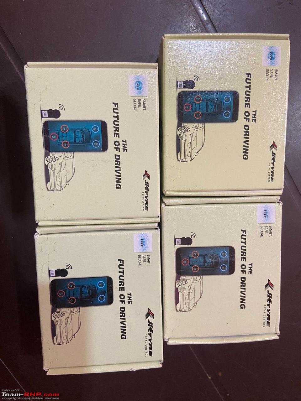

Installed JK treel TPMS on Toyota Fortuner. Bought it from Flipkart. Four units cost was aroud 1700/-

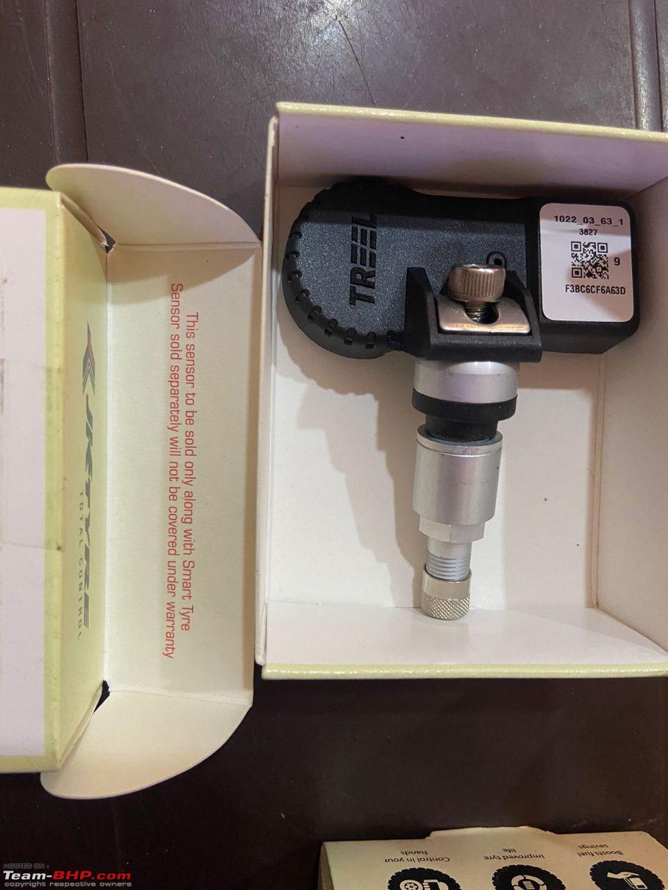

w/o any warranty , as mentioned in the box

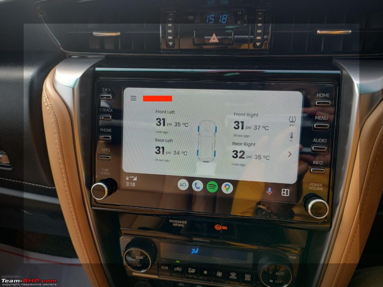

projections on android auto (some device wont support it, contact JK treel team).

1. Please note, this pack has individual units, hence no warranty on this. If you want warranty, then please purchase set of 4 @ cost of 5000/-(approx) from JK Treel official website. You can also purchase the display unit @ 2500/-. But in my opinion, this single unit @ cost of 450/- is also a great deal, if it works, ok ; if doesnt then throw away and buy another. Buy from the seller - the reliable company (no promotion) on flipkart.

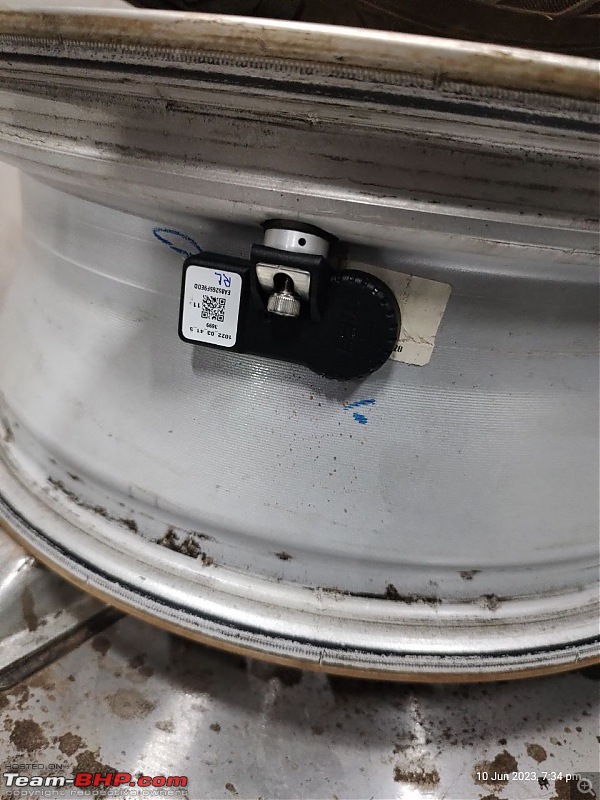

2. Visit those tyre shop, which has prior experience of installing it. I got it installed from the Highway Tyre, ring road Raipur. Prior to installation, download the JK Treel app, and scan all the TPMS QR code, you can number them as per the tyre position where it gonna installed. Here is how it fits (pic from my Dzire wheel while installing, i had number RL for Rear Left on that particular TPMS)
Please be attentive while installation, one incident I want to share, one XUV700 owner had come that day (you can see in my post that XUV beside my Fortuner), he was sitting in AC lounge while TPMS installation was going on, what mechanic did was they put extra torque while tightening the TPMS nozzle, rubber washer (below rim) got screwed and air started leaking (rubber washer which sits just below the alloy rim - in my pic). He had bought the unit which had warranty from amazon, he was tensed, had conversation with customer care guy, reply from another side was " sir, rubber ki koi warranty nahi hoti " . So, please be attentive.
3. Wheel balancing is must.

Hi, Please explain how did u get the display of TPMS on the screen of the OEM audio system?

I got this notification on the official JK Treel Smart tyre app.
Put your enquiry on whatsapp on any of the number provided above regarding how to enable the TPMS app on android auto and they will assist you. In my case, they called me within 20sec and sent me a pdf and an app (version 4.2.0) which I installed and its working. Don't forget to disable auto update on play store.
