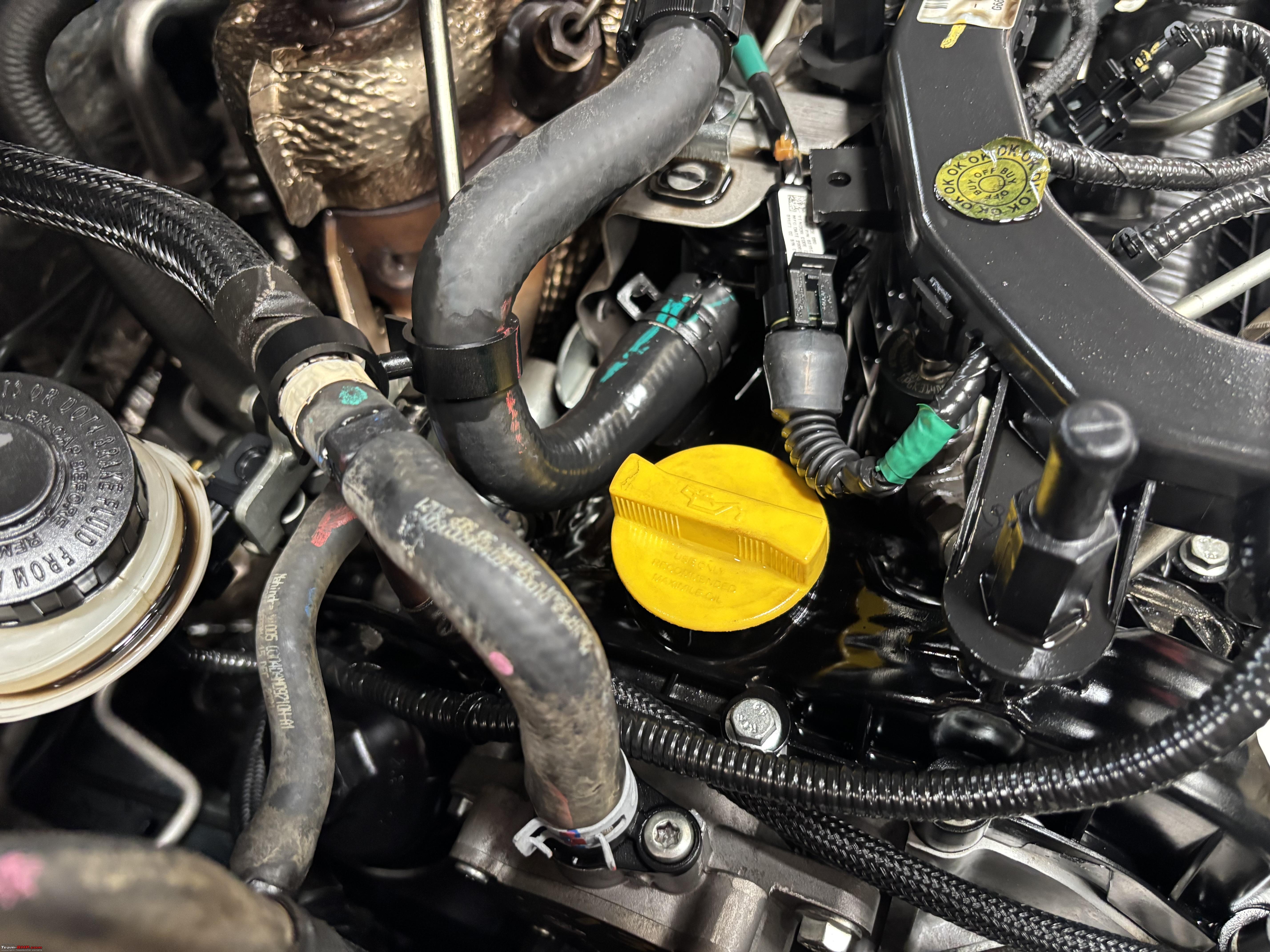

Originally Posted by katchkamalesh View Post
You mentioned that you serviced your car in September, and it's been over a month now. Did you not take the vehicle out or notice any oil spillage?
I feel that if the drain plug had not been tightened properly, the engine oil would have emptied by this time (around 35 days).
I did not observe the spillage. The spillage was not from the drain plug. The cap was not tightened properly after filing the oil and it slowly loosened due to the vibrations. The technician checked car history and all the other parts and confirmed that it was due to loosely fitted cap.

Th engine is my concern. I have gone beyond what Mahindra ask us to maintain the car. I changed the engine oil even though it was not required because I love my car. The technician says as of now the error is with turbo and once turbo is changed then and only he can confirm whether there is any issue with the engine or not. I have raised this issue in my email that I need confirmation from Mahindra that engine and engines performance is not affected. I have received assurances for them and I will have to wait and see how it pans out.
Thank you all for your comments and suggestions. I will keep you all posted once turbo is changed.
