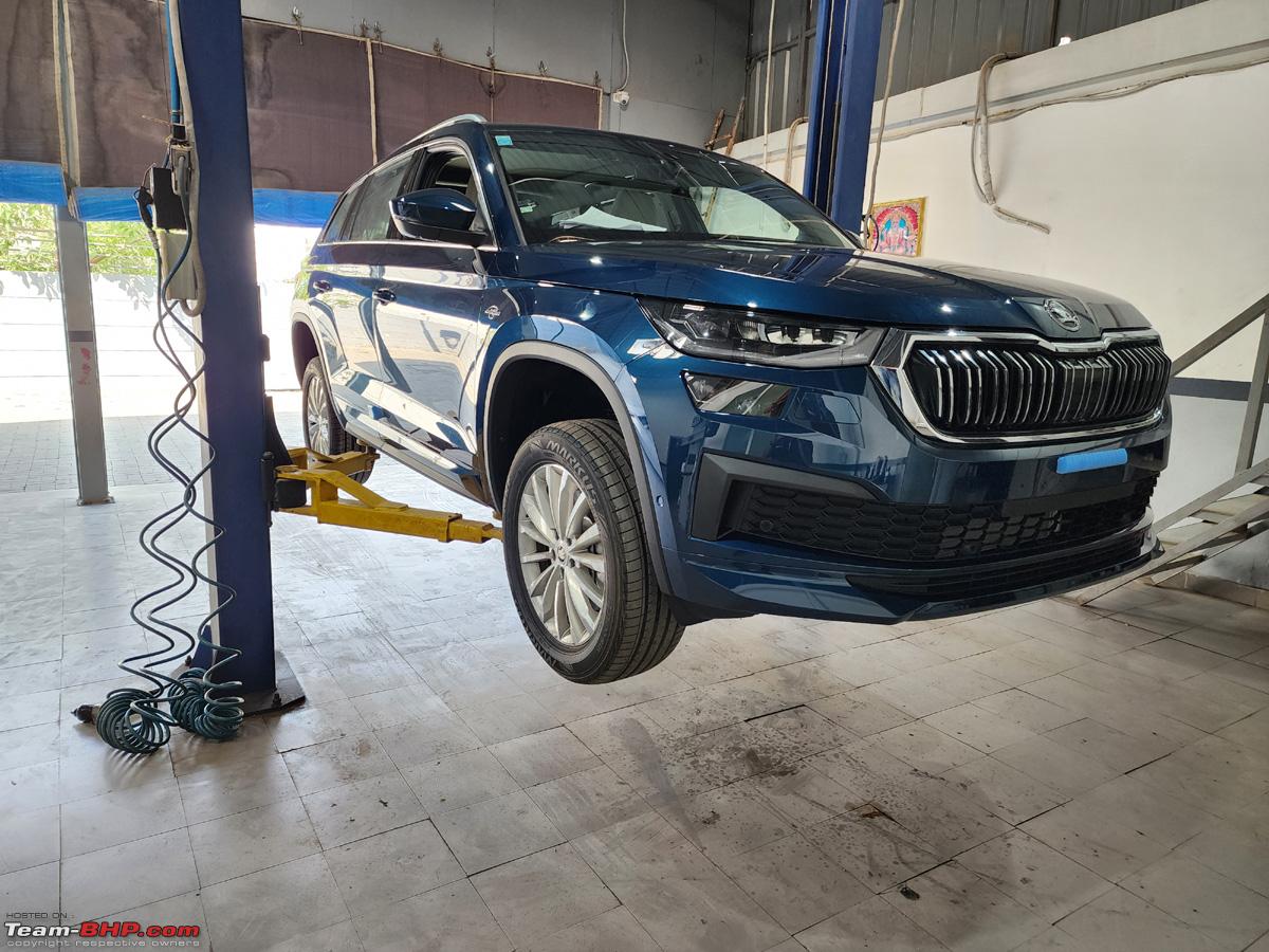

The car moves to the workshop after removal of the protective film for further PDI and Scan, which I have already detailed in the preceding post -
2022 Skoda Kodiaq Facelift Review | 2.0L Petrol DSG-skoda-kodiaq-pdi-12042024_3.jpg

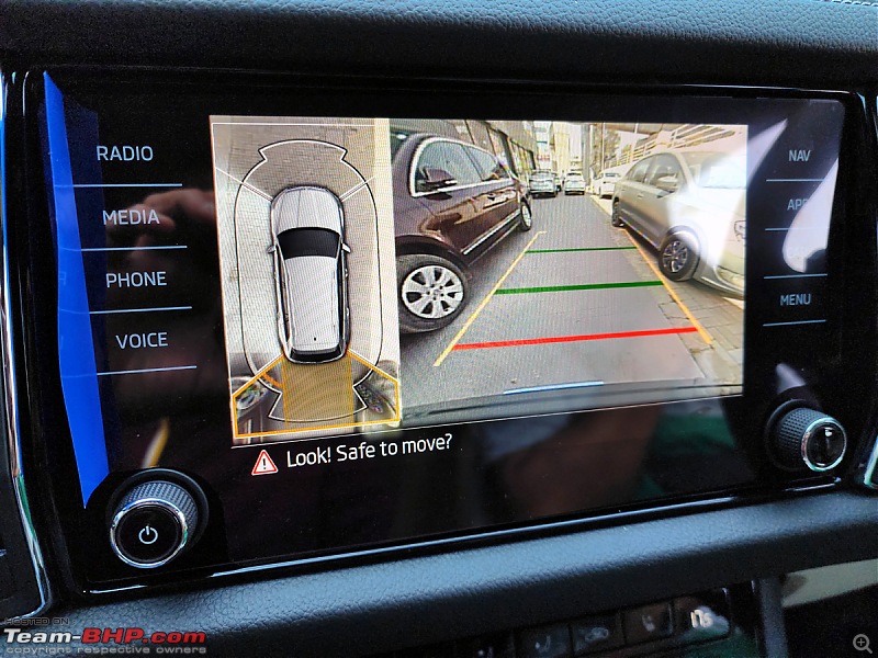

A view of the 360 degree camera. Though sharpness could have been better, but gets the job done well -
2022 Skoda Kodiaq Facelift Review | 2.0L Petrol DSG-skoda-kodiaq-pdi-12042024_16.jpg

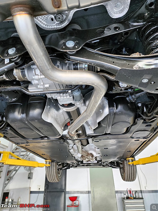

On the lift for underbody inspection -
2022 Skoda Kodiaq Facelift Review | 2.0L Petrol DSG-skoda-kodiaq-pdi-12042024_17.jpg
2022 Skoda Kodiaq Facelift Review | 2.0L Petrol DSG-skoda-kodiaq-pdi-12042024_18.jpg

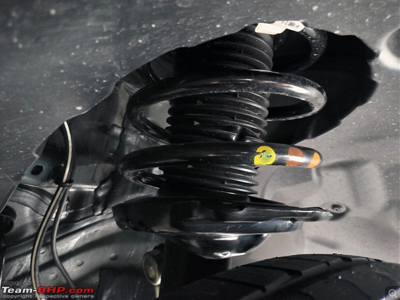

Transport Blocks
Suspension might have Transport blocks or additional stoppers which need to be taken out while the car might be on a lift. Failure to take these out, results in a very firm and rude ride, and also potentially detrimental to your suspension. VW Skoda techs are notorious for having missed these transport blocks. Here is a TeamBHP thread (Skoda forgot to advise dealers to remove vRS suspension blocks (used for transporting)) about the same.
