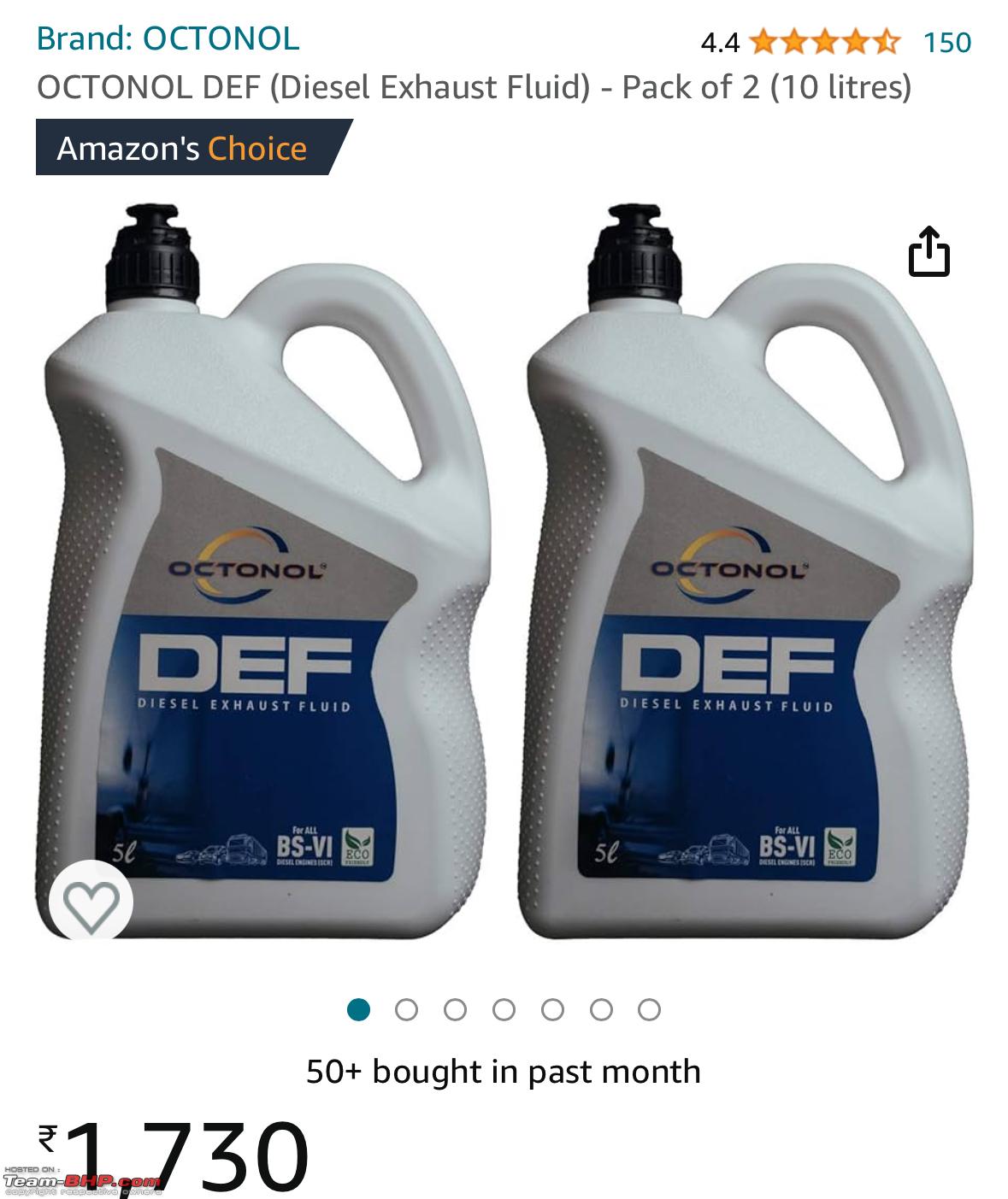

Got my AdBlue/DEF level down to about 60% (12L?) and have an 11 day trip coming up soon.
I don't want to go to the service center for filling DEF as they will waste my entire day while I could have been at home, playing Halo. Additionally, they impose "only mahindra fluid, nothing from outside" (I feel that it's a sales tactic but hell).
Been eyeing these for a while:
Would like to know:
1. Is it okay to get third party DEF?
2. Where can I find it being sold?
:3
Attachment 2525278
Would like to know:
:3
Toyota DEF is available for 500 for a 5L pack. Why would you want to get this 10L for 1700?
