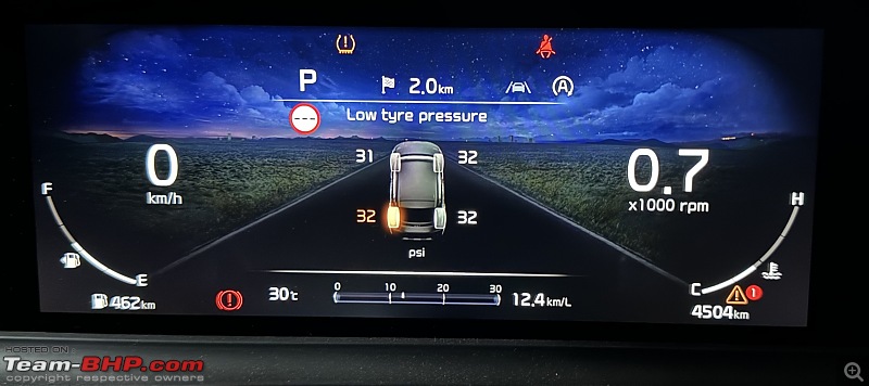

My rear right tyre pressure is showing less pressure from few days. Day before yesterday I drove the car after a week ( it was stationary for a week). Before driving got the error of low air pressure in front left and rear right (29-30 in both). I refilled it at nearby shop to 34. The front error disappeared but rear right is now at 32, still the low air pressure error is shown. It usually shows once air pressure drops below 30. Is there an issue with it or just needs a reset ?

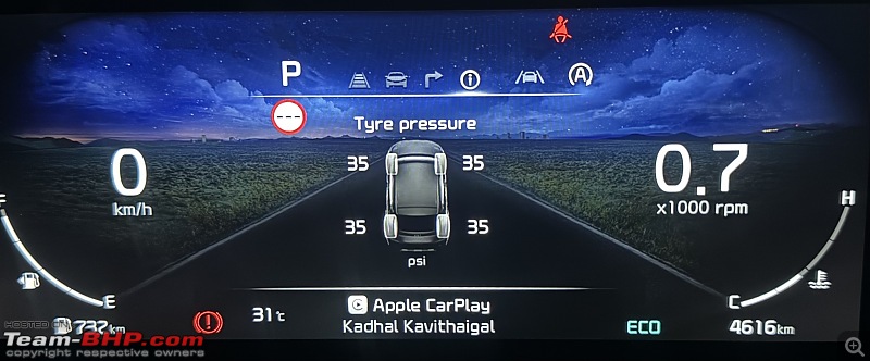

I had a similar situation (tpms error) this month, when air pressure in one of rear tyre dropped below 30 (no punctures upon inspection). I kept driving after refilling to 33psi as usual but error remained. Couldn't find any reset option for TPMS in user manual or under any menu option, but some online search suggested driving for a while after refilling to recommended tyre pressure (35), which also worked (I topped only to 34psi).

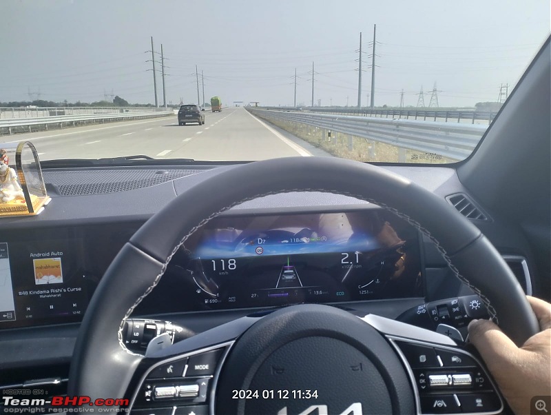

Originally Posted by BhayanaV View Post
Hi Guys, is there a way to turn on radio while keeping google map (through car play) on display? whenever radio is turned on, the display only shows radio and map directions are only vocal.
I am not sure if it works the same in carplay, but in android auto, if I press the mode button on the steering wheel, the map directions remain on screen and the music changes in the background to Android Auto/FM/AM/Sounds of nature etc.
I am not sure about this if its available when I am using Android Auto, but when I am using inbuilt maps, there is a drawer button on screen, if I open it, then I get 2/3 screen for maps and remaining 1/3 is customizable for music/weather/match scores/music/DRVM etc as seen in image. I can see/change the music scores this way. Once the change is done, I simply use the same arrow button to close drawer and view maps on full screen.

My rear right tyre pressure is showing less pressure from few days. I refilled it at nearby shop to 34. The front error disappeared but rear right is now at 32. Is there an issue with it or just needs a reset ?
Have you checked your tire for a puncture? That is a common cause for TPMS errors, as the tire is actually losing pressure.
If there is no puncture, then you can proceed to diagnose the TPMS itself.
Don't think there is a puncture because the pressure is steady for past 2 days.
