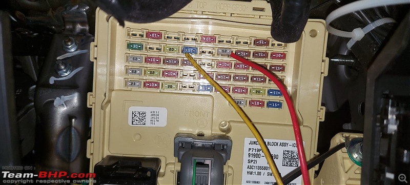

Hey there, I had an issue with my IRVM dimming feature which wasn't working as intended, and after a lot of follow-ups with the ASC, it turns out that the issue was with the hardwiring of the Dash camera, which after being disconnected has resolved the dimming issue with the IRVM, however, would you be able to let me know if you've come across this issue, and if not, can you please help me out by letting me know where have you inserted the ACC and Battery wires to the fuse box? This was the installation that had been done on my Seltos which created a conflict between the functioning of the IRVM's dimming feature,
I'd really appreciate if someone who had there Dashcam hardwired help me figure this out without any issues, whatsoever.

Oh NO NO NO. A big NO to the installation. Whoever did that installation is, sorry to use strong language, an IDIOT. That is a fire hazard. They are not supposed to insert live wires into fuses. From the pictures, it seems that they lifted up the fuse and inserted the wires there, which is very wrong. They are supposed to use a fuse tap.
Name:  Screenshot 20241122 084514.png
The black part needs to be inserted into the fusebox and the two slots on the top need to be filled with the original and the dashcam fuse. Also choose a fuse that is always on.
Refer to the handy guide: https://www.team-bhp.com/forum/diy-d...r-dashcam.html (DIY: Hardwiring your Dashcam)
And to reiterate, be thankful this only resulted on a visit to the ASC and not something more dangerous. Always go to a trusted accessory shop and not someone who does jugaad.

Most of the cars have some spare fuse slots available.
Are there no spare fuse slots available in Seltos which can be used to hardwire the dashcam?
kgt.v8 is online now   (1) Thanks
Attachment 2686187
Brother, whoever did the hardwiring like this should be arrested & never be let in 100kms of any car modification! This kind of tomfoolery could result in a very very nasty experience. Please get rid of this & stick to powering your dashcam from the cigarette ligher. Avoid this kind of Jugaad.
