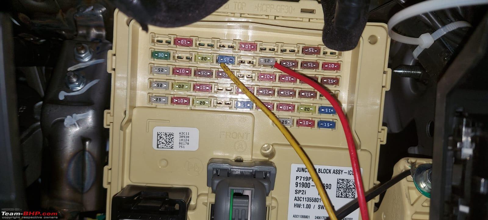

Hey there, I had an issue with my IRVM dimming feature which wasn't working as intended, and after a lot of follow-ups with the ASC, it turns out that the issue was with the hardwiring of the Dash camera, which after being disconnected has resolved the dimming issue with the IRVM, however, would you be able to let me know if you've come across this issue, and if not, can you please help me out by letting me know where have you inserted the ACC and Battery wires to the fuse box? This was the installation that had been done on my Seltos which created a conflict between the functioning of the IRVM's dimming feature,
I'd really appreciate if someone who had there Dashcam hardwired help me figure this out without any issues, whatsoever.
Attachment 2686187
Originally Posted by blogslogger View Post
Oh NO NO NO. A big NO to the installation. Whoever did that installation is, sorry to use strong language, an IDIOT. That is a fire hazard. They are not supposed to insert live wires into fuses. From the pictures, it seems that they lifted up the fuse and inserted the wires there, which is very wrong. They are supposed to use a fuse tap.
Attachment 2686218
The black part needs to be inserted into the fusebox and the two slots on the top need to be filled with the original and the dashcam fuse. Also choose a fuse that is always on.
Refer to the handy guide: https://www.team-bhp.com/forum/diy-d...r-dashcam.html (DIY: Hardwiring your Dashcam)
And to reiterate, be thankful this only resulted on a visit to the ASC and not something more dangerous. Always go to a trusted accessory shop and not someone who does jugaad.
Originally Posted by kgt.v8 View Post
Most of the cars have some spare fuse slots available.
Are there no spare fuse slots available in Seltos which can be used to hardwire the dashcam?
Arikarin, my dashcam is hardwired in my Seltos without any problems. I’m sharing images of my dash cam, fuse box setup with fuse taps inserted and the fuse box diagram where I’ve marked the tapped fuses with red dots for your reference. In my setup, the battery wire is connected to the 30A driver seat electric adjustment fuse, and the ACC wire is connected to the 20A power outlet fuse for parking surveillance. This setup works perfectly and keeps everything safe. I’ve driven close to 20,000 km in the last 11 months with this setup and haven’t faced any issues. I also periodically recheck for any early signs of problems, but everything has been working smoothly, so I can confidently say this is a safe approach.
Just make sure to use good-quality, heavy-duty fuse taps, crimp and connect wires correctly to the fuse taps and avoid inserting loose wires into the fuses like in the image you shared—it can cause unnecessary and serious issues.
Hope this helps! Let me know if you need anything else or have more questions

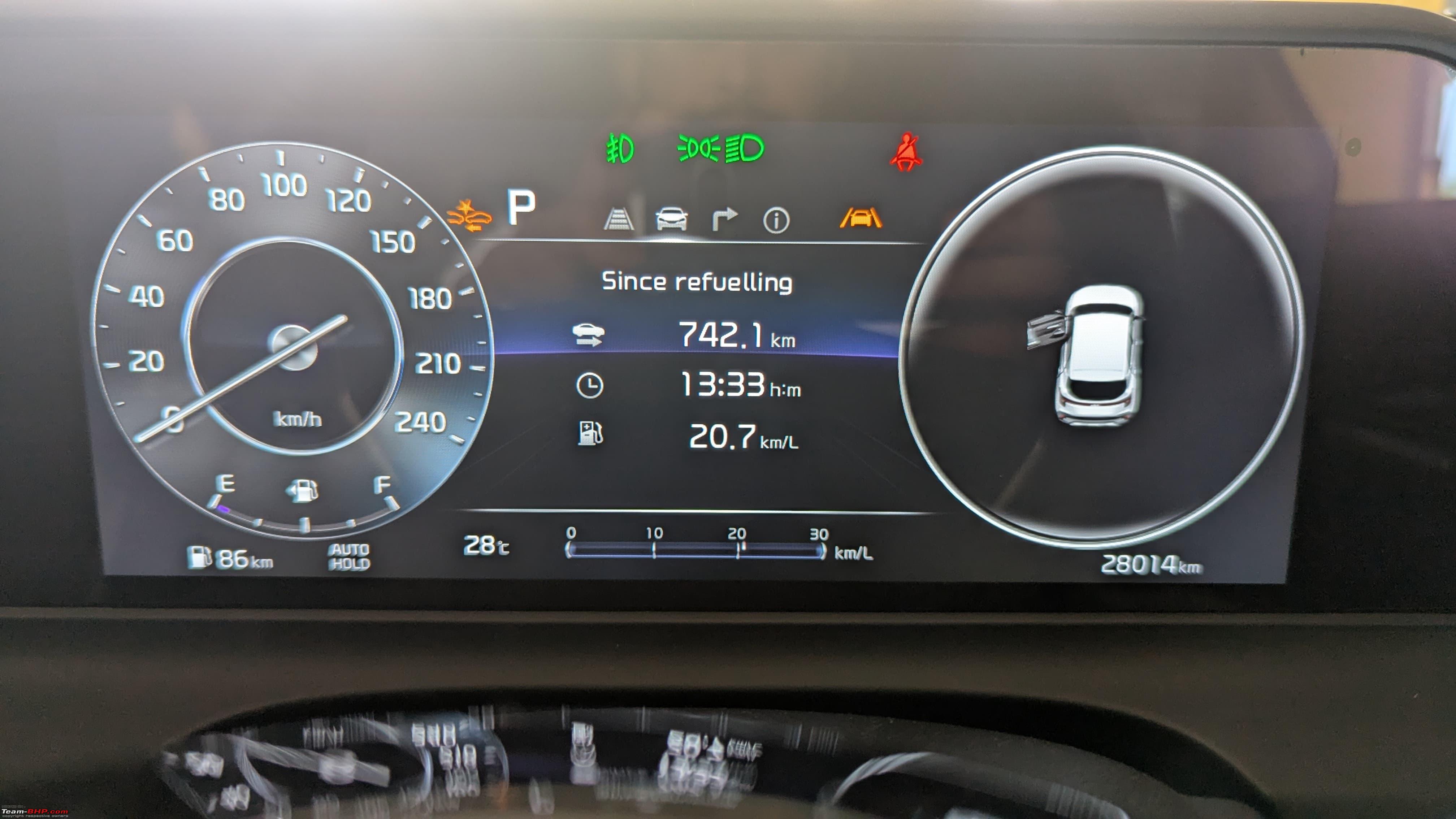

The MID shows the mileage as 20.7km/l. The tyres were set to 33psi (cold tyre pressure) throughout the trip
Attachment 2706412
We got an average of 18km/l for the entire road trip

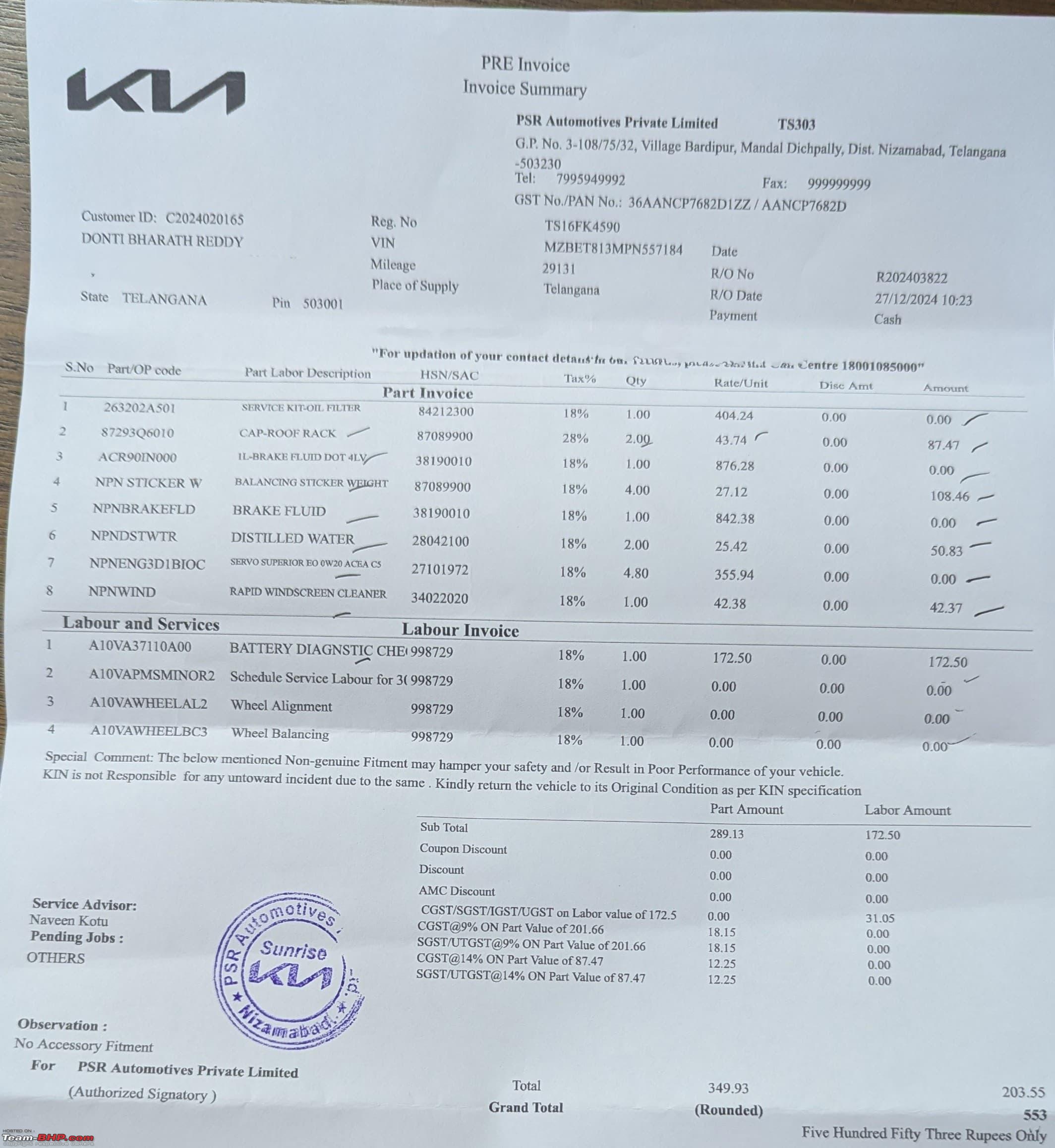

Gave the car for 30,000km service. The bill came up to ₹553. I have the my convenience plan

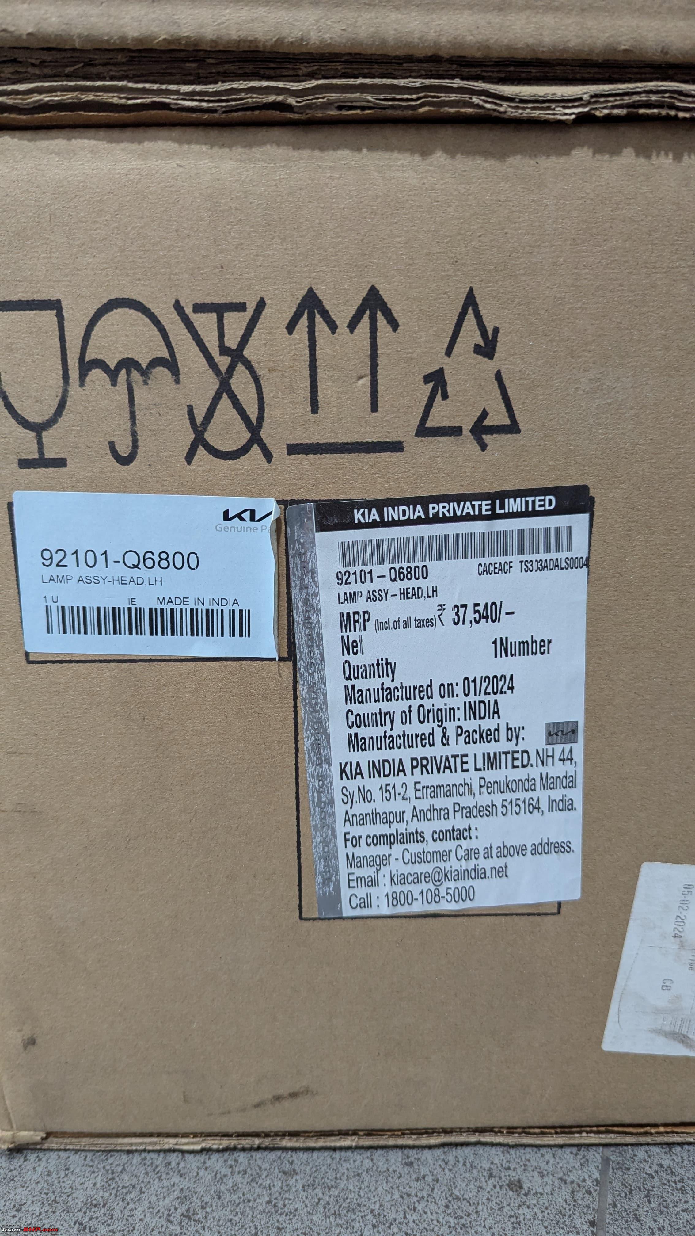

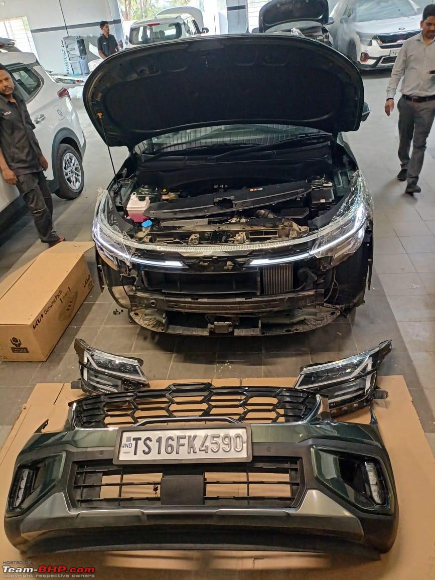

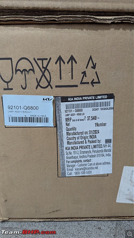

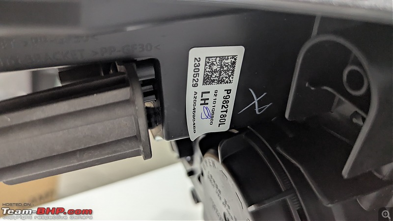

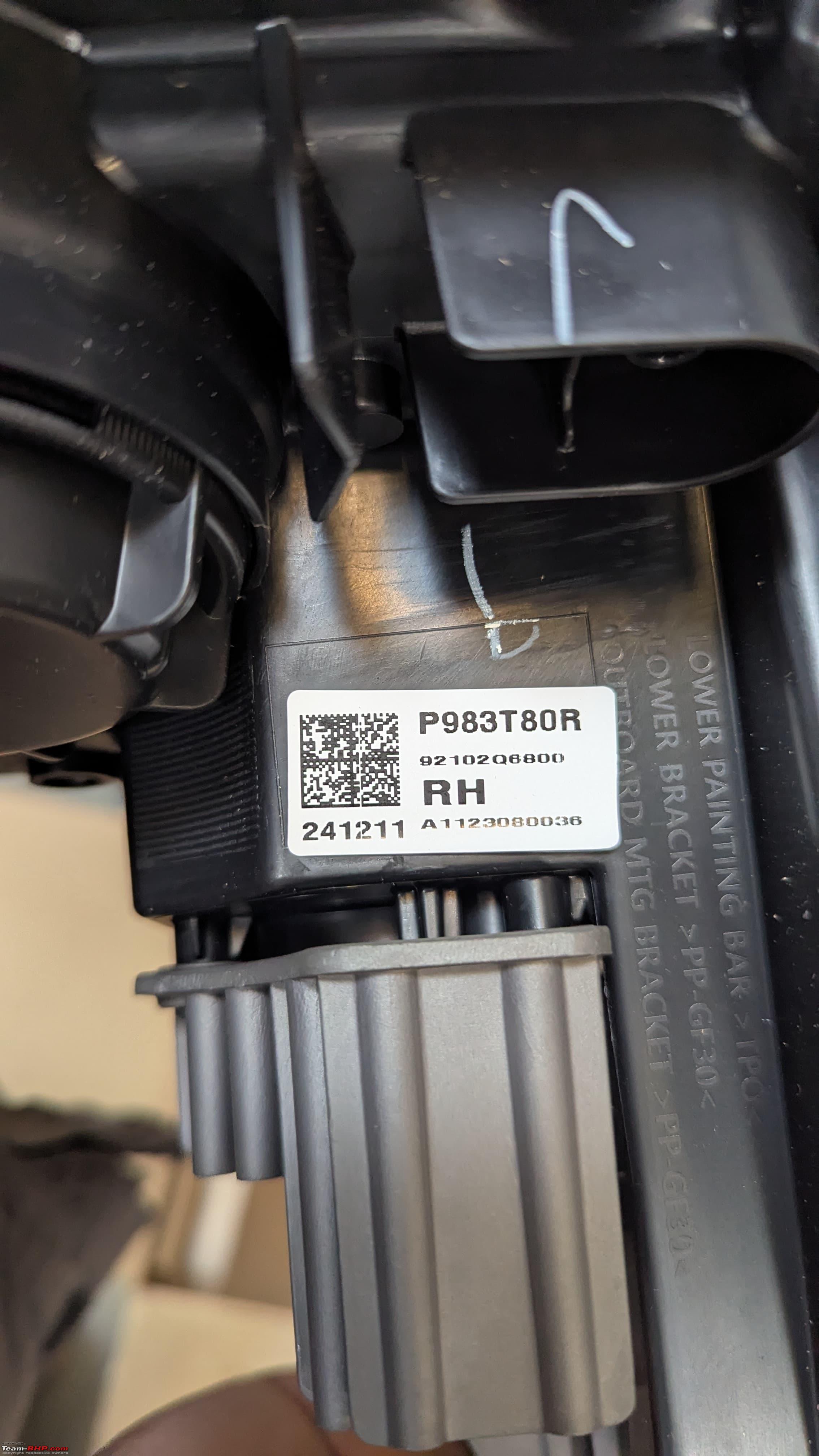

Update on Headlights
After installing the new headlights and conducting tests, the service team discovered that both headlights sent by the vendor were intended for the left side of the vehicle . They removed the entire unit and reinstalled the old headlights.
Since the warranty process is complete, the service advisor has informed the vendor that the car is currently at their body shop. He is confident the new parts will arrive at the service centre within a week.
Final Update on Headlights
The parts arrived on Monday night, as promised by the SA.
I dropped off the car this morning around 11:30 AM and picked it up by 5:30 PM.
The entire process was straightforward and can be summarized in three steps:
1. I posted pictures in the WhatsApp group created by the SA for customers bringing in their cars for service. The SA then instructed me to bring the car in for inspection.
2. Since it was time for my car's scheduled service, I arrived at the service centre, where they asked for the vehicle's purchase date and the kilometres driven. The SA immediately agreed to replace the headlights under warranty, as they had recently replaced the lights for another Seltos due to the same known issue.
3. The entire warranty approval process took about 4 to 5 hours.

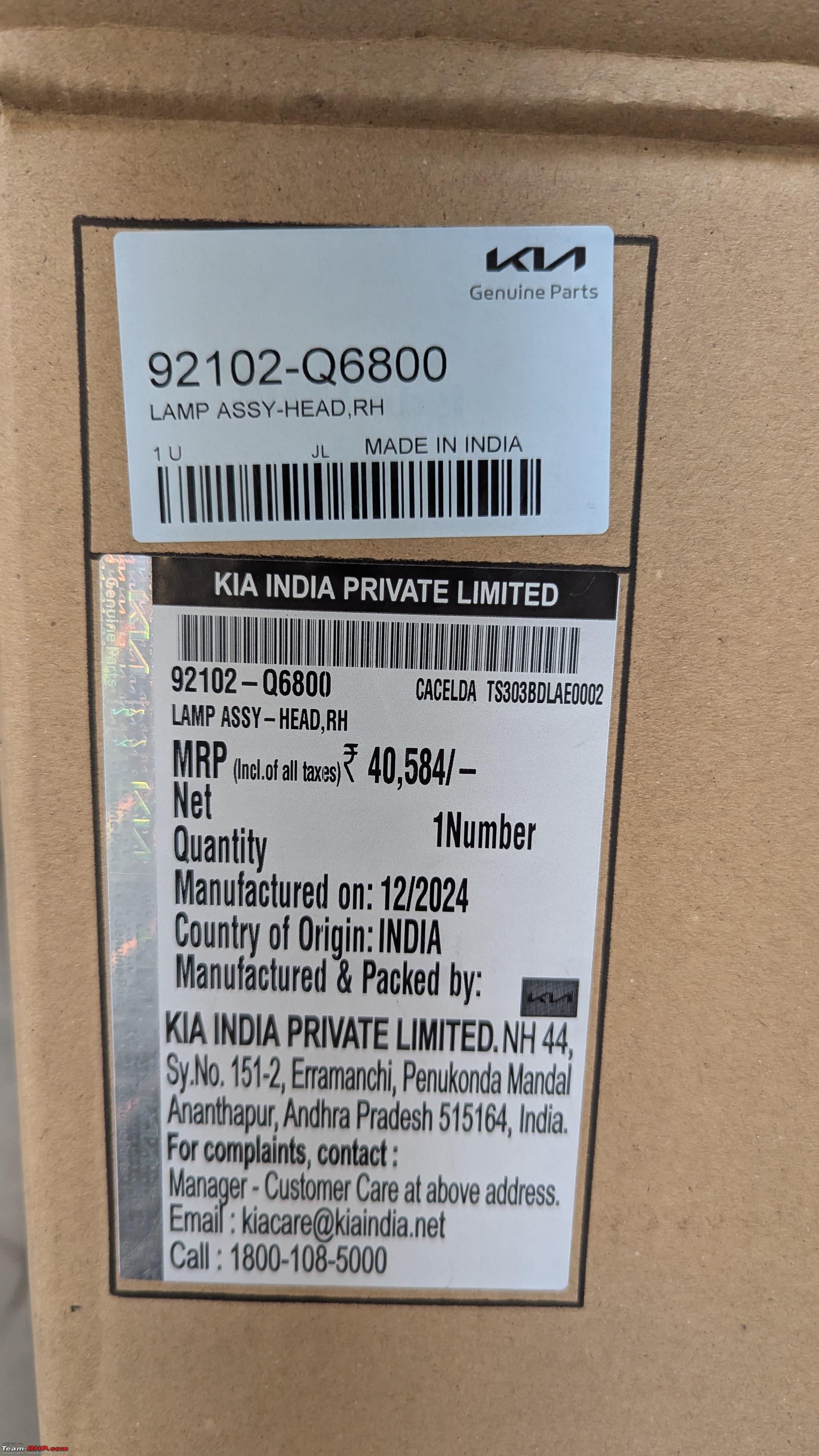

If the headlights are not in stock (often the case), the parts can take approximately 15 to 20 days to arrive.
The reason why KIA isn’t taking this light issue more seriously is another topic for discussion. I would have been quite frustrated if the dealer had created unnecessary complications.
Aside from a minor error where they packed the left-side headlight unit in the outer box labelled for the right-hand side, I am overall satisfied with how the dealer handled the situation. I hope these new headlights, which the service manager assured me are improved, will last longer.
They have also mentioned the parts replaced in the bill.
Attachment 2709700
Attachment 2709694
Attachment 2709693
Attachment 2709701
Attachment 2709696
Attachment 2709692
Attachment 2709695
Attachment 2709689
Attachment 2709690
Attachment 2709699
Attachment 2709688
