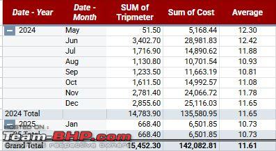

Brief Review of Petrol GTX+ 15000 Kms
Red GTX+ Petrol delivered on 29-May-24 and manufactured in May 2024 .
Driven 15470 Kms till now.
Fuel: 142,082.81 INR.
Accessories: 141,703 INR (includes major expenses of PPF, sunroof and front film & dashcam).
Service: 4,876 INR.
Maintenance: 7,550 INR (includes alignment/rotation, puncture, washing).

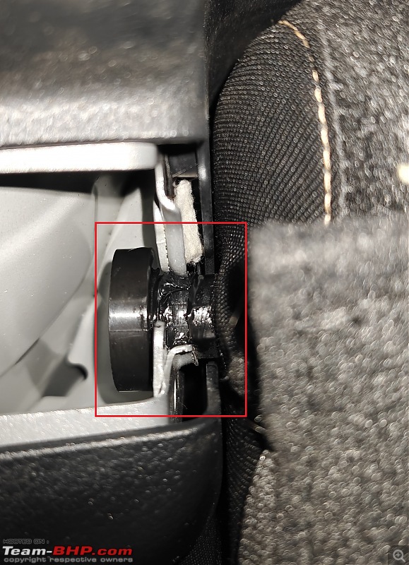

src, thanks for your detailed post on your car. It really helps to hear about the real-life experience—the little things like how it handles on daily drives or long trips. Life’s a journey, and your insights made a big difference in understanding what to expect. Appreciate you sharing! I see you've listed a few "bads" about it, but I’ve got some solutions that could definitely help cut that list down! The noise is not due to rear parcel tray. Kia fixed it's parcel tray rattle issue in 2023 facelifted Seltos. After a lot of following up with the ASC, they did "jugaad" fixes in my Seltos 2023 and it went away .The noise is from the 60-40 seat backrest rollers moving on hard metal frame while driving the car. It's annoying and was driving me crazy when no one was sitting on the backseats. Turns out, the 40 seat backrest was causing most of it because it's lighter when empty. The service guys at ASC figured out that the rollers at the bottom of the backrest were rubbing against the metal when the rear seats where unoccupied, making that annoying noise while driving the car. They removed rear 60-40 seat backrests, taped the rollers with insulation tape, sprayed some WD-40 for smoother movement, and refitted it. It's a bit of a Jugaad but everything fits tightly now and it’s been totally quiet ever since! NVH levels are very good in Kia vehicles, and even a slight annoying unwanted noise from the interiors of the car is irritating most of times. Try this fix and ask your ASC to do it for you. I am sharing images for reference.
Seat backrest bottom rollers are taped a couple of rounds with insulation tape, greased and lubricated with WD-40, this makes them sit tight in the frame and the annoying noise is gone !!!
