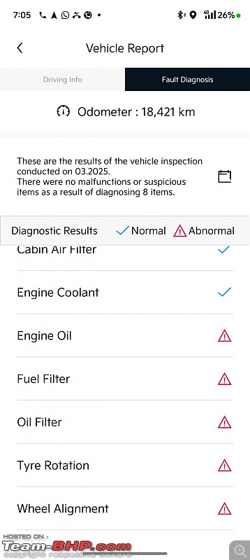

BHPians
Need expert views
During a random check on KIA connect app I noticed that the fault diagnostic section is showing Engine oil, fuel filter, Oil filter, tire rotation & wheel alignment as abnormal (rest of the parameters are showing normal).
I have serviced the car at pre defined intervals, despite that what could be the reason to get such diagnostic results?

Hello TorkBHP, The KIA Connect app has a Maintenance Alert section where you can manually reset all these service intervals. Sometimes, even after a proper service, the app doesn’t recognize it until you update it yourself. Just hop into the maintenance alert section and reset the ones for Engine Oil, Fuel Filter, Oil Filter, Tire Rotation, and Wheel Alignment and others—that should clear up those ‘abnormal’ warnings. I’m attaching a screenshot so you know exactly where to go. Stay on top of your car maintenance game—no one likes surprise issues on the road! Let me know if you need any help.
