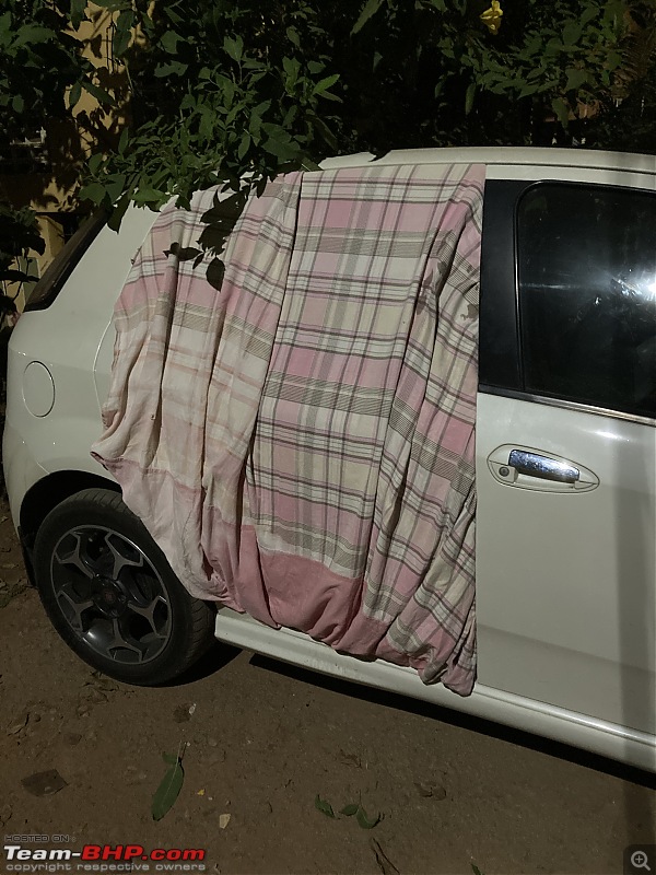

This monsoon has been brutal to my 2009 Grande Punto. Found a leak happening through the tail light with water collecting in the spare tyre well.
This past week has thrown up the following issues
1. Central locking decides to stop working. The minute I lick it it automatically unlocks. The passenger and rear left passenger doors also don't seem to be opening from the outside.
2. Then the tail gate struts decide it's time to die.
3. Today the left rear passenger window decided to stop working.
The car is spending it's first Monsoon in Bombay and parked without cover. Suffice to say it's been brutal. Looking forward to some sunshine and DIY work.
Any suggestions for good local FNG's are welcome. Based in Dadar E for reference.
A picture of the trouble makers.
