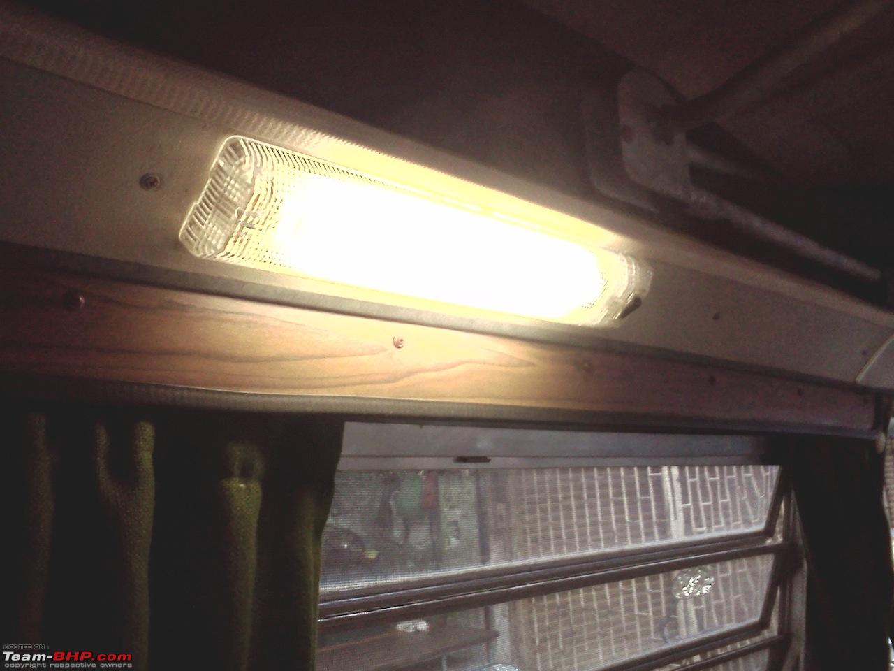

A orignal Westfalia interior light which was missing. The piece of tin that surrounds the alternator (this is supposed to be a part of the original engine tin but was missing). And the cooling flaps which are supposed to be inside the engine tin.
We installed the light yesterday, here's the before and after pics:
