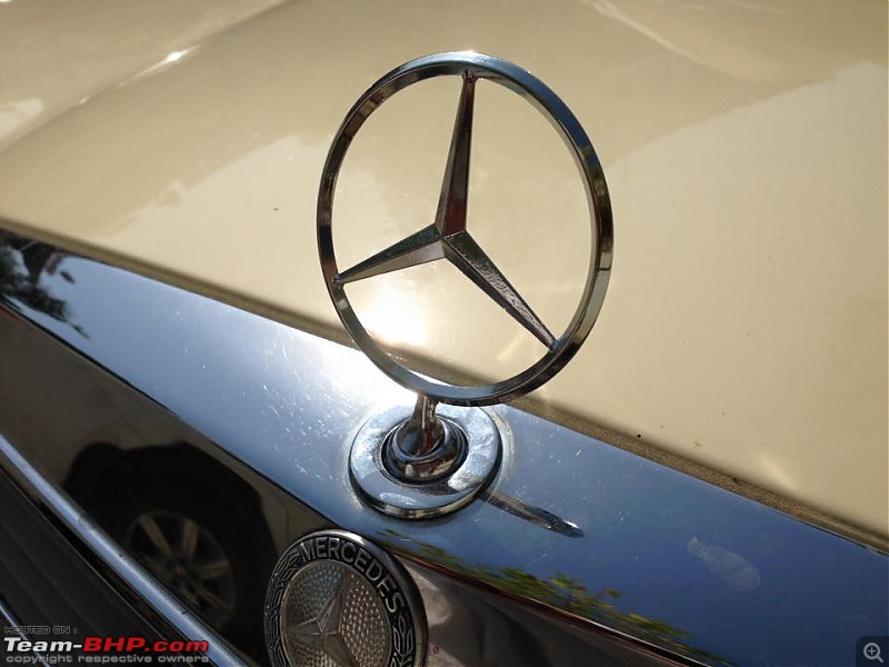

'83 Mercedes 240D - My W123 Restoration Diary-22814009_1931657293527931_8601915669840689772_n.jpg
Just a small update today. Few weeks back it was raining hard and I had left my Mercedes uncovered for the night. Unfortunately that caught the attention of someone and he pulled away with the hood ornament.
Today I finished installing my third star in as many years. Before I installed the star I have also spent 2 weekends installing surveillance cameras around my house and now two of them focus on the from where our cars are usually parked. The vandals better watch out.

Originally Posted by BowMan View Post
Attachment 1689390
A common problem for all Mercedes owners the world owner. There are detachable ornaments, so when you park you car, you can simply take it with you.
Touch wood, mine has never been ripped off yet. Probably just a matter of time
Jeroen
Jeroen
Lucky you and I hope it stay like that. But I'm kinda fed up of this and so the surveillance system. If it happens again and I know who is doing it the guy will have it. But when I take her out and park her I have to make sure he is within my sight. Some of the busy shopping malls are favorite hunting grounds for these vandals.
Attachment 1689390
Not only that I had my Star ripped off by a person who was crossing the road at busy Bandra junction just because he felt like fidgeting with it. The Bandra junction on SV road is a place where hundreds of people will even stop a moving car in order to cross the road. Luckily now I have a V-cross and no one dares jumping in front of it at the Bandra junction.
Hey nice to hear from you tazmaan after a long time. On the Mumbai roads I can for sure visualize this situation. We don't have it so bad in these parts but I have started to become more careful where and when I take her out.
