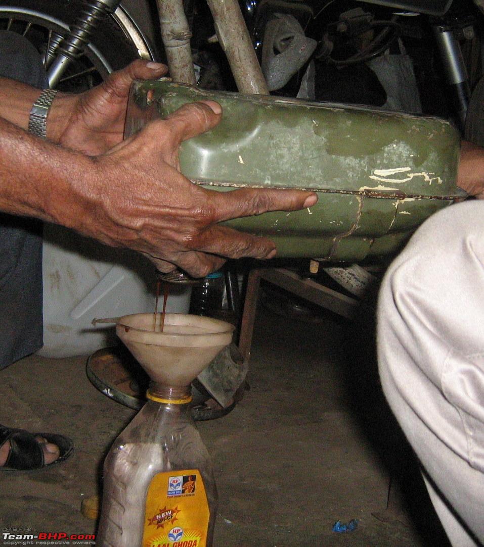

First of all, the petrol tank, which had long gone dry and rusty from the inside (as seen in pic., albeit not too clear), was taken out to be acid-cleaned from the inside.

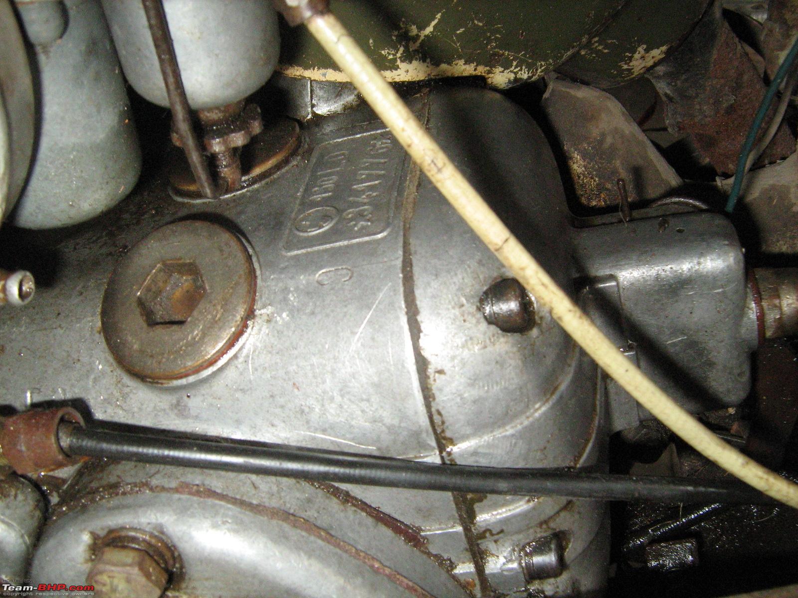

Then came off the carb. There were a few issues uncovered here, namely that the the carb barrel had cracks all around, maybe due to rough handling earlier. It was 'fixed' by fitting of copper sleeves on the inside, as can be seen! Worse still, I knew the choke knob was missing, but turned out the entire choke unit was gone, and the cavity in the carb where it was connected had a cloth stuffed in it! :Shockked:
Air-filter element (looks like something used in the old kerosene stoves though!) too looked dry and frail.
