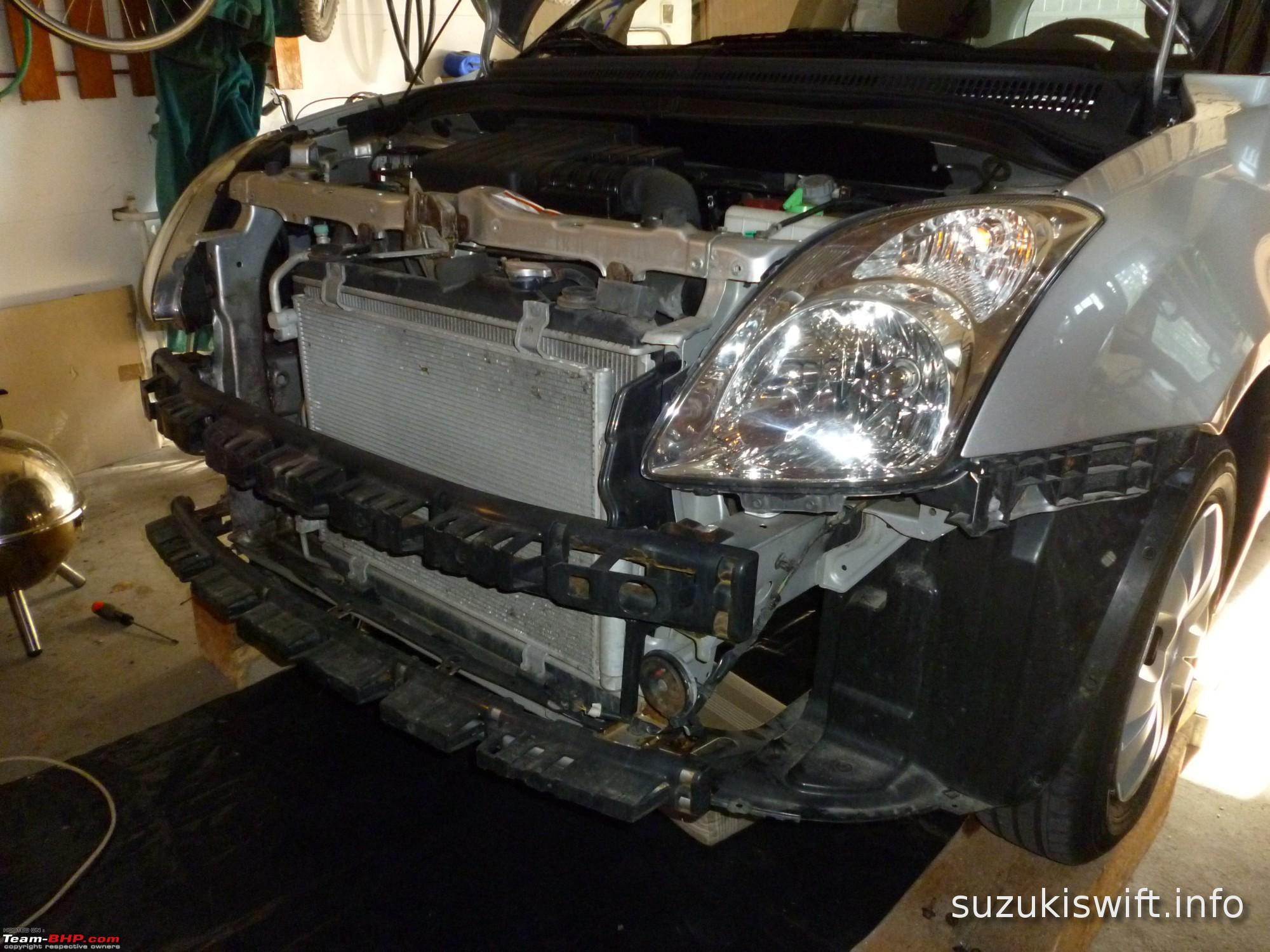

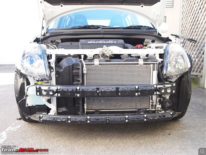

Took some time to dig out this post by BHPian Sankar from a couple of months ago explaining at least one area where Maruti skipped the energy absorbing foam from the front bumper in the name of cost cutting.
This is clearly going to have an impact on the crash test results, since the lack of energy absorbing material would mean the Indian Swift is practically getting a much higher force into the engine bay and cabin owing to the lack of dampening materials. I hope Maruti would start putting similar components back into their models.
Slightly OT, would this be something that can be retro-fitted into an existing Swift?
Indian Swift:
European Swift:
