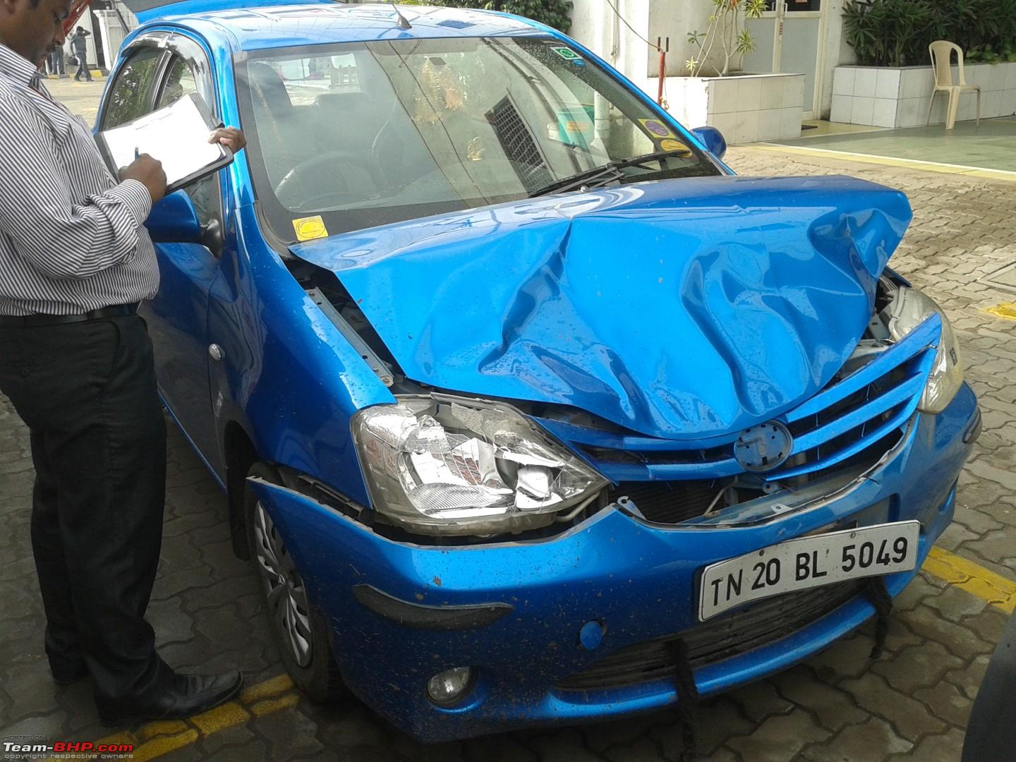

T.L.Rau from Chennai drops the following email:
Unfortunately met with an huge accident . A cow crossed the road which made me lose control of the vehicle and hit the cow. The cow lifted 6 to 8 feet from the ground level and fell down on the road...and rolled for about 50 mt. You can imagine the impact of the accident. By God’s grace, there was no major injury to me, but I have few neck and body pains. The vehicle got completely damaged from the front side.

Originally Posted by GTO (Post 3607049)
Didn't hit the area where the sensors are located? Shows that Airbags aren't a perfect science.
Was the deployment necessary? It does seem to have hit where the sensors are located. Whether it did or not, I am wondering why the airbags didnt deploy. Is it one of those faulty airbags? Overall, I guess the animal cushioned the impact. RIP Cow! You left the owner with quite some damage!

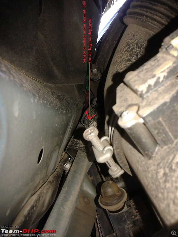

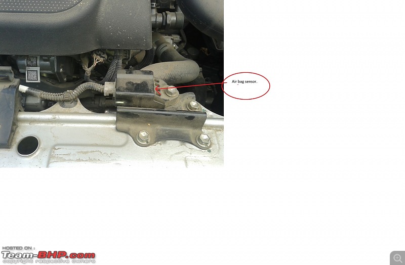

T.L.Rau shares the following update:
I would like to confirm that I have checked the Airbag sensor; it is not behind the front bumper...it is in the middle / center of bonnet locking mechanism, exactly where the Bonnet gets locked, the sensor is behind it. So in my case, the collision is at front only exactly on the sensor, please find attached picture for reference.
I think the impact was quite enough to deploy the sensor as it was direct impact in middle.

Could it be that the car was equipped with the faulty Takata airbags that have been the case of massive recalls by a host of car makers. In this case Toyota India needs to investigate throughly and recall the cars if required.
Safe to assume he was wearing the seat-belt? I hope the service center technicians wouldn’t say that the car did not collide properly with the cow and thus the airbags did not deploy!
This is the second case of the Etios wherein the airbags didn't deploy. I hope this isn’t a case of a bad sensor?
Defective airbags I feel. They should have deployed with or without wearing seatbelts. Guess he should demand a proper answer from someone more technically sound than the people at the dealership.
