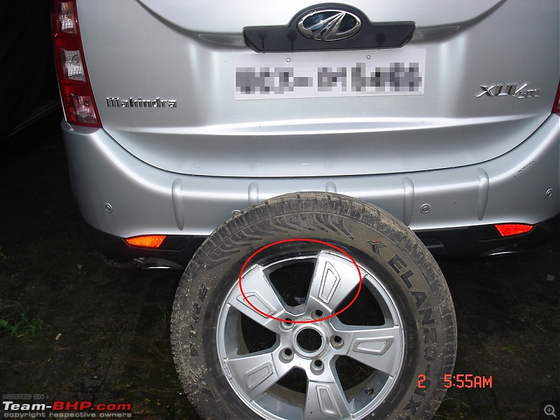

On the XUV500 niggles thread, I had shared a pic of an XUV accident with a broken alloy. Some bystanders had claimed that the alloy broke and caused the accident.
Here's the link:
http://www.team-bhp.com/forum/techni...ml#post3652297
Yesterday, a owner Rakesh from Chennai reported a very similar incident with the same design alloys from Mahindra.
In his own words:
My XUV is just two and half months old and I've driven only 7200 kms. The alloy broke when the vehicle was running..I didn't hit anywhere...no accident nothing.. what should I do now?
Yes. I've filed a complaint already. What will be the guarantee for other 3 alloys? Today I was in the speed of 30km/hr when this happened. What if I was driving around 80 km/h?
Here are the 4 pics he shared:
XUV500 safety issue: Weak alloy wheels. EDIT: Mahindra starts silent recall!-broken-alloy-4.jpg
XUV500 safety issue: Weak alloy wheels. EDIT: Mahindra starts silent recall!-broken-alloy-1.jpg
XUV500 safety issue: Weak alloy wheels. EDIT: Mahindra starts silent recall!-broken-alloy-2.jpg
XUV500 safety issue: Weak alloy wheels. EDIT: Mahindra starts silent recall!-broken-alloy-3.jpg
Source: Facebook
This being the second incident with the same design alloys breaking in the exact same fashion, I have started to doubt the sturdiness of these particular alloys. People who have these particular alloys from M&M, please be careful.
See the broken alloy in the pic? The post says that some onlookers mentioned that the alloy broke off while the car was in motion and that caused the accident.

The alloy wheel design might not be strong enough to hold the weight/stress on the centre. That's a pretty big folly.

This is weird. I hit a pothole at speed on NH1, the tire burst, the alloy bent too, but no breakage at all. Looks like a quality issue.. or rather quality Feature.
Are these alloys cracking in or around coastal areas?
If so, this could be a case of Stress Corrosion cracking, as some aluminum alloys can be affected by Chloride. Coastal areas have high chloride concentration.
Different alloy concentrations are susceptible to different levels. The manufacturer used may not have factored in the "chemistry". But then, today, many companies ignore glaring mechanical defects, expecting them to understand chemical science is a bit too optimistic.
If this is indeed the case, this also shows, how every little thing matters in vehicle design. The manufacturer may have altered the alloy constituent ratios ever so slightly, without knowing. It could also have been accidental due to source material concentrations varying due to machine aging.
But the first thing to know is, are all these cases "coastal"?
It's indeed a very risky affair for the xuv owners who have these alloys. This accident didn't occur in a major way as the owner was travelling at 30km/hr. But what if he was travelling at a higher speed on a highway?
I remember seeing a post in which an XUV's alloy broke while being driven on the highway. The car toppled few times if I'm not wrong. But luckily, the occupants came out alive. Mahindra should try to rectify the problem or else it could be dangerous for occupants travelling in an xuv with these kind of alloys as well as for others who are on the road.

GTO, the alloy in the pic you shared is not the same alloy mentioned in first two cases, which should make us worry even more.
The first two cases mentioned by SDP has the M&M alloy as part of the accessory. This is for W6 & W4 models where owners would like to swap their steel rims.
The image shared by GTO has the factory fitted alloys which comes on W8 and W8 AWD models.
So in short all types of alloys has this potential risk

Quite possibly bad metallurgy (quality of casting). M&M should insist the OEM (or a good third party) to do the fatigue tests of this wheel from a batch of these cars that were sold. If it fails at their premises, they should recall the vehicles and replace these wheels, no questions asked.
Since failures were reported from multiple owners, it cannot be that the car went over a pothole at high speeds causing the spokes to crack.

I always thought if over -tightening of wheel nuts on these brittle alloy designs could have any adverse effect ?
