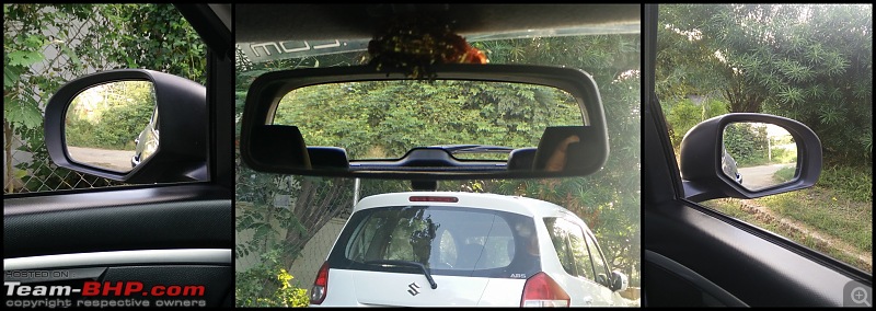

This is how the IRVM and ORVM adjusted in my Swift. I have kept some margin and view of the rear end for the ORVM's.
Eliminating Blind Spots - How to correctly adjust the mirrors-img_20150923_073027horz.jpg
