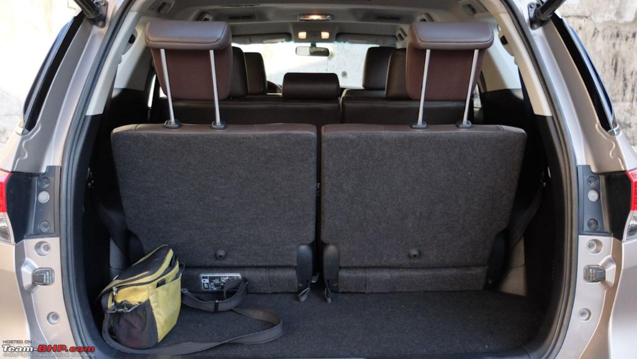

In pre-covid times our family used to travel together in our Fortuner be it along with my grandparents or family friends rather than take 2 cars, naturally I would sit the 3rd row of seats due to good space and letting the elderly take the 2nd row. The ability to recline the backrest even in the 3rd row giving crucial few centimeters of additional headroom is where the problem lies! Once the seat is fully reclined and headrest is all the way up, the headrest touches the glass of the boot-lid. While sitting there I have sometimes thought what if someone comes and bangs into the rear, especially when trucks and buses are often trailing us.
Although the boot is sufficiently large with all rows up, the contact point in case of the crash will be my headrest and eventually my head when the seat is fully reclined!
Concerned about the safety of 3rd-row passengers in SUVs & MPVs-screenshot-20210202-215717.png
Previous generation Fortuner of mine. (pic taken from the net)
Concerned about the safety of 3rd-row passengers in SUVs & MPVs-screenshot-20210202-220916.png
Latest Fortuner, the last row fully reclined and headrests all the way up is the same like the previous-gen Fortuner. (pic taken from the net)

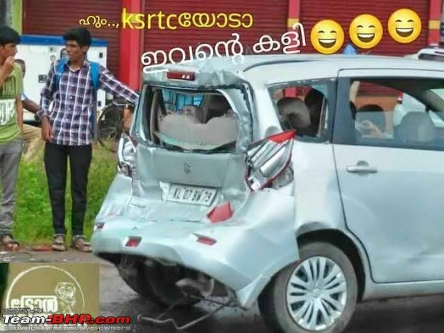

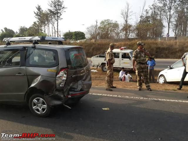

Also attaching pictures of 7 seaters that got rear ended. (Source: Accidents in India thread)
Concerned about the safety of 3rd-row passengers in SUVs & MPVs-2a954606859549bcabca1e027d09355e.jpeg
Concerned about the safety of 3rd-row passengers in SUVs & MPVs-c4b6b716632d4901a348c108524ce415.jpeg
