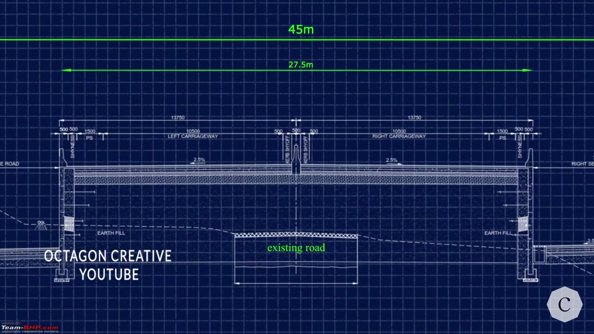

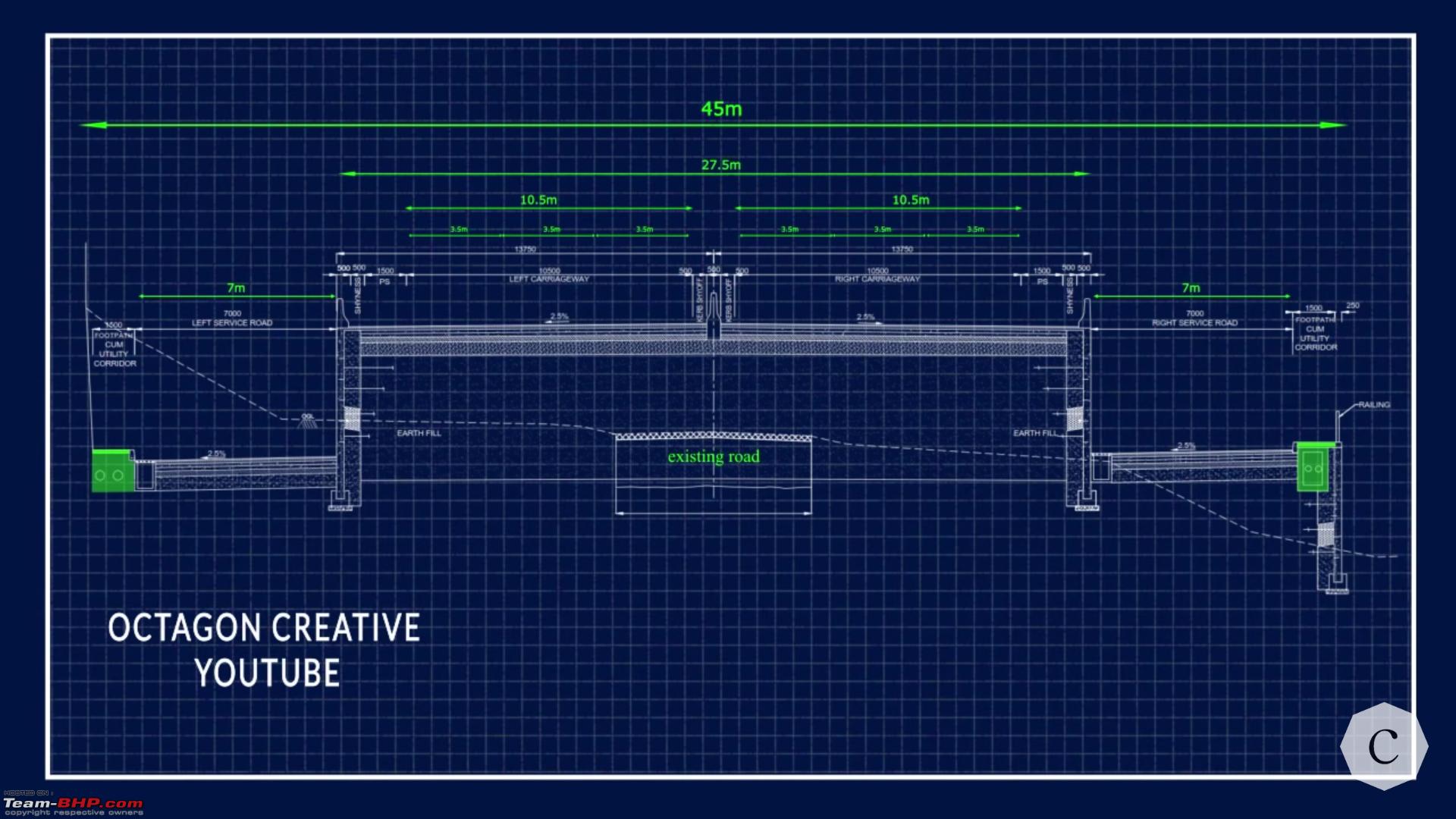

Originally Posted by AMG Power (Post 5886272)
It was indicated that the project will be a mix of 4 lane and 6 lane within Kerala given the land constraints. A lot of the portions upto Kuttipuram would be 4 lane as can be seen from the width of the completed portions. I dont know how they will merge 4 lane and 6 lanes as it can be hazardous if not done properly.
As per the Detailed Project Report [DPRs] its 45m Six Lane Highway, with service road from Talapady to Kazhakottam, only the Ernakulam bypass Edapally-Aroor will be 4 lanes in-between
Screenshot of the same

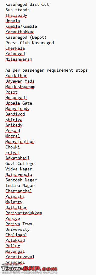

This is another issue that can only be solved by protesting, I was brainstorming some ideas like Mini-buses like the Mahindra Tourister or the Tata Cityride to ply on service roads while the Fast Passengers, Malabars would be stopping only at the bus stands in the reach, although its not perfecting out somehow, like how to make this integratedly smooth such that people will continue to take the bus, at the same time we also have private buses that do both at the same time
I made this chart for the district Kasaragod highway reaches which is nearer to my native place, the stops are based on passenger requirements and the bus stands near it
Name:  Bus stops2.png

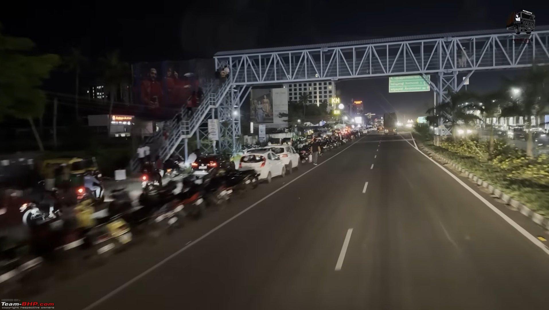

I'm imagining those people who will purchase cars for the only purpose of parking it on the service road due to the lack of parking,
earlier people said that the service roads are narrow, still glad that its 5.5+1.5m= 7m service road and not more than that otherwise its going to be a free-haven of parking by buying vehicles for unnecessary purposes and parking it on the road causing other problems
this example is from TVM near Lulu Mall
At the same time I wish just like the highway project has smoothened out, if the same happens to K-Rail with the silverline project such that there's a fast rail travel between the districts NH-66 passes through so that the congestion is relieved and things are stabilized well in the state
Otheriwse things would go :Frustrati
Attachment 2692234
Lulu is in a city, isn't it? So it's more of a Lulu problem that they don't have enough parking space I guess.
I was talking about people who lives in their homes in non-city areas where there is plenty of parking space. Nobody is going to park their vehicles on road overnight like in many cities people do.

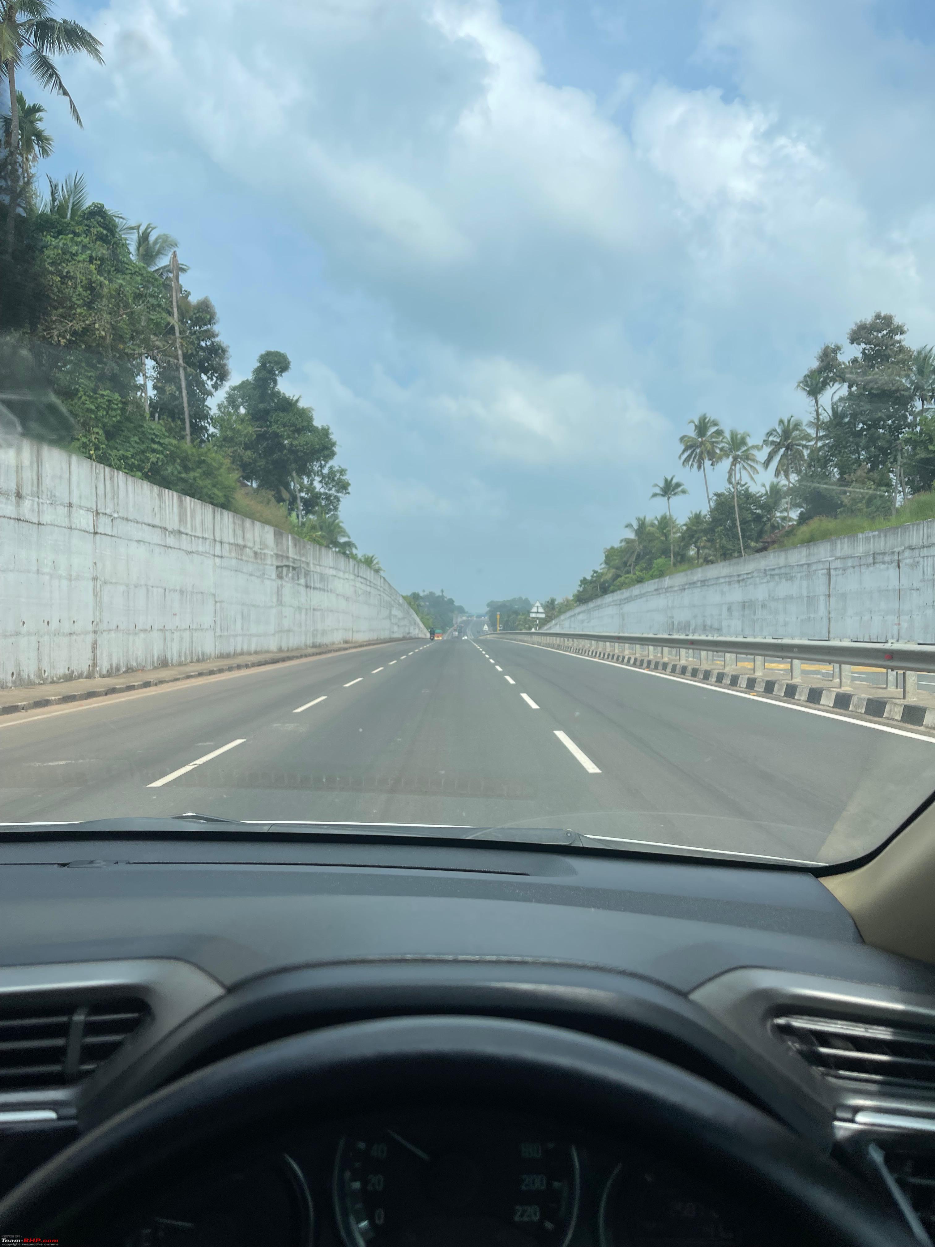

Attaching some photos of the road conditions (only the construction completed areas.)
On the Kozhikode (Calicut) - Koottuli stretch, part of the Kozhikode Bypass
NH 66 in Kerala | Status and Updates on 6-Lane Conversion-whatsapp-image-20241204-12.12.55_c323ea57.jpg
Mahe Bypass. There is a toll booth (Thiruvangad Toll Plaza) on this stretch of the road. The Fastag deduction was INR 75.
NH 66 in Kerala | Status and Updates on 6-Lane Conversion-whatsapp-image-20241204-12.12.55_4a3c884b.jpg
One can easily take a quick detour through Mahe, visit the Mahe Chruch; fill petrol (Around INR 90/ L for regular, Rs. 96 or 98 / L for XP95) from Mahe town, and come back to the highway. It adds about 15-20 minutes to the journey. The route to come back to the highway does not reach Thalaserry, but joins just before the toll gate, at the traffic stop signal. The roads are a bit narrow and though two cars can pass in either direction, a car and a bus will be a tight squeeze.
This is around the Manjeshwar area.
NH 66 in Kerala | Status and Updates on 6-Lane Conversion-whatsapp-image-20241204-12.12.55_2552b048edit.jpg
