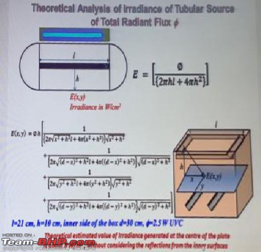

Originally Posted by phamilyman (Post 4822851)
Guruji - this is very useful. How do I translate my 2.2W UVC lamp to J/m2?
You need the followings:
1. Mathematical model
2. Simulations
3. Traceable and certified sensors
4. Study of system for each point in space
5. Spectrophotometers
Please have a look at the mathematical model of my device
Food sanitization in the Covid era : Off the shelf, DIY & Cupboard approaches-coronacleaner_model.jpg
