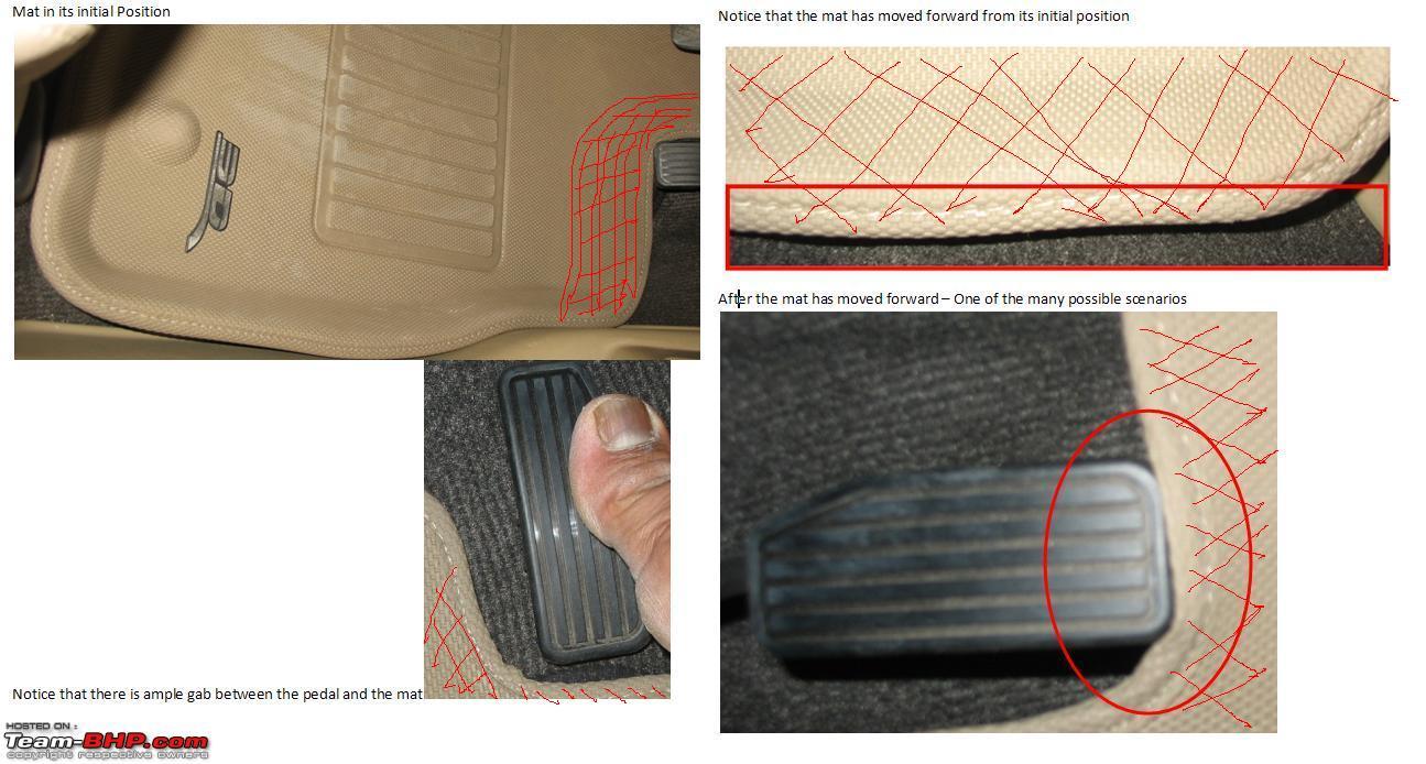

Anjan/HC and friends,
Please find the simulated pics below for your reference. I tried to be as close to the incident as possible.
Let me know your comments and suggestions:
Thanks Kiran for the pictures.
I believe if the manufacturer of the 3D Mats could redesign the driver side mat and remake the hatched portion that is dangerous, replacing it with softer material.
Alternatives like:
(1) Preferably a very soft material should be used, replacing the hatched portion and stitched with the main mat (driver's side only).This soft material will be incapable of using undue influence :) on the gas pedal.
OR
(2) The driver's side mat can have at least two strong Velcro fixtures to fasten the mat with the driver's seat frame.These Velcro fixtures can be placed on the aft side of the 3 D mat and affixed with the metal frame of the seat below the cushion.
Attachment 819377
Alternatives like:
OR
agree: Anjan_c. However, due to the frequency of such rare incidents happening, I doubt whether they would consider our suggestions.
