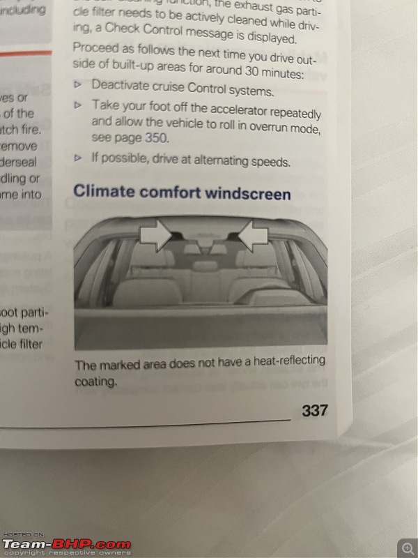

I am almost certain it's because of the type of the glass used that blocks IR/heat. You can check with BMW folks to suggest the correct spot to fix the tag.
Attachment 2451805
Access to this area is not possible from inside as there are sensors behind the rear view mirror that are fixed on to the windshield area marked. My fastag sticker is right below it.
Sahil is offline
This is not the 7 series windshield, just some BMW model I found on the internet but I am very certain you will find the designated spot next to the interior rear view mirror (not below the mirror but to the left or right). You can spot this area by shining your phone torchlight from inside - you will see some subtle change of pattern in the see through glass. Best to check the user manual or ask the service staff. Most cars in this segment have windshields with special coating that blocks radio transmission and they keep small clear sections on the windshield suitable for placing the tag. Tag will not work if pasted anywhere else. Here is a discussion on this topic:
Finally found it in the car manual. But the area marked has black dots on it. Hope the fastag sensors can scan through them?

Re: FASTag: All you need to know about procuring & using it!

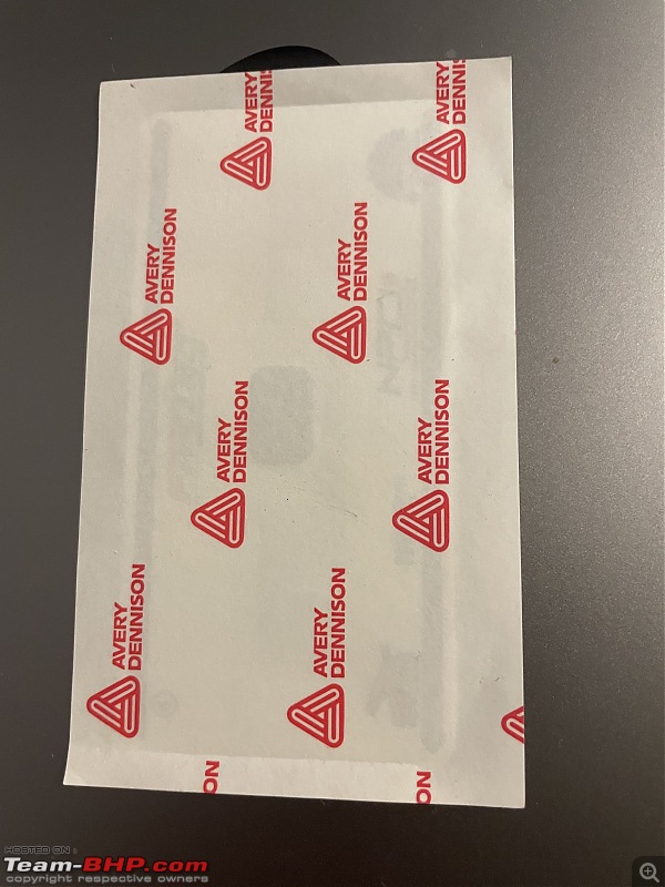

It should work. Just to be sure, use the tag without sticking it for the first time, just hold the tag in that spot next to the rear view mirror when you pass through the toll. The tag works even if it has the adhesive sticky paper on it. You can stick it in the spot after verifying that it works. I have a Polo that I rarely take it out of the city - I just keep this tag in the glovebox and hold it up while passing through the toll. Works without any issues.

That's interesting!
So, when I get my new windscreen, I can put my tag on the black-dotted part of it. I had put the existing one just below it, thinking some sort of visual process was involved. But I guess... it is not visual at all.
That's interesting!
My problem got resolved. Stuck it in the place mentioned and it's working smoothly at all automated fast tag lanes.
