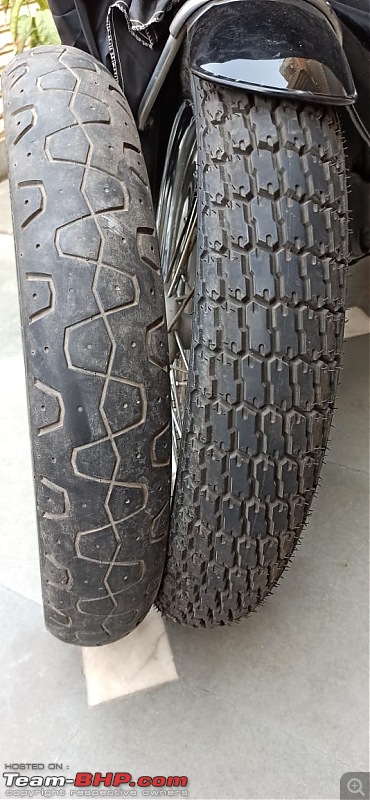

The tires were 4 yrs old from manufacturing date and the hard compounded stock Pirelli phantom had started developing cracks on side wall & around treads. So that was a thing to be taken care of soon. And with perpetual worry of puncture anywhere, the outex treatment couldn’t be further ignored, so it was time to get tires changed along with outex done as well. I couldn’t stretch my luck any further.

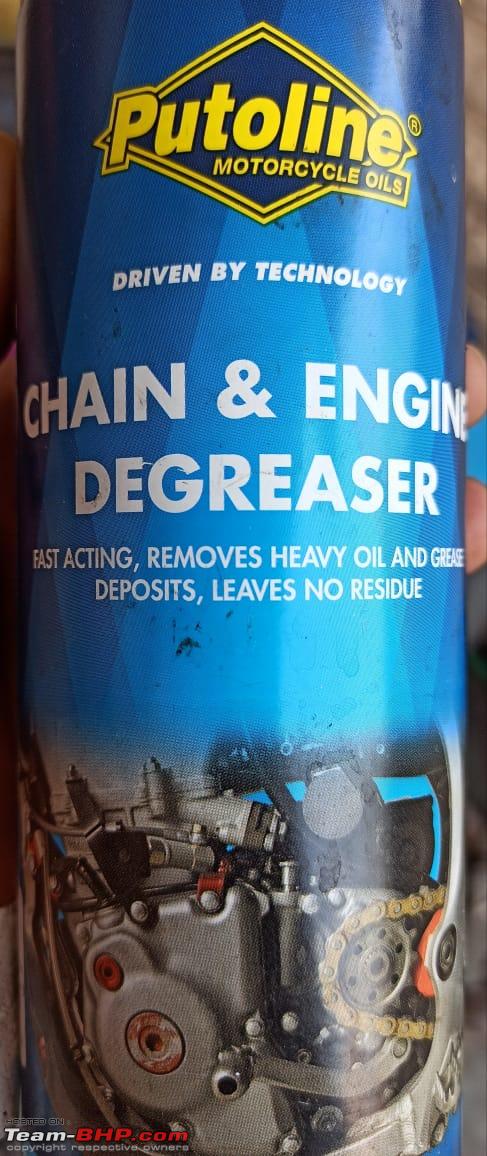

After checking the chain and sprockets it was clear that front sprocket had more bad teeth than rear and the chain was more elastic at certain links. For all of 15k kms I’d been using chain cleaners/lube like motuls, kerosene, engine oil and that wasn’t a great idea as per the mechanic. I’ve now started using putoline drytec (costs similar to motul) and the chain isn’t sticky or such.
Also, having noted the recommendation of chain manufacturer I now have some liters of kerosene to be used for removing grease on utensils

The tyre story – Due to lockdown and certain import restrictions, procuring Metz tourance or Scorpion tires of same size and recent manufacturing was becoming tedious. Since the bike was already at the workshop I had to arrange the tires soon. My search lead me to the brand I knew but never read about in detail -Timsun. The workshop had a pair of Timsun 697 but the front was 110 instead of stock 100, the rear was 150. The pair was coming around 13k and with no luck finding other brand I went ahead with Timsun thinking if there’s any major complaint after few months, loss of 13k won’t drown me in sorrow.
Impressions: The stock Pirelli phantom are horrible. if I were allowed using expletives here I would. Why in the world would Triumph use such tires is beyond my understanding. People who use scorpion trail or metz have similar opinion for phantoms. The Timsuns feel way better in my ~800km ride so far. Few notable awesome differences over stock phantom: The U turns have become a breeze despite the longish wheelbase, the road noise has reduced significantly, the dreaded handle buzz/vibrations have disappeared at high speed and the maneuverability in traffic is easier. Overall, very pleased.

Clean & Lube

Front Tyre of 110 vs stock 100:

Well, 1500 kms since the change I'm very satisfied with Timsun. Specifically to your points, timsun (this rubber 697 model) far exceeds the phantoms in all departments. These just feel better, way better.
1. Tires grip on wet and dry surface is far better. Even cornering is lot more confidence inspiring. Since these are bit off road focused also, i have no issue wandering onto 'kuccha' roads where the ride now is pliant and comfortable over stones, pot holes etc.
2. Weight of the handle bar feels significantly less. The bike is more maneuverable, for example the U turns even tighter ones are easy to do now, shorter turning curve and filtering traffic is easier.
3. The dreaded handle bar shaking is gone, handle bar buzz is significantly reduced
Overall, this 697 model which is both on & some pff road oriented suits my need for our roads where there's mix of good & bad in every trip.
Timsun was an nervous accidental purchase as that time there were no Metzelers and Pirelli Scorpions at shops due to import restrictions but I'm very satisfied now with its performance (at the almost half the price point of Metz/Pirelli). I wouldn't know if Metz tourance/Scorpion trail are better over timsuns but for likes of Bonnie any of these are way better than phantoms. I would even say this to folks with new Bonnies to just let go of stock phantoms but then how would we appreciate better rubber without experiencing phantoms
