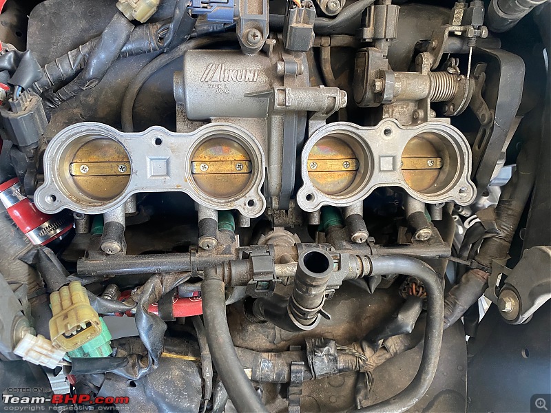

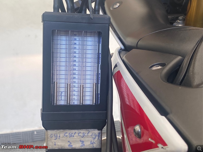

Anyways, once we got that cracked loose we hooked the sync reference machine to the TB and loosely reassembled back the TB and fuel lines to start the TB sync test.
And sure enough, the proof is in the pudding, cylinders 1 and 4 were slightly off from the acceptable tolerances, cylinder 2 was alright while cylinder 3 is the reference pin so that is not to be messed with.
Before
Review: My Yamaha R1 (WGP 50th Anniversary Edition)-16.jpeg
Review: My Yamaha R1 (WGP 50th Anniversary Edition)-17.jpeg
After
Review: My Yamaha R1 (WGP 50th Anniversary Edition)-18.jpeg
Took us maybe 10 mins to calibrate all the TB banks to be within the acceptable limit and the major job was done and dusted.

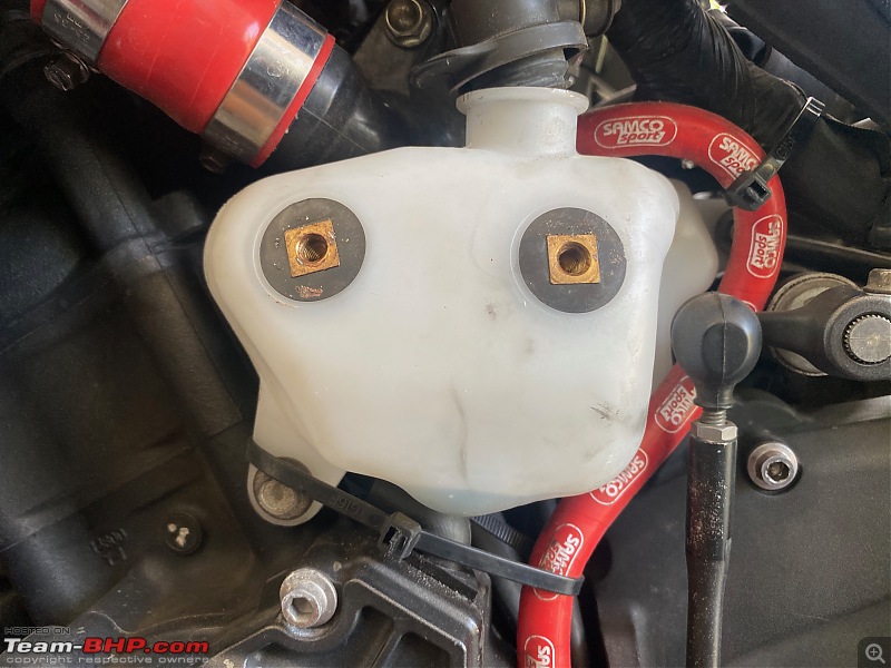

Since that was done we moved our attention to the coolant reservoir we noticed that the expansion tank was almost empty, which was weird as I had just topped up the can in Jan post my Bangalore-Kerala ride, upon removing the reservoir outer cover I noticed that the top rubber seal that covers the reservoir was half popped out (my bad) and I'm guessing it might have dried out when the bike was running at operating temp, but we did a thorough check for coolant leaks all around and we had no coolant mix issues either(engine oil even at 6k km had the reddish tint of the Motul 7100) so we just filled up the expansion tank again and made sure the rubber seal is seated correctly. It's good that we make it a habit to look over things like this because things like this can happen.

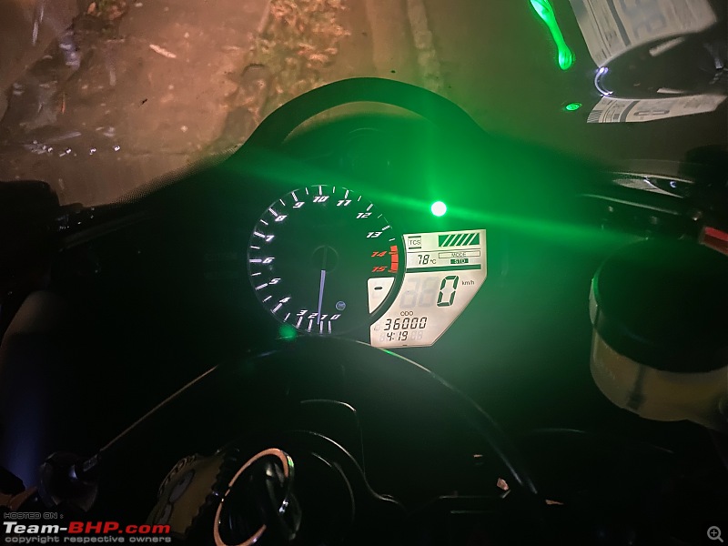

We had an early morning start to the ride back home and almost instantly the R1 hit 36k km on the ODO.
Review: My Yamaha R1 (WGP 50th Anniversary Edition)-31.jpeg
