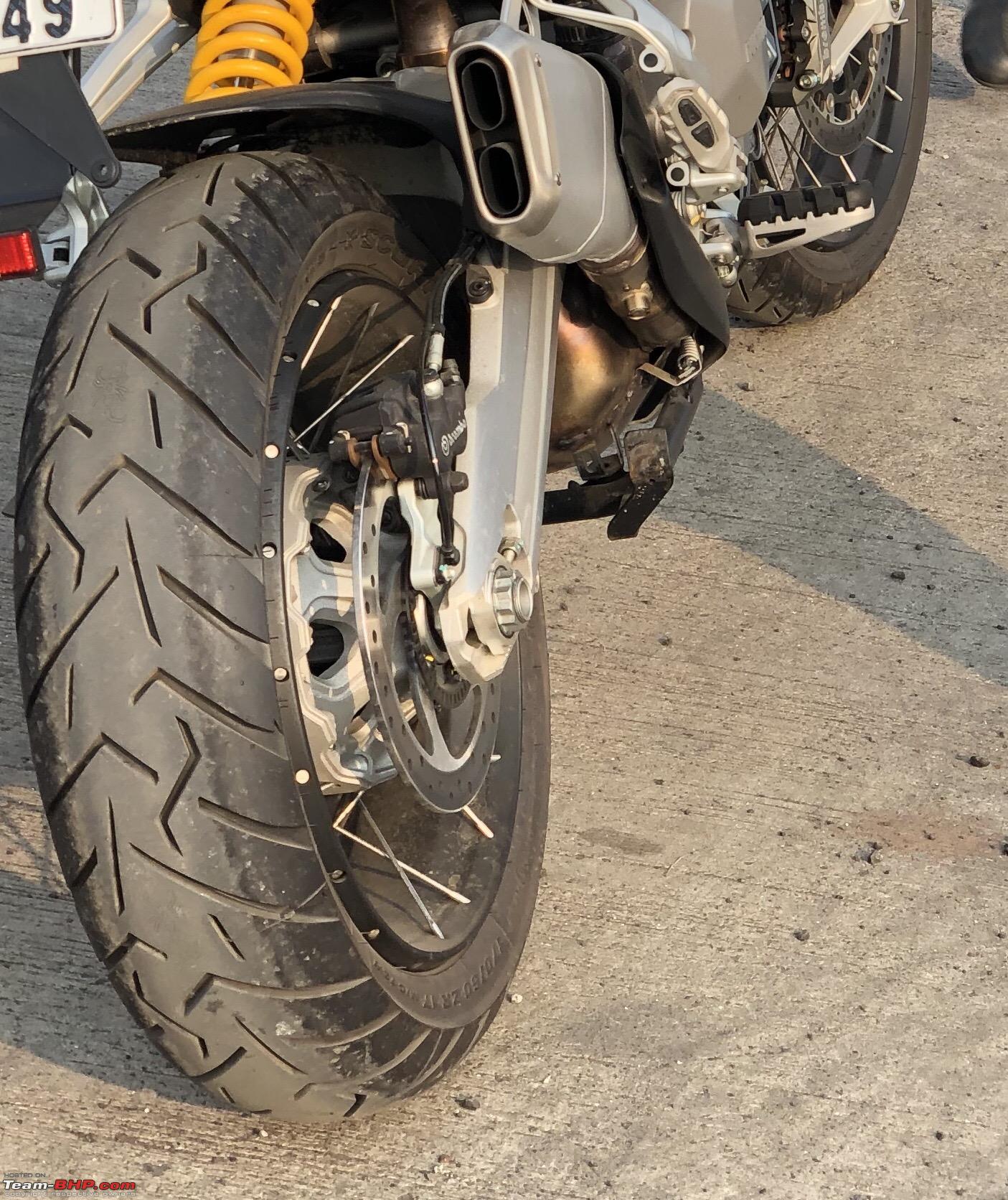

Originally Posted by Jaggu View Post
It was BMW trademark, now comes in Triumph Tiger as well as Africa Twin 2020.
And also the Ducati Multistrada 1200 Enduro..
BMW Motorrad India's incompetence & horrible after-sales service-fa65880586fa4ca2820d23cfb4b0c0af.jpeg
My first thoughts on seeing my friends Enduro was what if a spoke broke, can it be fixed or the whole wheel needs to be replaced. Now I know the answer
Attachment 2075971
Ducatis and Hondas have had zero complaints on spoked rims. Triumph is their newest adopter, we'll see how things pan out but I am sure they won't be as bad.
Have they ironed out the problem of loose spokes with new wheel rims, or, is it something you'll still need to check from time to time?
It is a part of service campaigns.

Alloys vs Spokes on ADVs
On a slightly related technical note, I had imagined whenever the time to upgrade my alloy shod Tiger 800 XRX comes, I would actively consider a bike like the 900 Rally / Rally Pro (which sports tubeless spoke wheels) or similar GS etc.
Any reason I should consider myself better off sticking with ADVs that are equipped with alloys? Regardless of the brand? Is this spokes issue something that is / likely to plague all spoke wheeled offerings or is it something that BMW in particular is getting wrong more than others.
Thank you.
Alloys all the way:
1. Cheaper to replace (within and outside of insurance)
2. Shops exist in India to fix cast wheels. Not tubeless spokes. Refer op.
3. Cast wheel bends, you can insert a tube and go ahead.
4. Offroad cast wheels are made better and stronger than street cast wheels
5. Traditional spoke wheels are the best, cheapest and most effective option. How ever, practice removing and fixing tube punctures at home.
6. Lyndon poskitt, dakar Rallyist who rides around the world to his rallies, uses traditional spoke wheels because they can be fixed anywhere anytime by anyone. This is the most important consideration on adv bikes. By far.
Me? Cast wheels where available for soft enduro and adv riding. Traditional spoke wheels for harder enduro like on Xpulse.
Thank you.
Spokes if you are considering offroading. Alloys if you wish to stick to tarmac. BMWs are prone to larger problems on spoked wheels v/s others who have adopted them.
