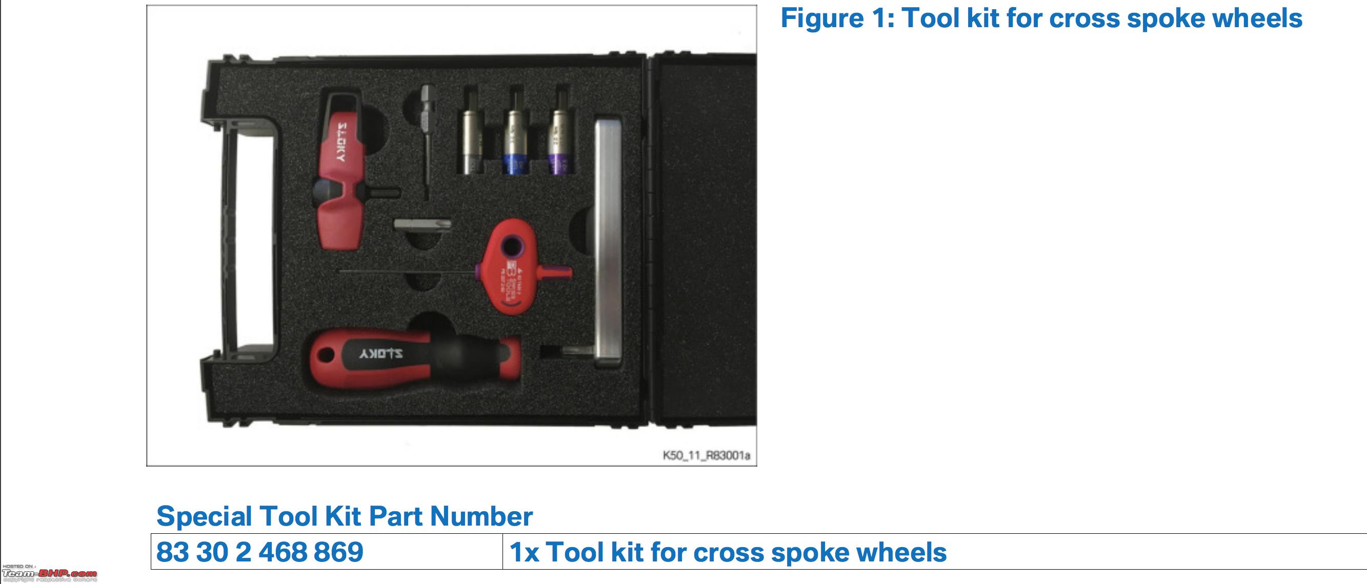

Telling customers that they are experts and than using Bicycle Equipment is nothing but arrogance. Yes, their electronic & other diagnostics is on sophisticated computers but mechanically, they are no better than an untrained road side workshops. Rather, their are some better people who can do things much better, just because of their experience.

Update 06Nov'20:
The front rim has been swapped out for a brand new replacement. I had to shell out Rs. 9,177/- for the wheel. Rest was covered by BMW.
I haven't had a chance to ride the bike. I'll do that on Sunday. The old rim did seem a total bum.
The rear spokes were simply tightened. Please accept my apologies, we found only Six loose and not Eight like I had stated earlier. The workshop has asked me to use the bike for sometime and check if any of them come loose.

So now, what happens if the rear spokes get loose or break in the future rides?
Do you need to keep checking? Has Bmw Motorrad advised anything in this regard?

Interesting question! I had asked them and their take was "they'll let me know". Now I don't necessarily know what that means. Their communications are haphazard as you must have seen before.
In interest of my own safety, I will have to be utterly careful in this regard. Because they need to use a special tool to set the spokes accurately. But, what they use are conventional alternates. A genuine spoke setting tool kit looks like this. I didn't see it being used for setting them on my bike. Additionally, I saw loctite being used on the grub screw and the inner set screw which is against the norm.

EDIT: I just wanted to post an official manual from the BMW USA that recommends replacement of wheels when spokes come loose:

My case is that they come loose every few 1000km
