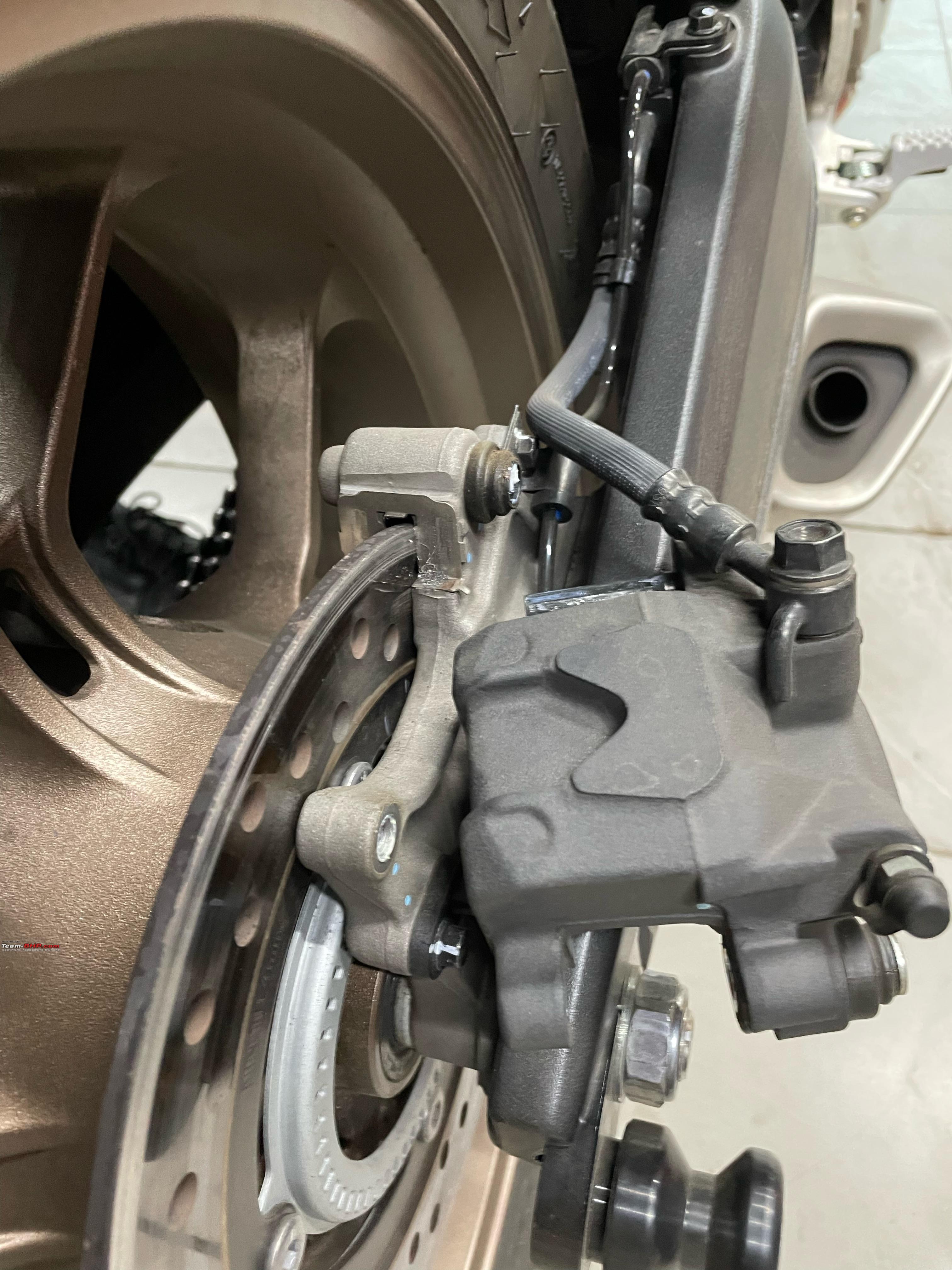

A strange noise was coming from the bike on the 14th of Jan'23. I took the bike at the service center on the 15th to get the issue checked. After the technician inspected and removed the rear brake pad, it was observed that the disc was rubbing against the brake arm and was bent (images attached for reference). Since the service center manager was on leave, I went to the service center on 16th Jan again to speak to the manager about the issue. Mr Frank informed me that he checked the bike and there was no visible impact on the bike for the rear disc to bend that way. A report was submitted to the technical team to get the issue resolved under warranty. The technical team rejected the HTR claim and I was informed by the manager that he would get the replacement done under goodwill warranty. It's been 17 days since the bike is at the service center and they are awaiting internal approval.
The bike has just done 1152 kms on the odometer and I am wondering if a root cause analysis would be done to identify what caused the rear disc to bend in such a way.
I received a call from the service center manager stating that the technical team has rejected the claim however from the dealer side we have decided to give you a 50% discount on the parts and labor charges. I am wondering why should I even pay 50% with no fault of mine.

I got the bike fixed yesterday, had to pay 50% for the spares (Rs 1750) and labor charges were waved off by the dealer. I am scared that this doesn't happen again.

Brake discs warp primarily due to two factors, excessive heat coupled with constantly grazed rear brake pedal (unknowingly) which would superheat the rotor and given the wrong circumstances can warp.. Fast forward 4 months into your ownership, now that you're facing this issue, it can perhaps be your riding style, where you were unknowingly resting your foot on the rear brake versus the foot peg which eventually might have overheated the rotor and hence a warp, technically.
Now, aanother reason could be a combination of heat plus misalignment of your rear wheel during a service. When the rear wheel is misaligned the rotor for a rough idea, turns from this [ normal " | " ] to warped this [ " / " or " \ "]. With power being sent to rear wheels already stressing the rear wheel, all these factors coupled with bad foot position, heat and misalignment can and will warp a rotor and cause glazing on the rotor and "angled one side" pad wear which is a prime indicator that a rotor has warped.
Usually a front warped rotor manifests itself as mild yaw on the bars which usually can be diagnosed faster. With the rear wheel, it's comparatively difficult to diagnose unless the issue has calcified enough to let itself know.
The reason you were rejected warranty is, as per my understading, brake comps, rotors, chain sprocket, tires usually aren't covered under warranty. These parts are deemed "wear and tear" parts and covering them under warranty is a tough nut to crack, unless there's an inherent manufacturing defect reported in the initial days of ownership.

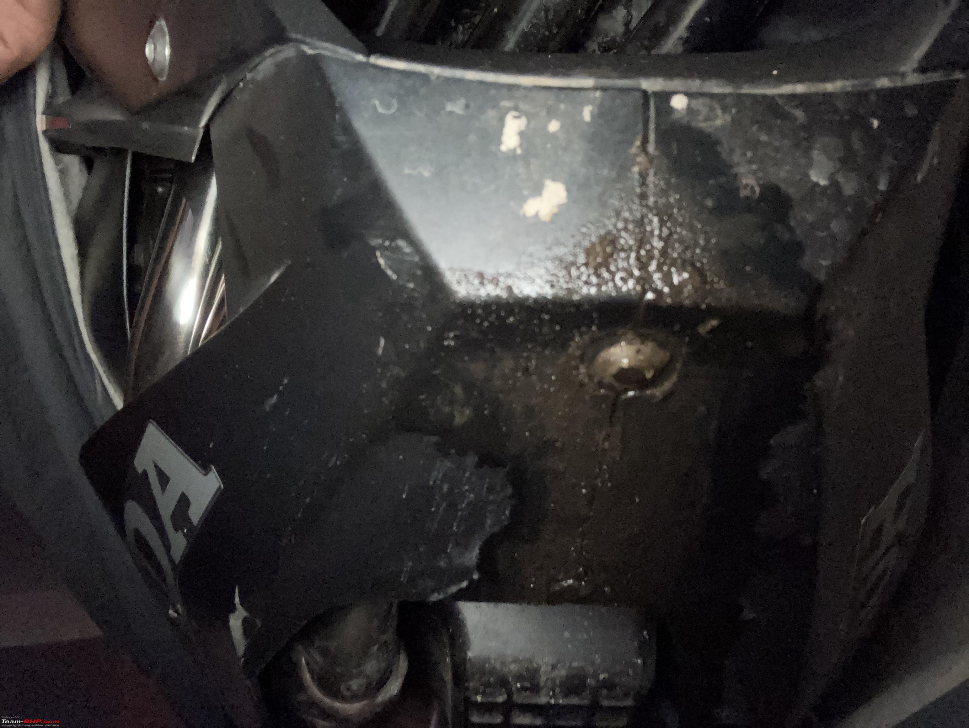

Went for the first service
Honda CB 650R warped rear brake disc problem | 1152 km & < 3 months but Honda is rejecting warranty-5f6d5ac28fc341d18546815acc6fddde.jpeg
Came back in the noon and parked. Saw leaked oil in the evening
Honda CB 650R warped rear brake disc problem | 1152 km & < 3 months but Honda is rejecting warranty-679bc26a3b2b475b8f1c8ba5b663dd3b.jpeg
Honda CB 650R warped rear brake disc problem | 1152 km & < 3 months but Honda is rejecting warranty-da61e2e79b944ceda495e2b44096a939.jpeg
Went back to the service center very next day. It is around 27kms from my home
Honda CB 650R warped rear brake disc problem | 1152 km & < 3 months but Honda is rejecting warranty-d69b9ea8e59b4026b509d1aad0e3f675.jpeg
Initially I thought the guy who did the post service test ride must have hit some speed breaker or might be oil filter was not properly installed.
After panels were removed at the service center, I noticed the oil spill pattern inside fairing indicating oil was spilled while draining the oil on the previous day. Could not find any leakage in the oil filter or any crack on the engine. The panels are attached so tight together, spilled oil took more than 5 hours to leak and drop on my parking floor.

Originally Posted by PA_86 View Post
Just wanted to know if there could be a possibility of misalignment at that time, would it take 400 odd kms for the disc brake to start rubbing against the brake arm?
The rotor would not touch the brake arm even after running forever. Could it be that the rotor was installed inside out when you got the spools installed at 700kms? When you get the new rotors, take a look at what is inside and what is outside. From the worn out part it should be clear if it was installed incorrectly after the 700 mile service.
Someone I know had hit a pothole at speed on a brand new CBR, and caused the rotor to rub against the brake pads. But, it would be hard to rub against the arm 360 degrees uniformly like yours.
I lost 1 night sleep and faith in Honda. Now I stand in front of motorcycle while it is being serviced.
I have done my own servicing on my Hondas for decades. I have always tightened the oil filter by hand, I have never seen a drop of oil on the garage floor. I have faux wooden flooring, any drop would be clearly visible. If things are done right, such things would never happen. Often the service center guys over tighten, and strip the thread causing leaks, and bigger issues. I would use an oil pan, drain the oil, and check to see how much oil has been lost, check if the threads of the drain bolt is intact, and check if the filter has been installed correctly. this is shoddy work by labor that is short on skill.
