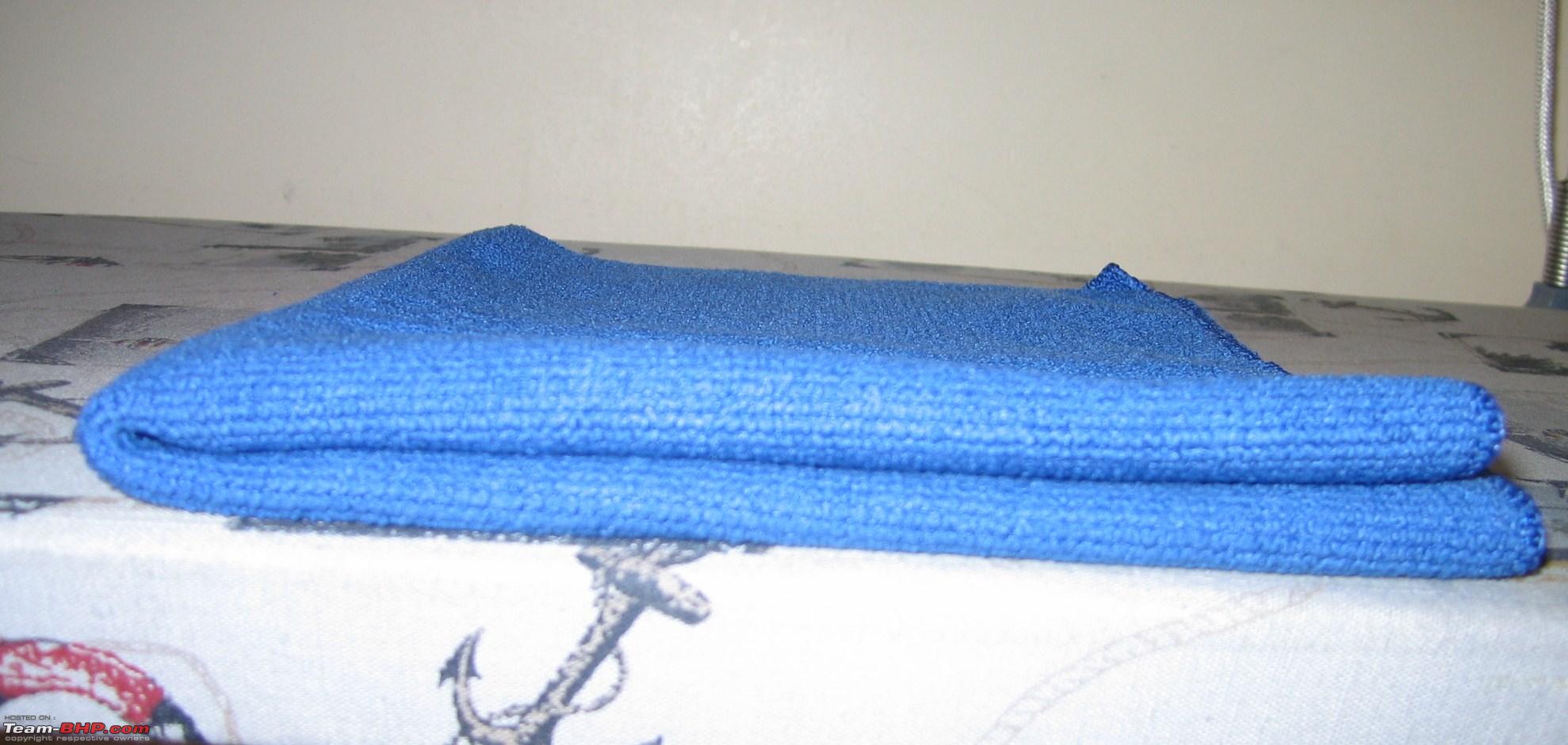

Microfibers
hi folks
some pics of microfibers i got- cms like i am totally into microfibers- learning and exploring more.
The first pic is the set of cloths i got now
starting from the top left, orange is viking(from US),yellow is the 3m sold here, white is from MORE- some US brand, the blue at bottom left is from MORE- they are sold as a set of 4(2 blue and 2 white),the blue with 3M logo is the professional series from 3M which is vvv hard to get as not sold outside at all, and the last one is Meguiars.The next 2 pics are close ups of the brand sold in MORE. The blue is good to use completely wet and wipe a minor dirty car, if the car is waxed, the cleaning is fast and quick. Fingerprints, dirt marks etc are easiily wiped away. The white is useful for the same purpose but has a different texture- softer infact. Both are not good to use dry.
The viking is great to use for buffing, and if minor damp its great to wipe the car.
One thing i have found is that a good quality microfiber is BEST when its a little damp Ex: If you use a detailer like meguiars and wipe with a section of the cloth, the same damp section can be used all over the car and the cloth runs very smoothly indeed.
The same is the case if you put your hand in water and wipe with it to make it little damp. A dry cloth is mostly used just to lift dust- the best amongst those is the 3M yellow one. The 3M Blue is the most versatile, can do any job well. Meguiars are the best to detail and buff..
I got a friend who sent me Norton Cloth- a brand of Saint Gobain, from the US. Each cloth is about Rs 220.00 and its made in Korea. I used it- its quite good, not as good as 3M for sure, but really nice to do jobs like removing wax, wiping windows. Its micro fibers are not as plush,but have a tougher feel. Its better suited to clear off wax,drying and wipe than detailing jobs. I have some extra, PM me if you would like one( the last 4 PICS ARE OF THIS CLOTH). Its really useful for tough use and has a strong build quality- korean micro fibers are supposed to be the best infact.

So which is the best of the lot?
How do the MORE ones compare to Viking and Meguiars?
