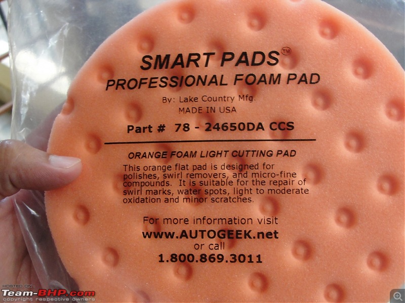

Sohail - The new place looks nice, lots of room to move around ! I Liked the nice lawn, serves dual purposes - to relax after detailing & also useful to take reflection shots
Awesome results with the before & after Can you please share with which make of foam pads did you use ?
Btw, finally my consignment from Autogeek was delivered yesterday !
I got the following :
1. Flex 3401 DA kit with the Megs twins (105&205) 2 Cobra MF's.
2. Lake country CCS pads - got a mix of Orange, black, white, blue & red ones. (Thanks to Garipagol for the inputs !)
3. Megs 36 mm masking tape
4. Megs water magnet drying towel
First impressions :
- Flex DA, all that i heard about it being built like a tank are misleading.
It IS a Tank !!! Typical solid German build, built to last.
- Useful packing by Autogeek of the pads, each one comes with an individual plastic cover, mentioning the usage directions too. Informative booklet from Lake country explaining a bit about the pads was included too.
- Cobra Mf's are nice & thick, look like they're quite durable.
Next Plan of action :
- Have to figure out a way to get extension wiring done to work in the apartment basement. Will need to take a connection from my house on the ground floor.
Garipagol - please do share some inputs about the grade of wiring you used for your Flex & also any other points i need to keep in mind ?
- Am thinking now which car do i first work on ?!
