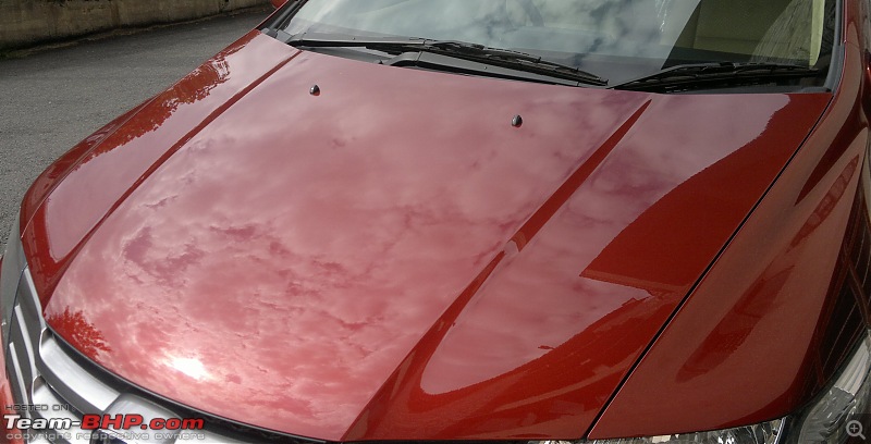

Reflection shots of the Bonnet- see the clouds !

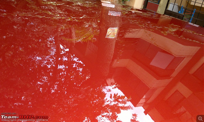

Reflection shot of the roof

I am not the best at taking pics, but hope these give some idea to folks who maybe attempting their hand at a DA. To the normal eye- NO difference can be made out post the DA on my car, but looking closer- one can see the surface is much better. I will capture more after a while, once a few layers of the sealant are set and in full glory.
Attachment 442945
Attachment 442946
Close up of the panel which showed up swirls in the last post, swirls are GONE!!
Attachment 442953
