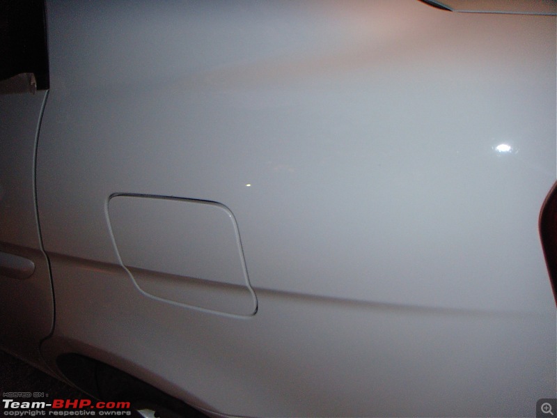

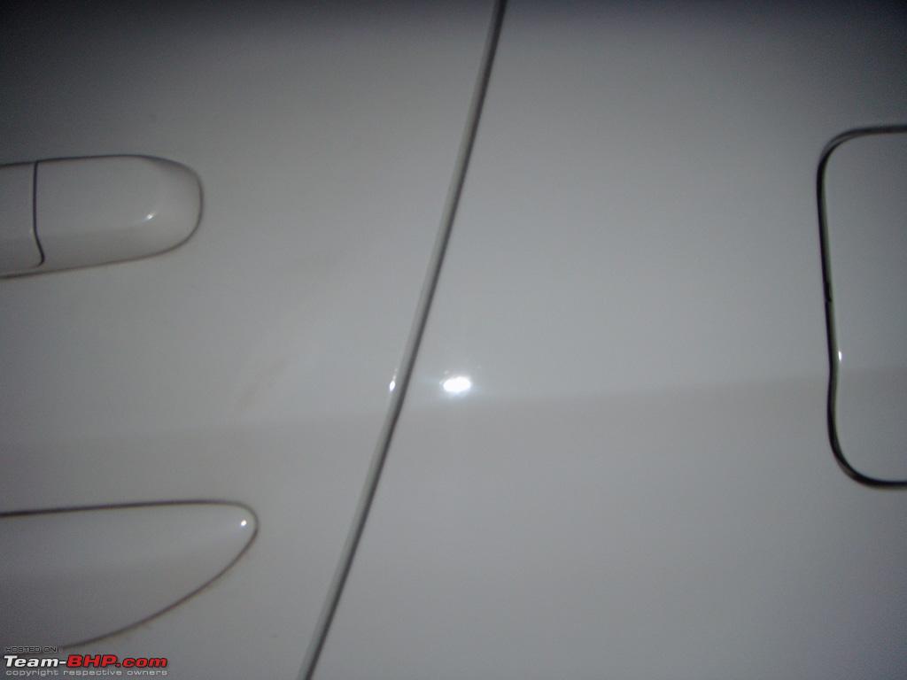

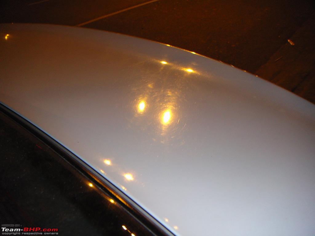

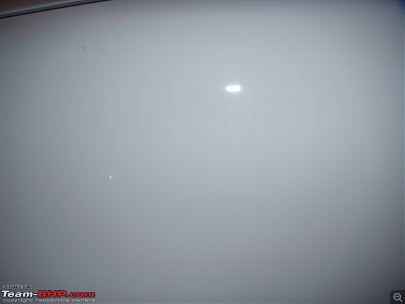

Some Pics stolen From notorious computer , he is doing up his verna
Last pic shows the condition of whole car when the detailing is started

@ NOS007: Good results ! But i guess the third picture shows a lot grit in and around the beadings and door handles which have not been addressed yet. M sure thats done by now cheers

^^ its a 50:50 shot , rear quater panel is done where as door hasnt been touched yet !
