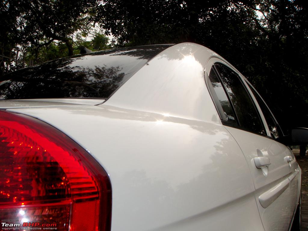

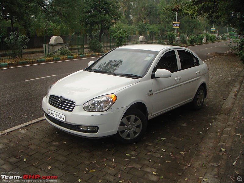

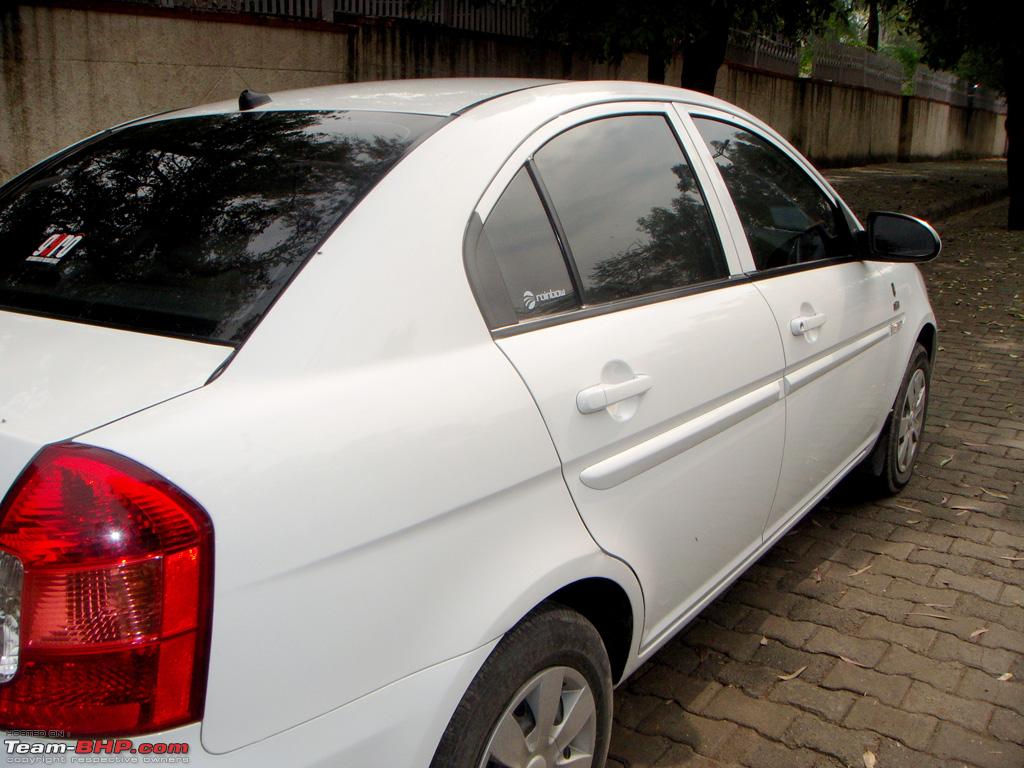

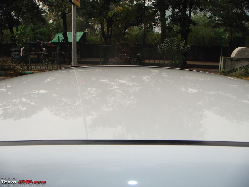

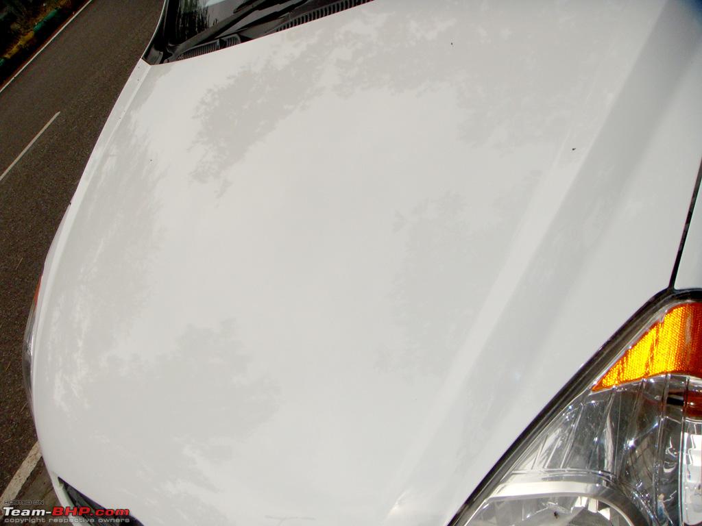

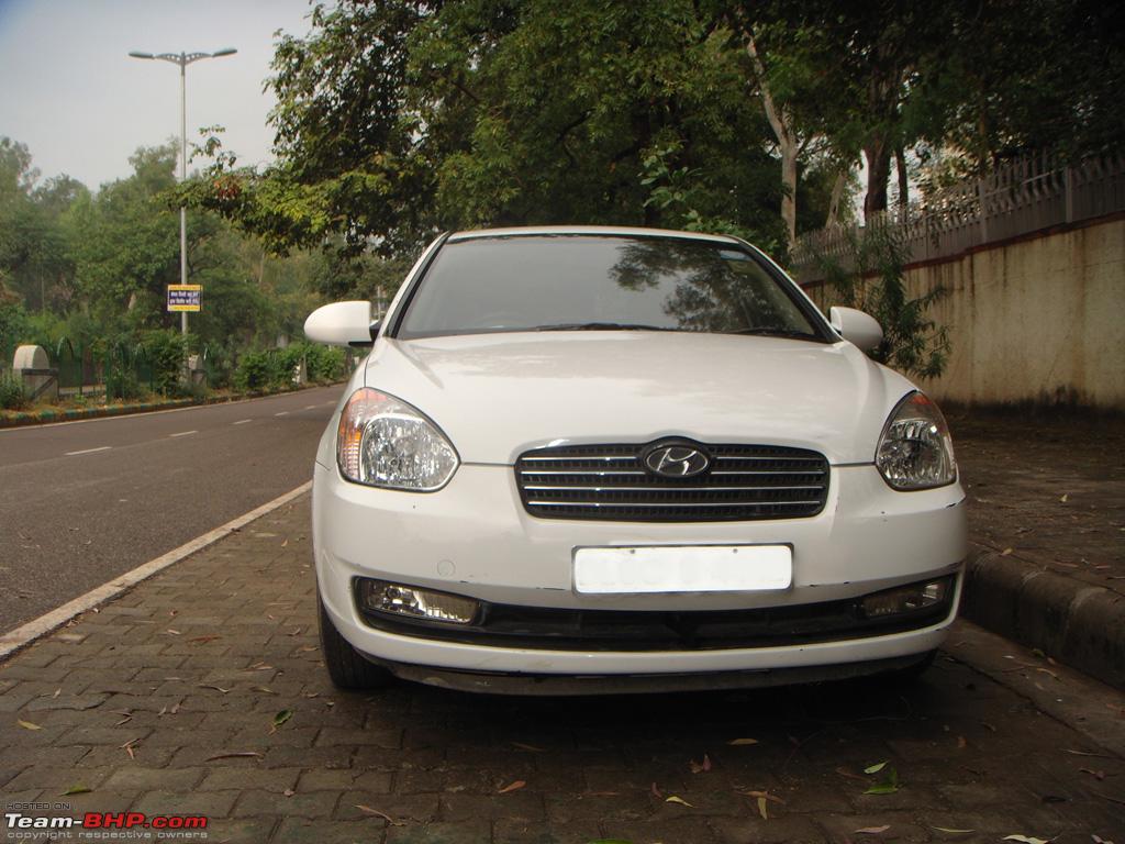

A warm Hello To all Guru's !!!
Here are Some Pics Of Notorious Verna which has recently finished the paint correction. all smork work like interior cleaning and dressing is still pending.
it Takes a lot of time and patience but the outcome is great . Hope you will like them !!!
