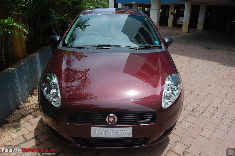

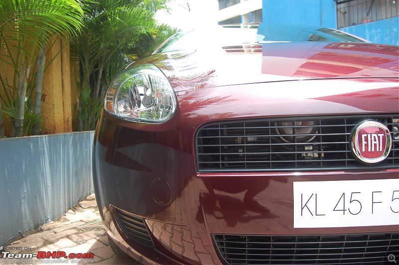

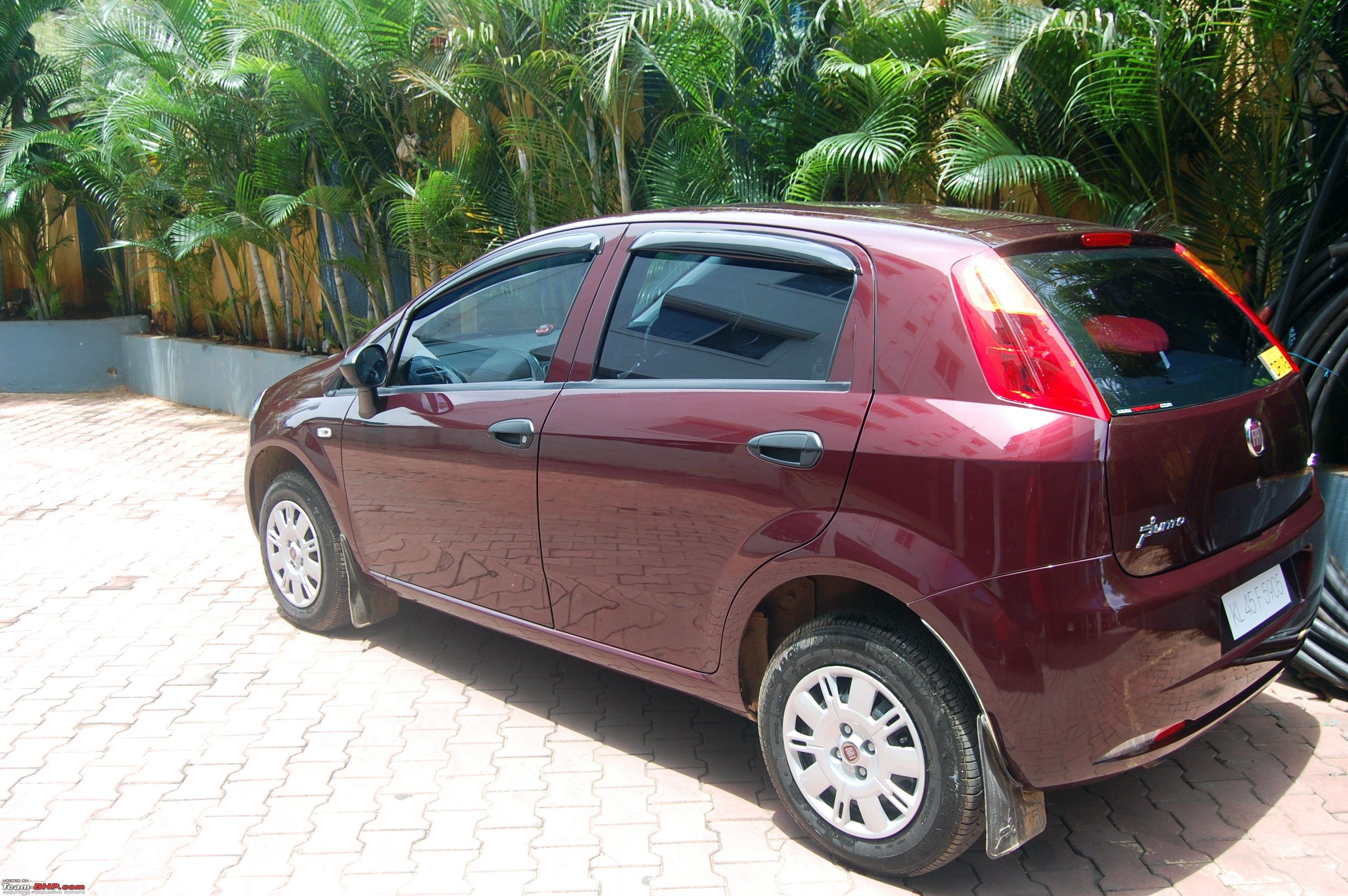

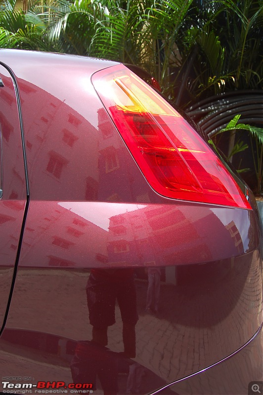

My first car detailing session
Finally THE DAY arrived.
I got up a bit late this morning..so, was not sure whether to do it or not. Finally, shrugged of the laziness and took the plunge.
The arsenal -
1> Amway car shampoo
2> Amway leather and vinyl cleaner.
3> Clay bar - Meguiar's . For Clay lube - Amway shampoo diluted in water in 1:10 ratio in a spray bottle.
4> Colinite 845 wax
2> Accessroies - 1 Micro for wash, 1 Chamois and 1 Micro for drying, 1 Micro for claying, 1 Micro for interior cleaning,1 Foam pad for applying wax, 1 Meguiars SuperShine Micro for buffing wax
Started with car wash, then did the interiors, followed by claying and finnaly the wax. I did not have a tire product, so could not get the tires to shine.Everything went on fine and the entire effort took almost 3.5 hours. But, it was well worth it - my car is shinning like new and the surface of the car feels so silky smooth.
Few notes -
  • The Amway leather and vinyl cleaner worked very well and the interiors look all black and new plus it had a nice smell.
  • I applied the clay with lots of lube (used up the entire 500 ml lube). There were lots of minute black spots stuck on to the car surface which did not go away with any shamppo wash. Clay removed 90% of those and made the surface really smooth. After claying the paint, I applied clay on the glass and the headlight and voila they became so much more clear (thanks to Sanjay from Bringingbest.com for the suggestion. Took a short spin in the evening ...man, I don't remember seeing my windscreen so clear ever!I used half of a 50 gm clay bar and threw it after use as it was pretty dirty.
  • Applying colinite 845 was very very easy. I allowed it to haze for 45 minutes before buffing. Even buffing was lot easier than I had thought.I applied only a single coat and might do another coat after a couple of months.
Overall, a highly satisfying experience.
Thanks to all the BHPians who got me introduced to the concept of car detailing..special mention to mkh, thinkbig, quadro, Avon, ajay_k and many others. Sorry, no pics as it got pretty late..I will try n take some pics tomorrow.But, I could notice in the parking lot that my car was shining more a 3-month old white CIty
A special mention of Sanjay from www.bringingbest.com, New Delhi, India - I got most of the products from Sanjay. Not only his rates are the best in the market, his service is very good and he is always there to help us with any questions or concerns about detailing. One good thing is - he got invidual clay bars which can be purchased separately and there is no need to buy the full clay kit. I would definitely recommend him wholeheartedly to any BHPian looking for purchasing car care products. Disclosure- I am not linked to Sanjay or bringingbest in any which way, this is just a recommendation based on my experience with him.
Aadi
