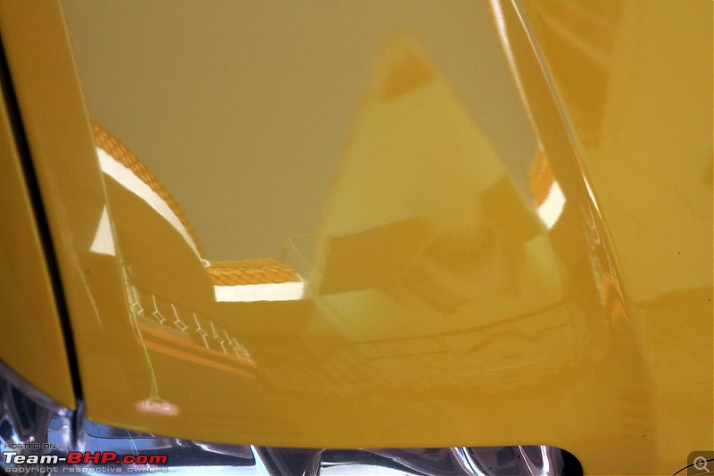

One has to be very very careful while using rubbing compound since it can do lot more damage than good. Below is a finish I've got by only using rubbing compound and nothing else. No scratch remover no polish no wax.

Attachment 898510
WHAT are you kidding me ?
can you post some more pictures of the same ?
that looks as good as a waxed one.
Which rubbing compound did you use and the process ?

I prefer not to disclose the products/techniques I use, however an older iteration when I was still into bikes can be found below. Go thru the entire thread to see what products I've used.
http://www.team-bhp.com/forum/motorb...g-up-bike.html
