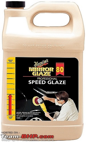

Gurus, I have got 100ml Meguiar's Speed Glaze and 100ml Meguiar's Hitec Yellow wax(got this loose from the can)
Mine being a one month old car, can I apply Speed Glaze Polish which is measured as #4 in the scale of 10 of Meguiars Cutting compound? (see pic, it shows as light cut#4)
After the polish, I am planning to apply yellow carnauba wax all by hand.
Is it alright?

Here is the pictures. The mobile app did not attach the pics in my previous post.
Mods: Sorry for back to back post. It was the android app that did not attach pic.

cut#4 for a 1 month old car is an overkill. I would say wait for 45 days (in rainy season I would say more) till the paint bakes and gases out.
IMO Simple carnauba layer or Insulator Wax (Collinite-845) should be enough for the new car.
Emphasis on the word kill.
Give new paint some time before doing anything to it. Cutting compounds are for restoring old paintwork and correcting faults, not for new paint!
Sometimes I worry that the enthusiasm shown by some people is going to reach bare metal . Oh well, at least they'll have a superb surface for the respray.
How to make a new car look better than new: Get the 3M paint protection done. It feels great to the touch, adds a depth of gloss that is unbelievable, even more wow than factory finish, and it adds a layer of protection. Ordinary care with shampoo and quick detailer will keep it that way. Maybe wax it after a few months.
otherwise, treat new paint like baby's skin!

Gassing out means allowing the paint to cure so that any trapped air or gas can vent out through the tiny pores of clear coat . If we wax then the wax fills up the pores and the gas builds up resulting in causing bubble pops in the clear coat because of the pressure.
Ideally by the time the car leaves the paint booth and reaches the customer , it would have been cured sufficiently. So no need to wait till a month before you wax. You can start waxing right away.

Speed glaze polish is a product in the category of AIO's - All in Ones which function as a paint cleaner, light polish and have some amount of sealant.
Are you applying it by hand or machine ? Both are fine. Yes, it can be topped up with wax, sealant as you desire. Scale refers to the amount of cut, which can be controlled by the user.
Any new car in Indian conditions would need a paint protection treatment out of the dealer. From a Nano to a BMW, all types of damages can happen in one day even. Its quite common to compound the surface in brand new cars the world over to remove defects and bring the paint up to its fullest potential. Even Ferraris are delivered in less than optimal condition !
The high temperatures used in the baking process in between paint coats at the factory helps in the release of paint solvents. Its advisable to wait atleast a month in the case of aftermarket paint jobs to allow solvents to escape before applying any sealants or waxes.

Yea! New cars are pre baked and the clear doesn't need time to gas out!
You can use polishes and waxes on it as any other paint!
As Nirmal said that, in case you have gotten it repainted, you can still sand it(orange peel) down and polish it after maybe a week! (as the paint is still relatively soft so it makes sanding and removal of sanding scratches, easier!)
you just have to make sure you don't wax or seal it before at least 60 to 90 day cure times!
You can use a glaze like speed glaze! It fills in defects and adds 'breathable' protection!
