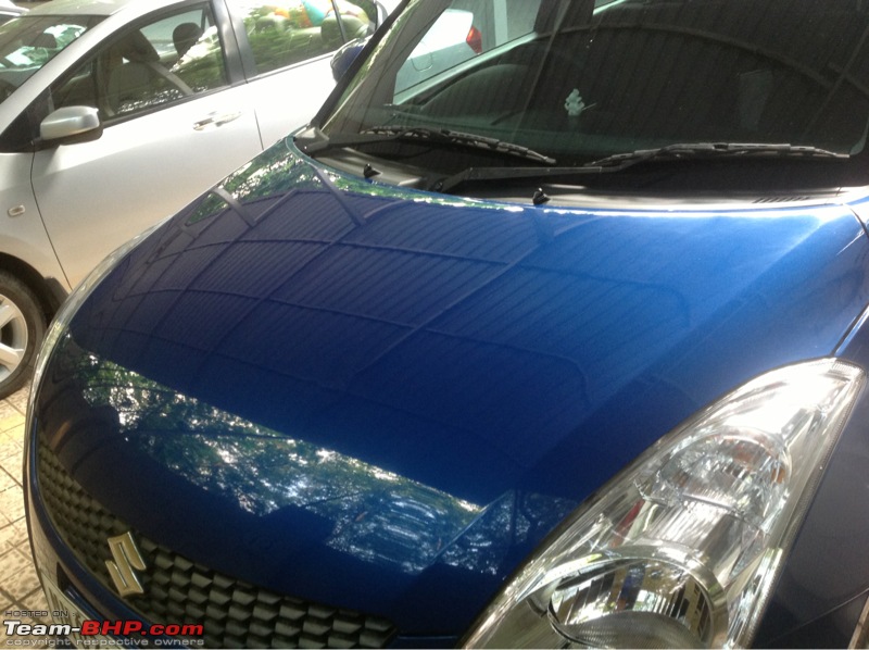

Finally went through my first detailing session today. It's a much more difficult to execute than looks in the instructions.
I did the most basic detailing which included washing with a shampoo and waxing with collinite. Lack of a water hose made things difficult. Even with the two bucket method, by the time I went to drying, most the water would dry off. Took me a rather long 2 hrs just to wash the car. Maybe will get faster with time!
Waxing was relatively better. Applied a coat of collinite and let it set for 30 mins then rubbed it off. Again since it was the first time, I did not apply it as thinly and evenly as I would have liked. However, satisfied with the outcome. I hope the shine get better with every fresh application.
One query, even when buffing after the wax dried off, the mf pad was getting dirty. Is this normal or is it that dust settled on the car during the 30 mins it was setting in?
I also noticed a lot of black spots all over, especially the front bumper and driver side doors. I guess these are tar marks. The shampoo or wax or ONR quick detailed couldn't get rid of them. What can? Clay bar?
Some pics:
Some pics:
Congrats on your first detailing session! Impressive results.
For the tar spots i've found WD-40 works best. You can try it before using a clay bar.
The next time-wash,dry,wax one section at a time and move onto the rest of the car.
Hope it helps
Hope it helps
will try that. one panel at a time. But do you also also suggest waxing one panel before finishing washing the complete car?
Also, is WD-40 safe to use on the paint. I just spray wd40 and wipe off with a mf?
May be you could wax at the end,but definitely wash and dry a panel.
I've used WD 40 on all 3 cars at home,no issues so far. Just spray and wipe off gently with a mf
Great efforts and result looks promising. To maintain the finish just clean the car with Jopasu duster and QD(Quick Detail) with ONR 1:16(ONR:Water) daily. You wouldn't even require to wash the car so regularly, unless its very dirty
Either wax the car once every month and if not once in two months to maintain the finish.
To remove tar spots you need to use clay bar with ONR as clay bar lubricant in 1:64(ONR:Water) ratio. I did be a bit skeptical to using WD-40 constantly as it may cause some harm to paint in long term, IMHO.
In the next detailing session, use clay bar and you did be surprised by the amount of bonded contaminants on the clear coat.
OT: The car parked on the left is a white Honda City and there is a twin parking system i.e. one car above another(hydraulics). How does the car cleaner wash the car parked above daily.
Thats the plan!! Use of ONR daily/alternate days as QD and wax once a month. I am just worried about the mud splashes which will warrant a shampoo/ONR wash more regularly.
I need to get a clay bar for the bonded contaminants. until then, i might use WD40 as a solution to see how effective it is.
I dont think the car cleaners clean those. most of them are quiet dirty. And since we are , these parking systems are alloted to different flats. So every time the guy on the hoist has to take out the car, the other flat owner has to come down Thankfully mine is not a hydraulics one.
